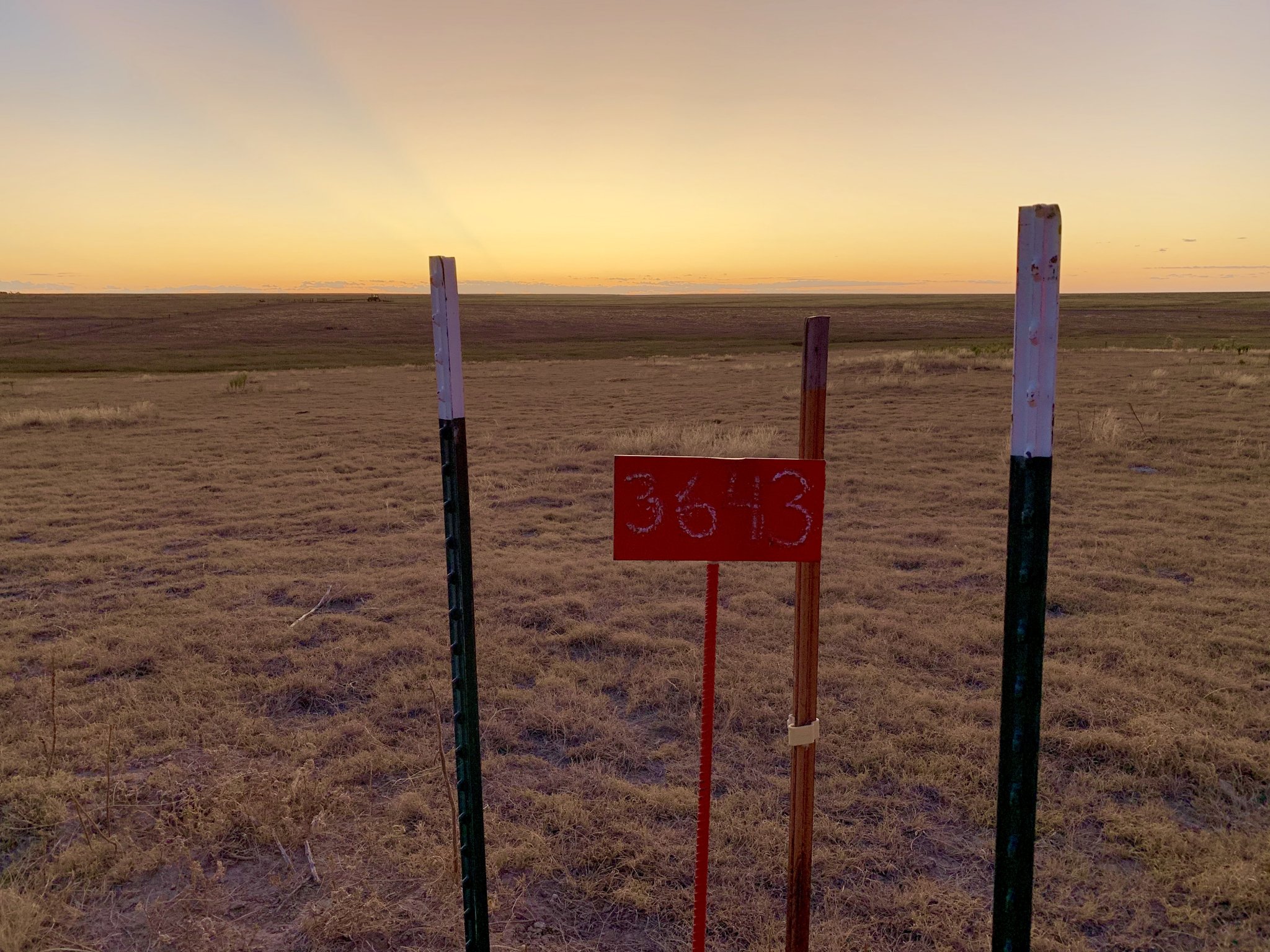

3643 yrds = 3/5 shots once dialed in (11 shots) with standard 375 CT
1 MOA sized target
352 cutting edge
125 grains powder retumbo
funny thing is my buddies all out shot me... I’m just the weekend warrior tag along...

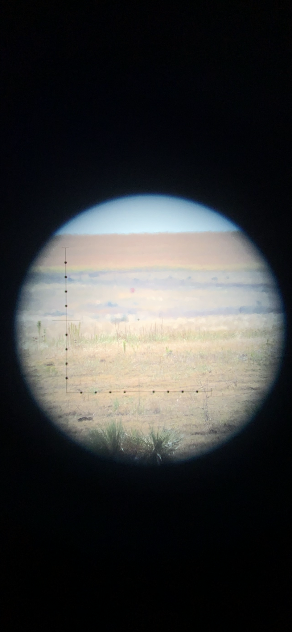

view through spotter 60:(yes that little red dot)

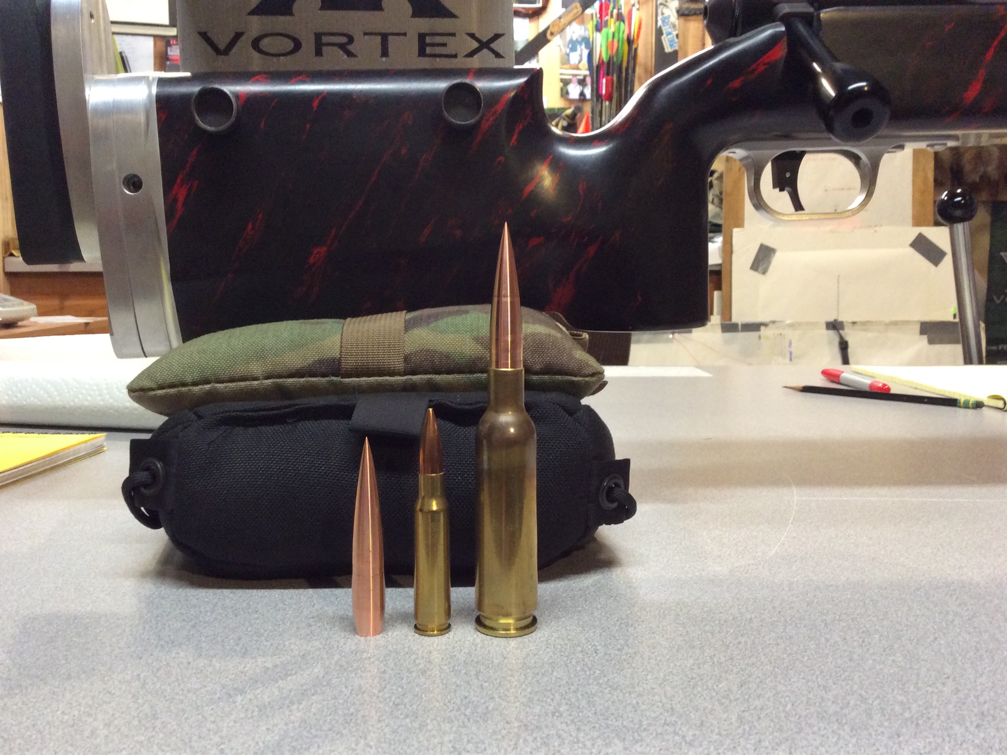

That .416 is nice. A friend of my just bought a ULR extreme in .416 for what he considered a good price. I have to say the ELR looks fun and challenging! @ oneshot.onehit tell me about your rifle build i.e action barrel..

M113A3
The rifle was built and chambered by Warner Tool Co.
Action is a Barnard GP
Barrel is a 39” Bartlein 8 twist
Stock is a Mc Millian Beast
Warner adjustable scope base
Warner MOAB muzzle brake
Vortex Gen II Razor 4.5-27x56 MRAD scope
Rifle weight - 41.8 lbs
20N29 powder
RWS primers
RWS brass
In 2018 and 2019 I used a squeeze bag in the back and a Atlas 5H bi-pod in the front
For 2020 I changed it up with a Edgewood bag in the back and a Phoenix bi-pod up front as shown.
Rifle has been used with good results for
2018, 2019 King of 2 Mile - tuff switching wind at 2019 event
2019 NRA Extreme ELR
2019 Spear Point Finale
Bullets used with “easy on the brass” speed with rifle
2018 - 400 grain 375s running 3360 fps Flat Lines - used with a 375 chambered 35” Bartlein
2019 - 505 grain 416s running 3250 fps Flat Lines
2020 - 550 grain 416s running 3145 fps Flat Lines
I may tweak the load some yet for 2020 but it should float somewhere in that 3145 fps accuracy node.
Pictured is a loaded 260 round for comparison.
Cheers
Oneshot.onehit
