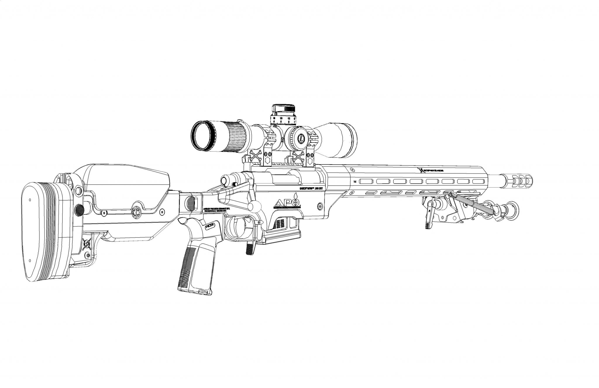

While double your budget, it would be worth looking at this rifle package that Frank put together, it has everything you'd want pretty much right from the get go, including a folding stock which can be great for transport.
Someone posted it, we have ton the work for you, follow the link above for more details, but first:
$1950 for this setup,
After this, I would recommend an AI AT if you truly want a "sniper rifle"
But we spec'd this rifle out to help shooters make a buying decision and not have to upgrade after the fact. You can change our spec for the options listed and more, but we made this package so you can just add a scope and drive on.
These will hit the street the end of February.
https://www.ashburyprecisionordnance.net/snipers-hide
