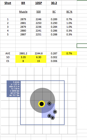

I have been using the shotmarker a fair amount for the last couple of months and comparing MV at barrel with recorded velocity at the target. Unfortunately I have been limited to 547 yards for the shotmarker. At first I was skeptical of the Shotmarker velocities but the more I used it and analyzed the data the more I started to believe the numbers were accurate. I also went into JBM and calculated the BCs based on the 2 velocities at known distances. I did a lot of testing with different brands of bullets as well as pointing vs not pointing on different days and finally concluded that the velocity readings are pretty accurate.
What I found was that as per Berger's NoBSBC, some bullets have more variation in BC than others. When I pointed bullets I only saw a slight increase in BC but I saw much less BC variation. One of my most eye opening experiments was to take a lot of good shooting bullets with low muzzle ES/SD and mangle with meplat with pliers. To my surprise the groups stayed good at 545 yards despite the fact that they were traveling about 100 feet per second slower at the target. My takeaway was that it confirmed that BC not a huge factor at shorter distances. As many have said it is possible to shoot great groups at shorter distances even with poor ES/SDs
Need to get the target out further and do more testing.
This was one set of data with pointed 105 Hybrids. It should say 547 not 500 in 2nd row of velocities

Agree that it is easy to get sucked into the numbers and lose sight of the real goal, getting shots on target. The current craziness left me with some extra time so I played with numbers and spreadsheets for shits and giggles and in the process learned a few things including:
  • I believe the shotmarker numbers are accurate in most instances (if windy and target is moving all bets are off).
  • I need to stop chasing the highest BC bullet for the ranges I usually shoot, accuracy and precision much more important
  • Pointing did not significantly increase my BC but did seem to make BC more consistent
  • BC variation/consistency varies amongst different bullets and will come into play at long distance
