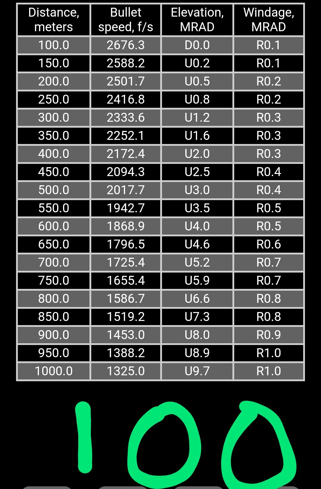

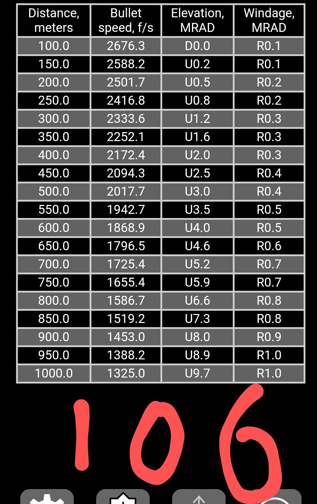

In Meters. Same gun, same everything, different zero range. 94m, 100m, 106m. You decide.
