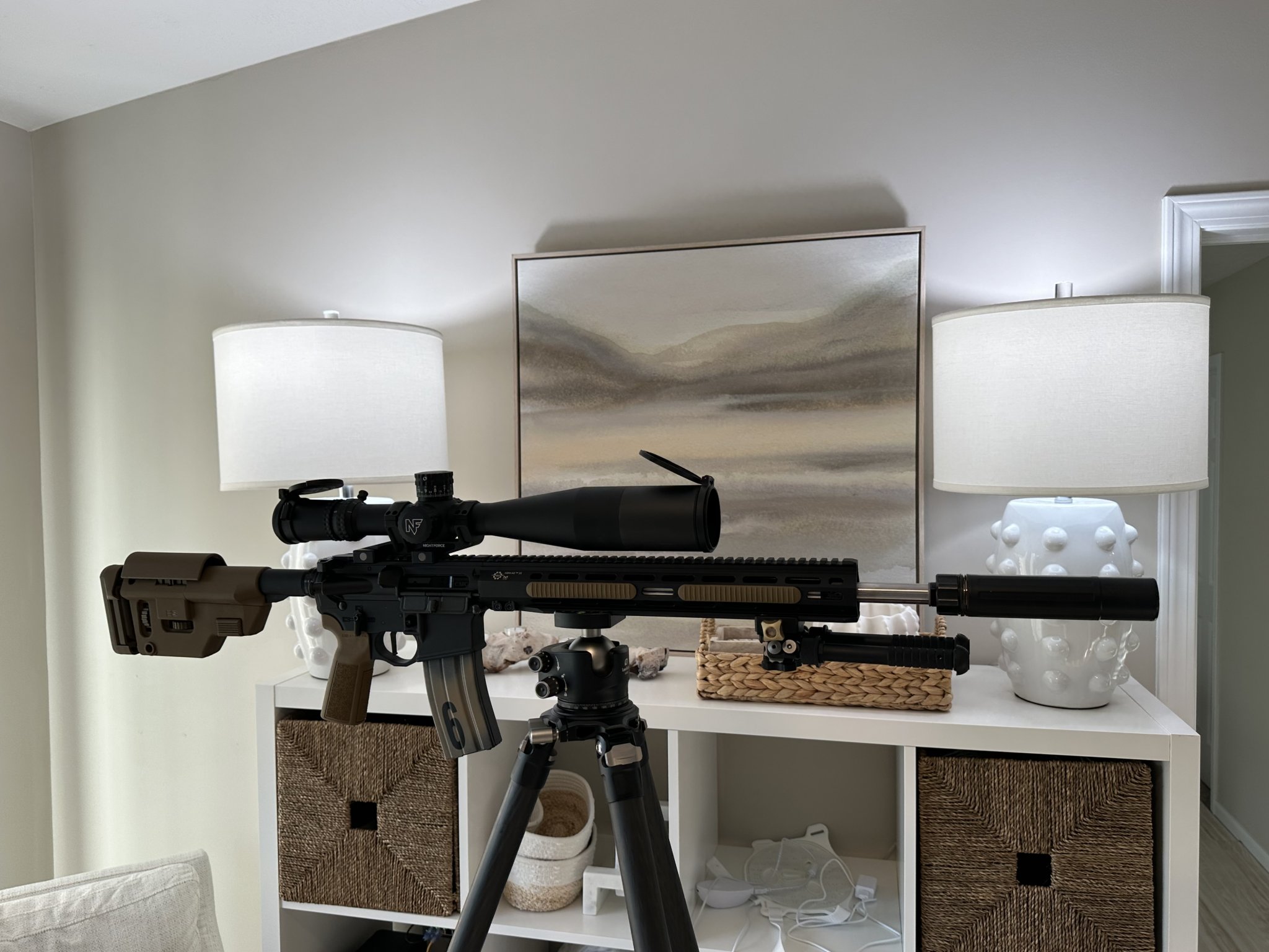

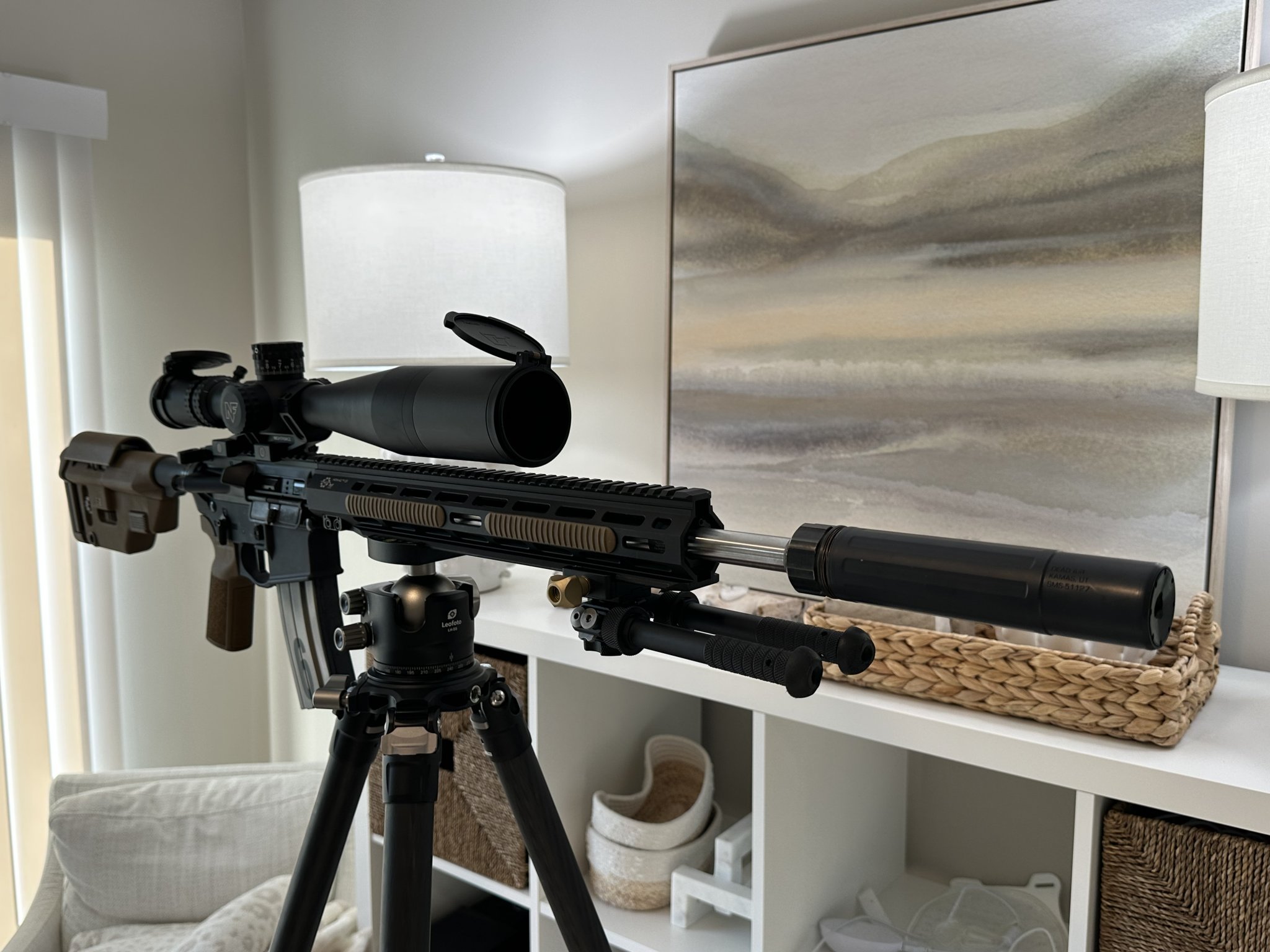

    I just posted some pics of my build with a Superlative Arms set screw with the CMT Arca, also on 6ARC.
