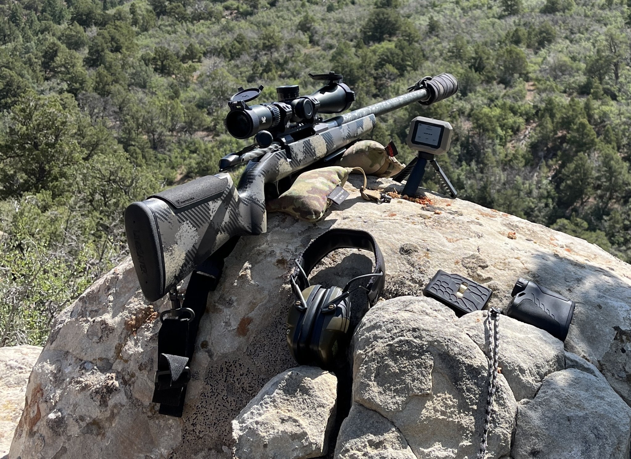

This is my hunting Tikka, I actually own four Tikkas in total so I can swap bolts around when needed. To me the advantage to the Tikka is the footprint staying the same when swapping calibers. I leave the magnum bolt stop in two and a SA bolt stop in my 223. I just spin a 22" 7PRC proof barrel on when hunting elk out west and use Mountain Tactical mags, then when I come back to Texas, swap that for my 16.5" 6.5 Creed barrel and away I go. No feeding issues using the correct mags from the factory Tikka bottom metal (this is the biggest reason I went Tikka on this). It's in a carbon Stocky's VG stock with the factory bottom metal. Just got a Jolene S to keep it suppressed and lightweight that also swaps between the barrels. This rifle weighs 8lbs 9oz with either barrel (suppressor and scope included in the weight total).
My other Tikkas and my 223 (and my T1X) live in Bravos for range fun, so I have a few shouldered barrels I can swap between on those as well.
I'll be the first to say, this is not the cheap way as bolts are expensive, but I was already started down the Tikka road, so it made the most sense for me.
What bolt handle/knob is that?
