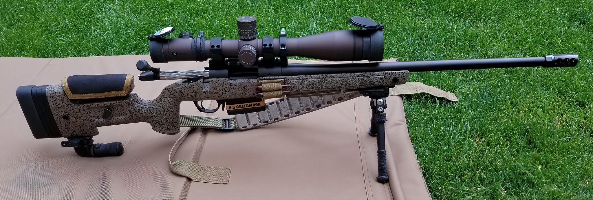

By the way, I recently replaced the B14 bolt with Bergara's Premier Short Action bolt because of the lighter firing pin and spring, and also replaced the Bergara B14 trigger with a TriggerTech Special which all added to my B14 HMR's accuracy and repeatability of results.

I set the TriggerTech Special to 2.8 lbs. as the Bergara manual had stated not to go below. Felt several ounces lighter than the B14 trigger, now with the Premier bolt it feels more like a pound lighter but it still pulls on the gauge as 2.8 lbs. I mostly replaced the bolt initially for the ease of tool free disassembly, the lighter firing pin and spring to prevent cratering with some reloads I get to shoot from one of my buddies' bench and the added feature of the non-rotating gas shield, as well as the heavier bolt shroud. However it has made my results much more constant as well, and the fluting has turned out to be a great plus in Colorado, and Wyoming's dusty areas so far. The TriggerTech trigger had already proven to be a bonus in that regard on a trip to Utah and Arizona last fall. I got my bolt from Bergara for around $300. The scope is a 35mm tube Vortex Razor HD 5-20x50, FFP, EBR-2B MOA Reticle, 125 MOA total elevation, mounted on a Talley 20 MOA base, with Vortex Precision Matched Medium 35mm Rings, 0.95” height. I have the Tenebraex 50VTX0 ARD mounted on it instead of the Vortex Sunguard. I hope this helps.

I am sorry for taking so long to get back but at 67 everything I do is slow. I have the same setup as those above except I had my bolt cut with slots in place of changing mine out. I have to say the TriggerTech is my favorite in my group. I ashamed to admit it as much as I shoot but .75 seems the best I can shoot with it. I do change out and shoot a lot of other rifles and I like to blame that for my lack of improvement but I don't really believe it. I just am getting old and will never shoot as I once did. My Shooting has gone the way of my leg.

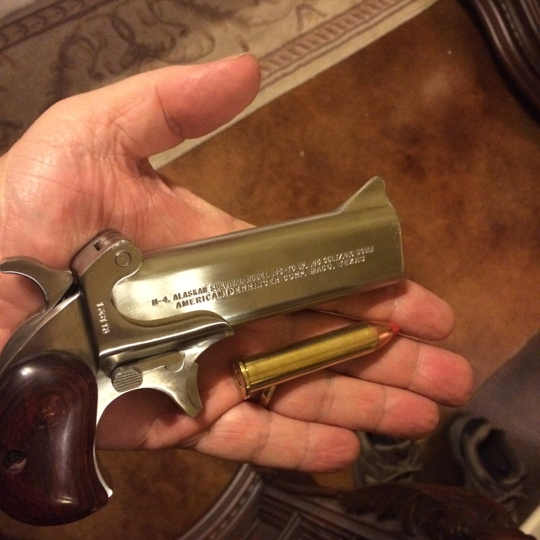

Oh, ya,ll know about me shooting my leg off but did I tell you I broke my hand shooting a 45-70 derringer about 40 days before. It did not have an oversize grip and yes I knew better but could not help myself. God my wife was so mad at me. LOL
