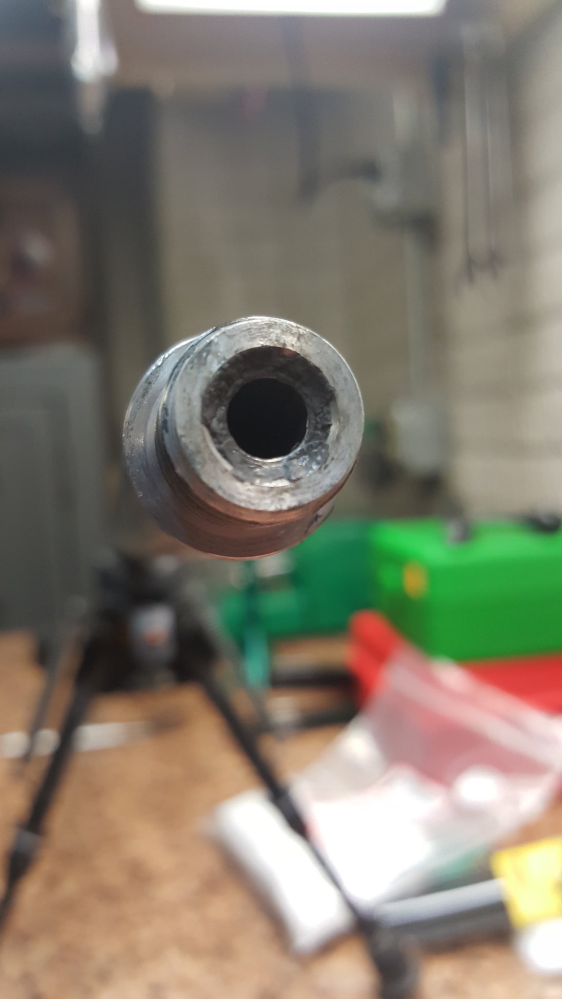

    I'm running a Rugged Surge on my 6 Creed. I took the flash hider adapter off and found a big buildup of carbon. There is a large ring of carbon inside the flash hider also.
    I'm going to throw my can and flash hider in the ultrasonic to clean it, but how do I clean the carbon off of my muzzle?

    I don't think there so much of to do for the muzzle. I was told by many so called experts saying the same stuffs. Just use solvent with q-tip and give it a wipe down where you see any excessive fouling.
    Mine looked like that too. I didn't look at it for 1000 rounds and it became pretty crusty.
    Pile of Q-tips, Ballistol and my finger nail was able to get it off in about 15 minutes.
    Can't say for sure it made any difference in accuracy though. But once I knew it was there, it was hard to ignore it.

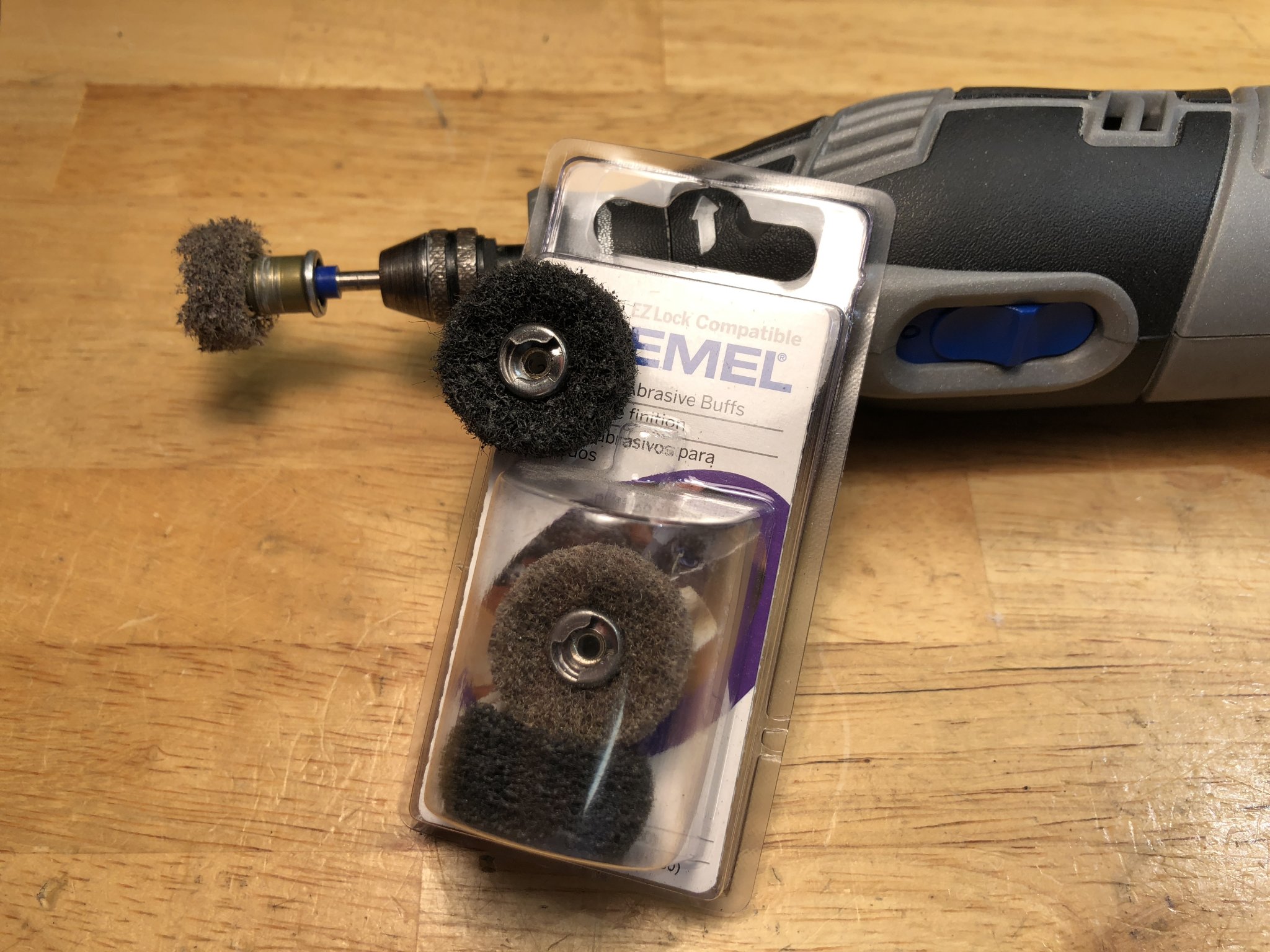

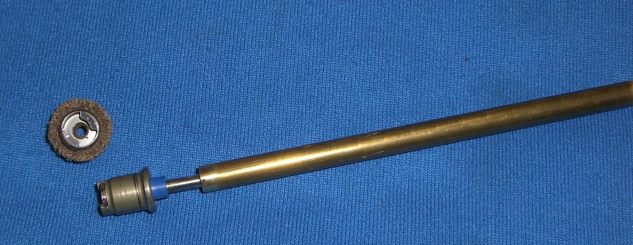

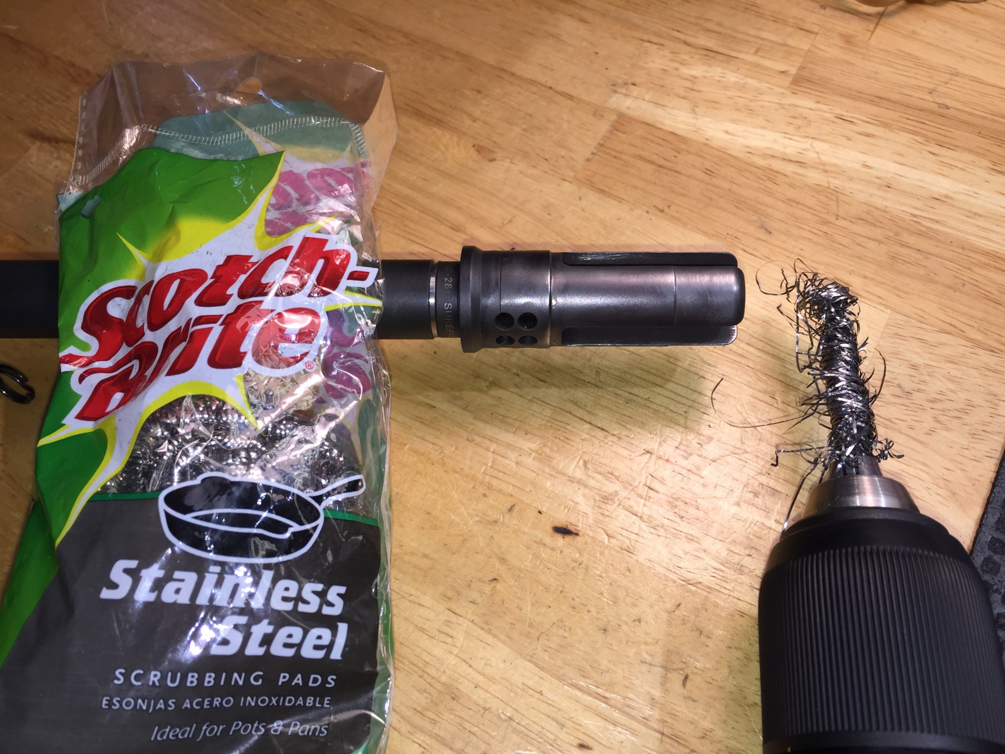

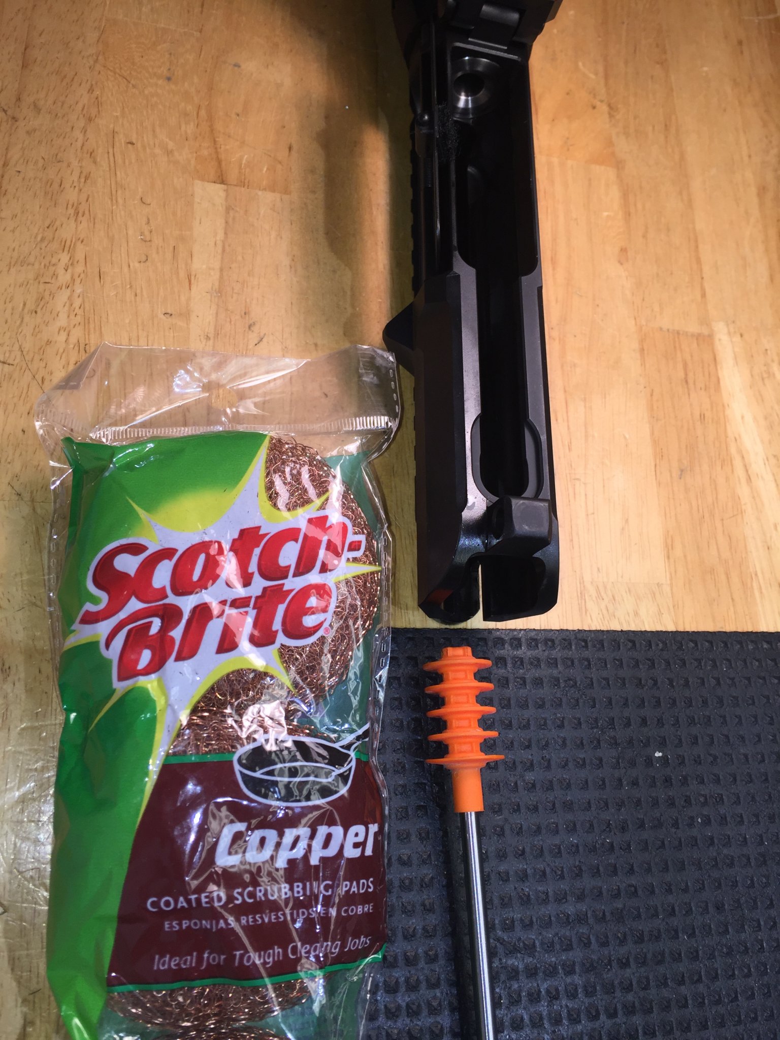

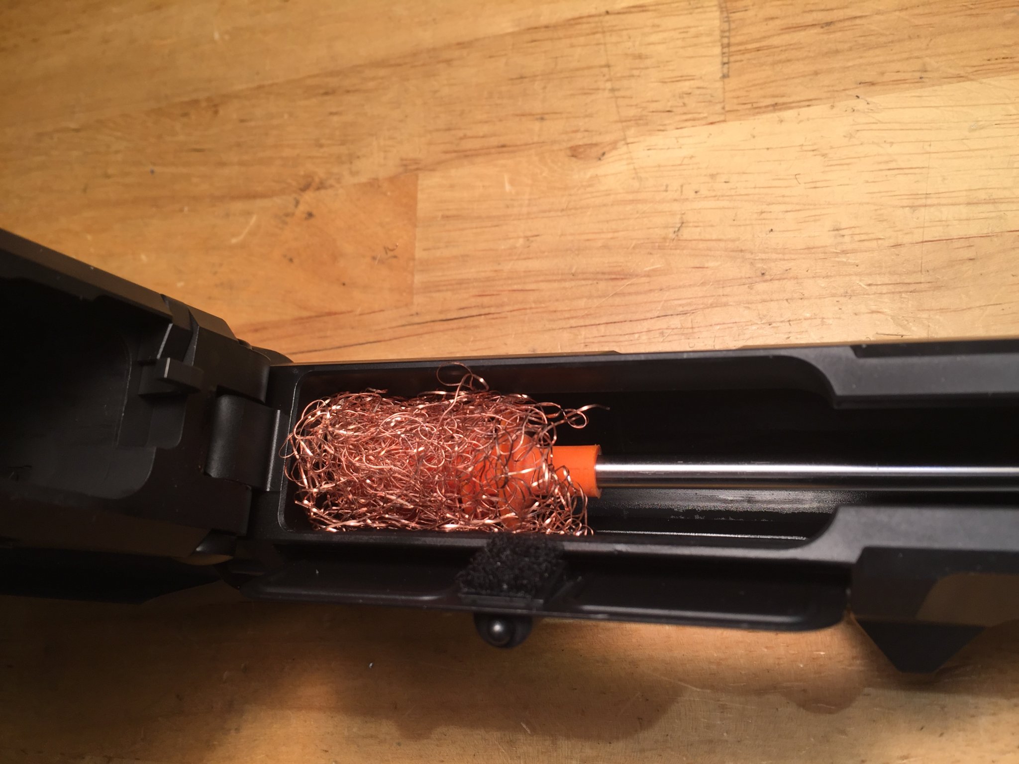

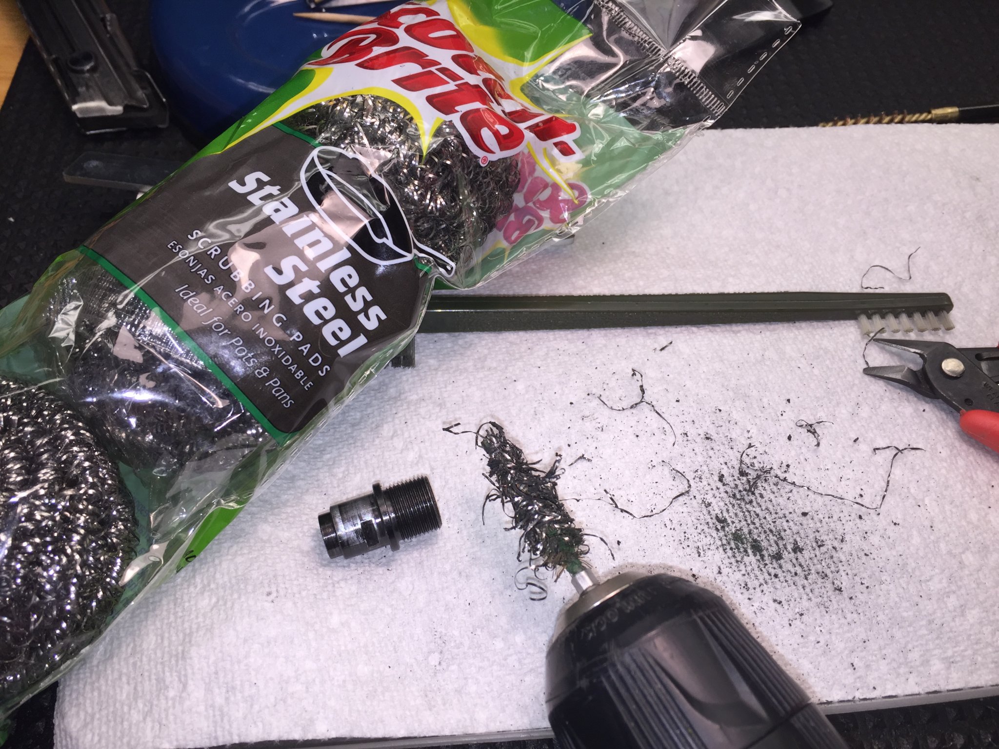

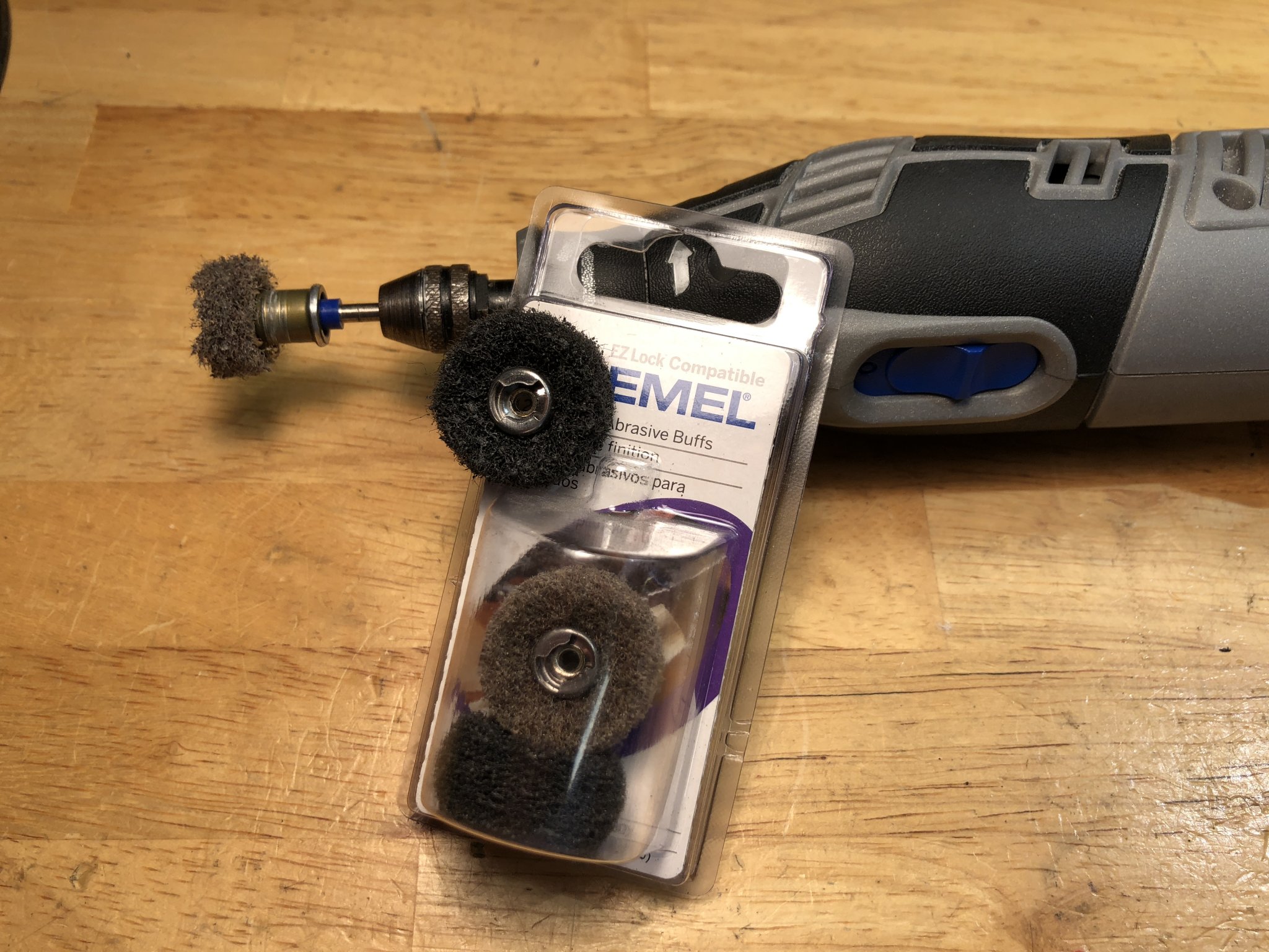

    Wrap some Choy Boy (I use the steel for muzzle) around a used bronze brush, chuck it into hand drill, slow speed, shiney clean in 30 seconds. It will not harm the hard barrel surface; also can use to clean out hard to reach filthy chambers (Wilson AR9 shown.) You can also use the soft dremel buffs on low dremel speed with a light touch, they too knock the carbon flakes in seconds for a clean result.
    Are you advising people to use a steel abrasive to clean the muzzles of their barrels, or are you advising them to use that on just the BRAKE?
    Please clarify.
    -Nate
    ^Both if needed. The muzzles that have brakes or suppressors used will be filthy with hard carbon deposits. These methods will not harm the firearm barrel when done as recommended. The hardness "steel" in the Choy Boy stainless is not anything like the Rockwell hardness of barrel / bore metals. Some shoot steel cased cartridges!
    There are countless references for using this method.
    https://www.ssusa.org/articles/2017/6/26/how-to-clean-tough-lead-deposits-from-your-barrel/
    Yeah well, that's just like, uh, your opinion man. (and SSUSA can pound sand with their 'knowledgable writers')
    Fuck that shit. My barrels cost way too much and I expect way too much of them to be running fucking steel wool in the muzzle. Though I grant you we are in "Stupid Questions" right now, if we were talking strictly about blaster AR-15s, Mini-14s, box auto pistols, etc., then maybe my answer would be different. But we aren't.
    Personally, I think it is poor to even suggest that in a precision rifle-minded forum.
    -Nate
    Strikeeagle1 justed showed what not to do to your rifle. NO! NO! NO!
    It's not even a redneck style. NEVER! NEVER! NEVER!
    There might be countless references out there, and also there are countless bone heads out there giving out BAD information.
    What he's doing is fastest way to clean and also fastest way to damage the rifling/barrel. It's one way to turn your rifle into a shotgun. There goes accuracy bye bye.
