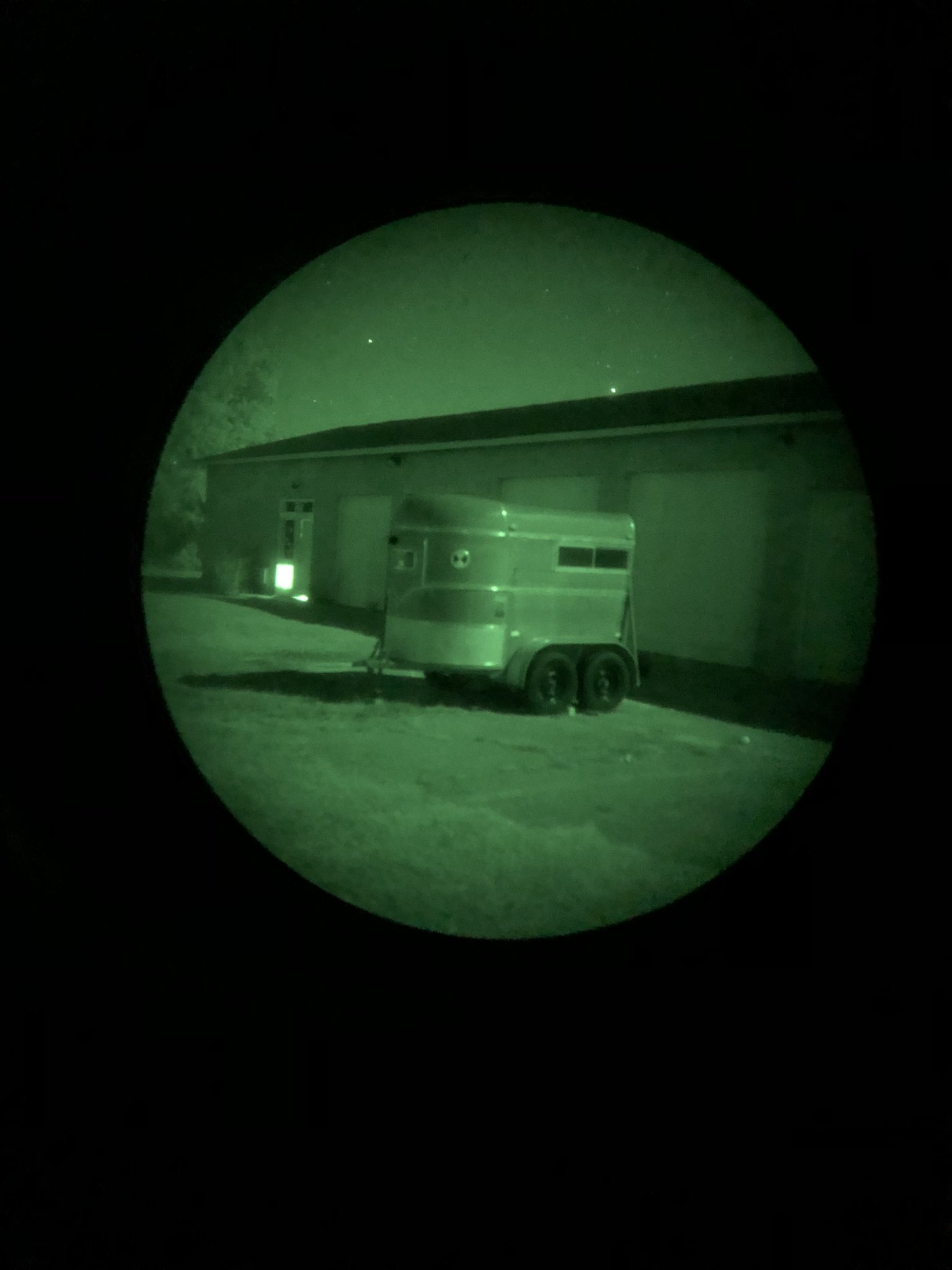

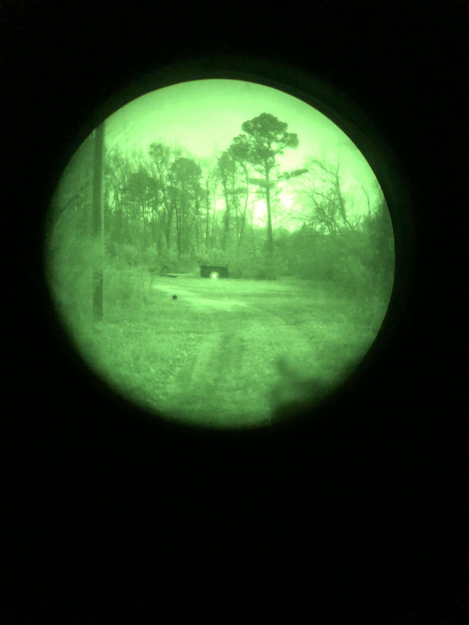

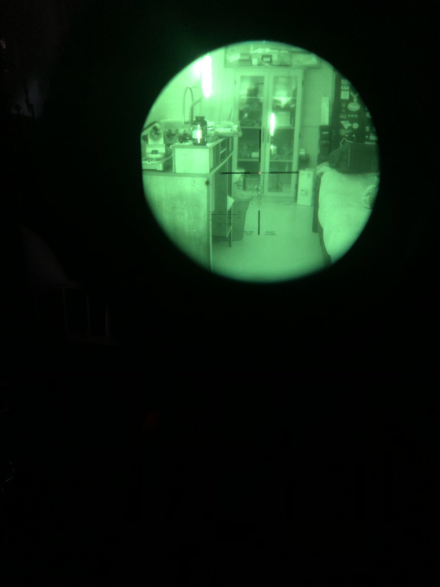

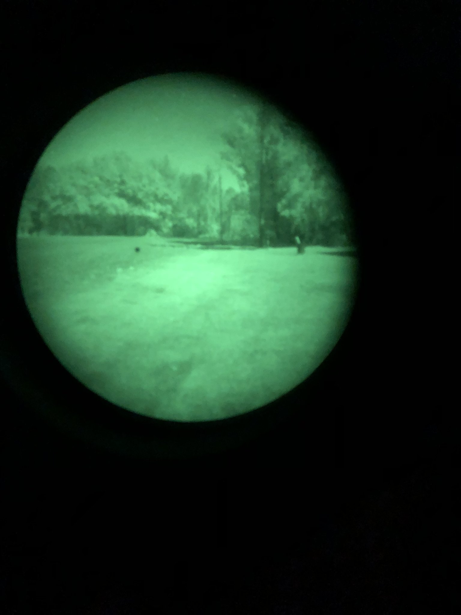

    Lots of different ways but basically turn it on and point it at a blank featureless white wall and then try to hold your camera/phone still enough to take a photo through it. A tripod can help, or you can take a video through it with your phone and screenshot the best frame from the video. Places that sell a lot of NV sometimes have special rigs that combine a NV/thermal mount with a camera mount to make this a lot easier.
    Like this
