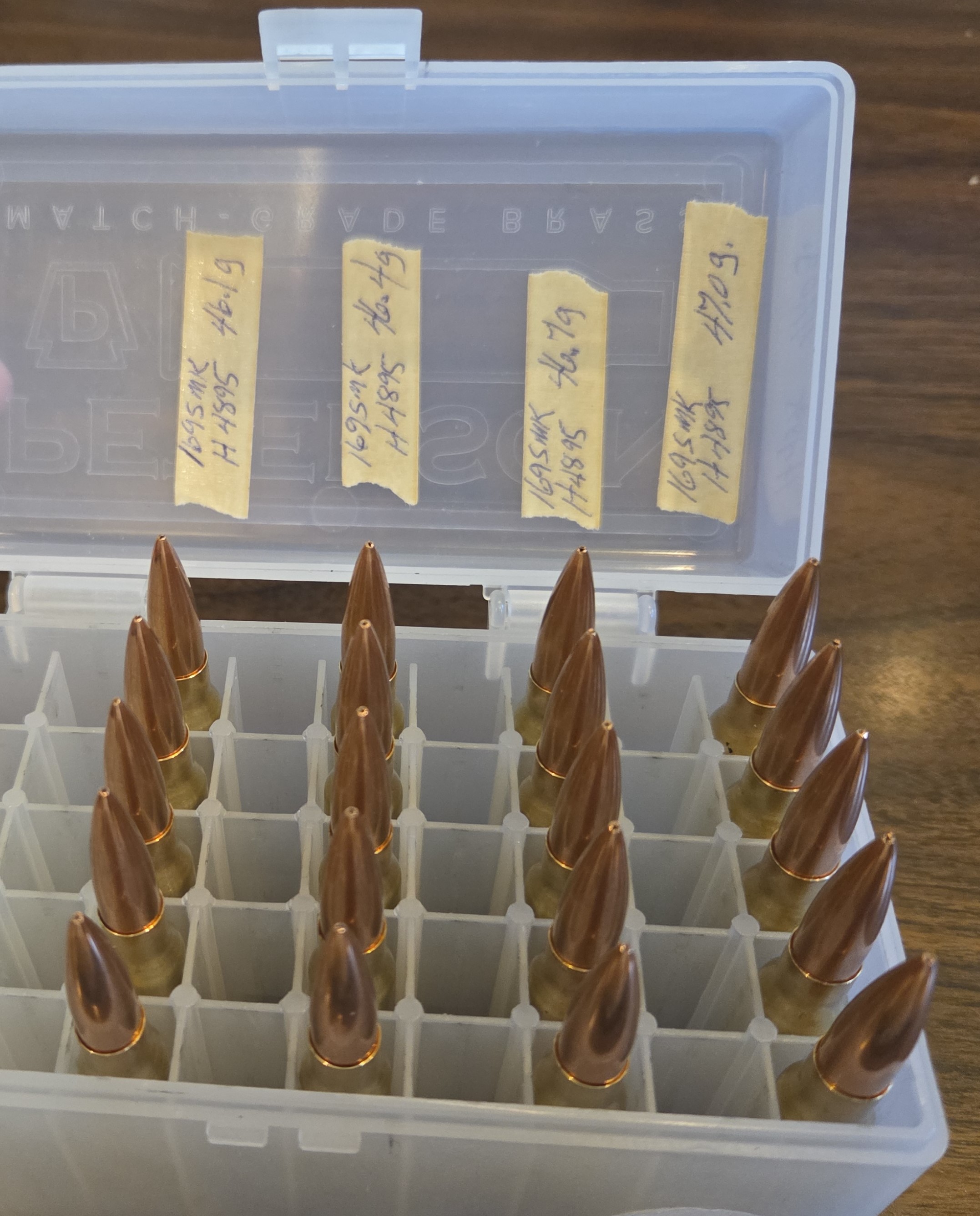

I have 50 and 100 round cartridge boxes that I organize my cases in for load development and put corresponding labels (usually writing on some narrow masking tape for reference), like this:

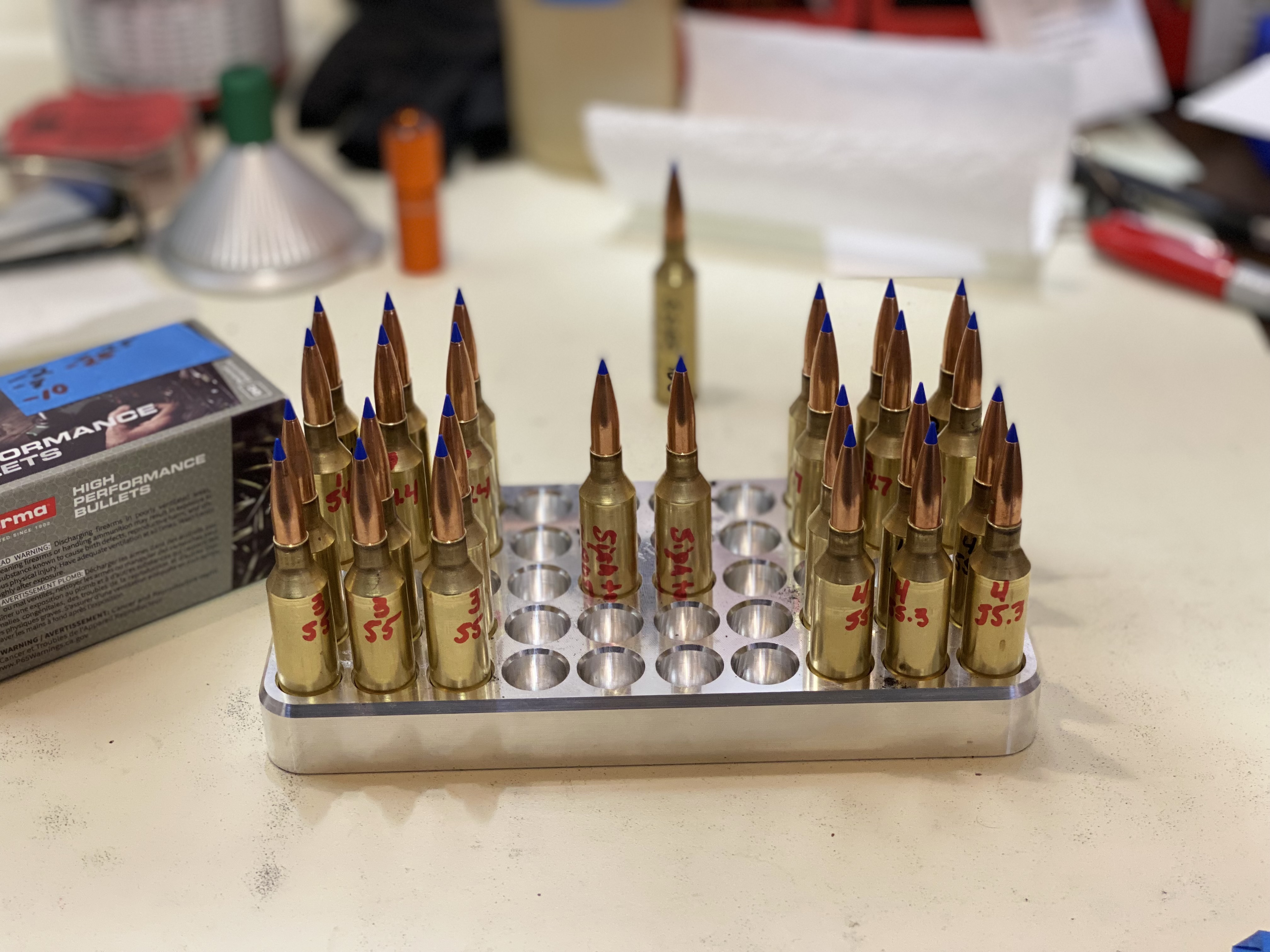

Each case is numbered with the group and the load.

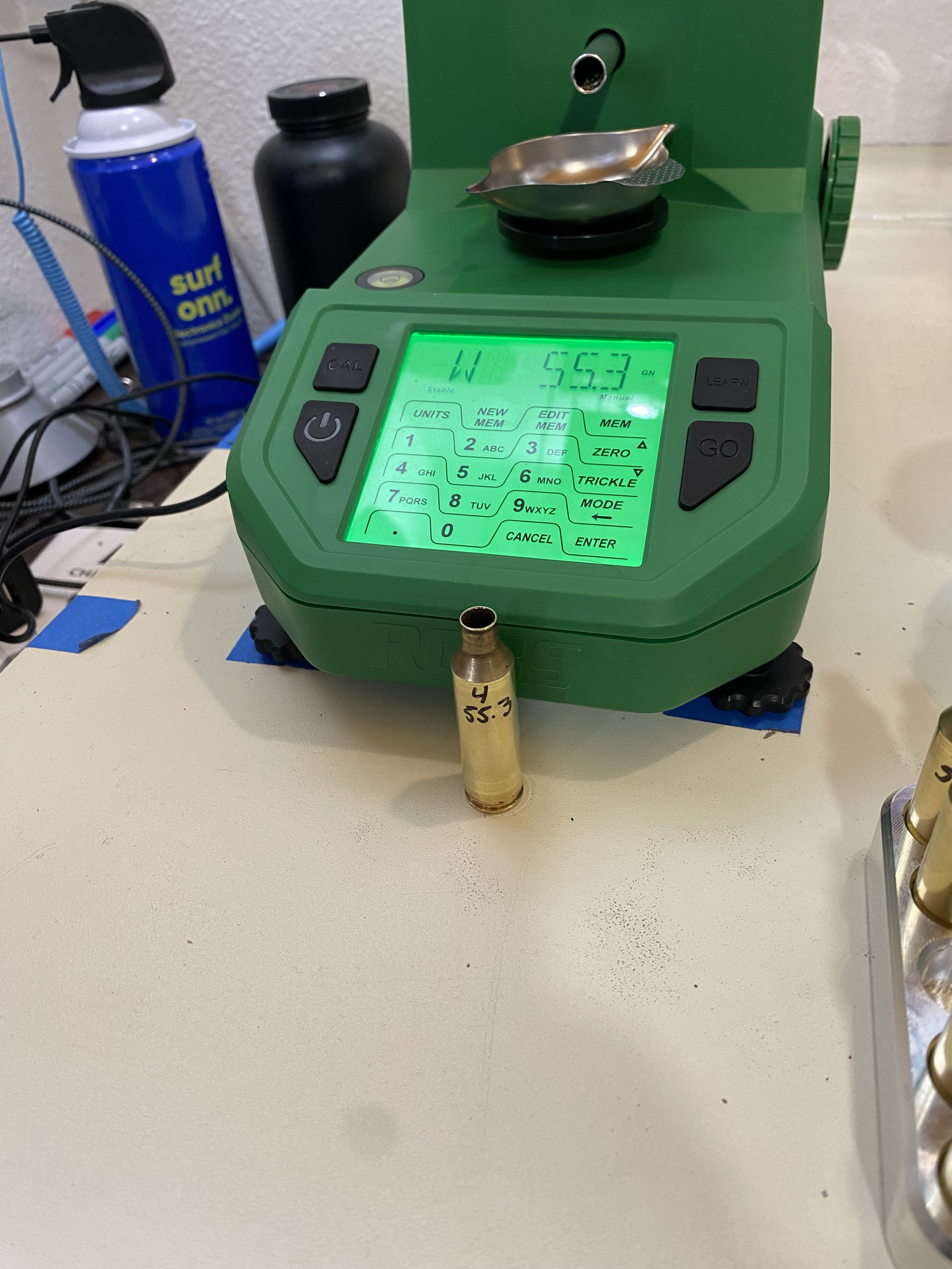

I take a photo of case in front of the machine with the load punched in for that set. That way I can always doublecheck my actual load.
This allows me to always doublecheck and to inspect case and primers at home.
Labeling them individually like that is a very good way to keep track of the cartridges being ejected onto the ground or when firing a semi, then when they're collected, you've got a way for which case did what . . . like if one wants to align chrono numbers to each case.
