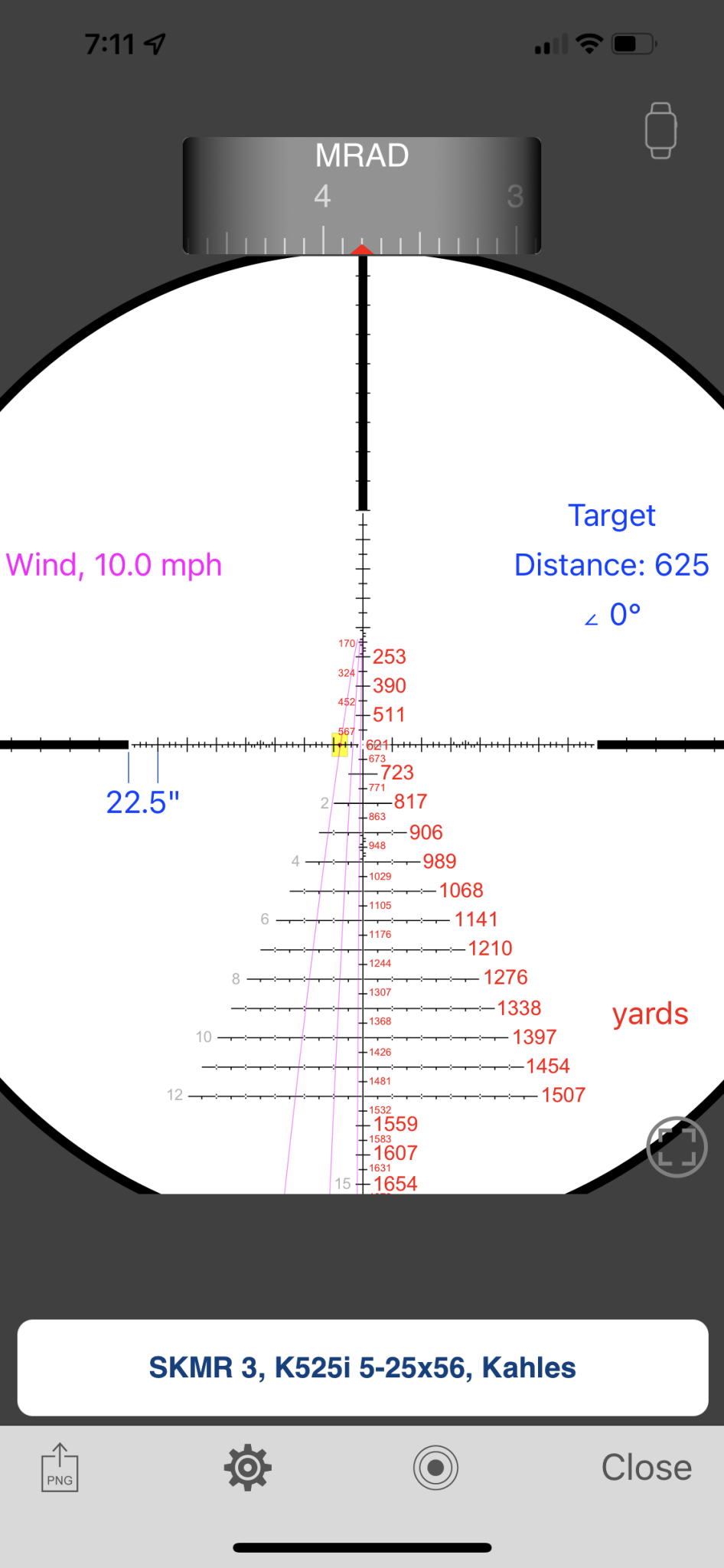

above has the right idea for speed and combining the two, holds and dialing.
It would depend on target size, wind as people noted, but if you look at your data like this:
350 = 1.1
625 = 3.1
800 = 4.7
You see you can easily round the 1.1 and 3.1 to 1.0 and 3.0 then you are adding 1.7 for the 800 pretty simple.
So I think the method above is the smart start depending on the conditions of the day and the target size.
350 hold under 2.0
625 = 0 hold dead on
800 = 1.7 hold over even use 1.8 hash mark
but odds are you'd have time to dial all of it

For this stage, regardless of positions, and assuming a par time of 2 minutes, I'd dial and adjust parallax for 625 and hold under for 350 and over for 800. If the par time was there minutes, I might dial. But, since it's one shot and move to the next target and considering you do this a total of nine times, it makes sense to not dial and the differences in reticle position is minor.
In my case, it would be dial to 3.8 for 625 with a hold under of 2.3 and a holdover of 1.8. Depending on target size you could possibly dial for 625 with a hold under rounded to 2.5 and a holdover rounded to 2.0 and favor the the top of the target for 350 and the bottom of the target at 800.
