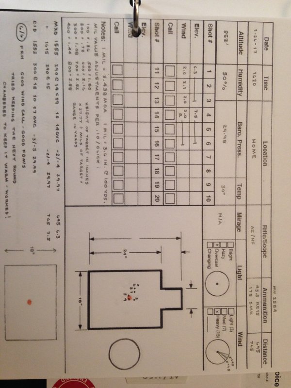

    Make as many notes as time allows. For me the most benefit has come from critiquing my performance, positive and negative, and writing this down in a separate journal. Especially documenting an action plan for what to change, evaluate, etc to insure proper focus going forward. To me the field data book is just that, data. I do summarize ballistic data in Excel to aid with fine tuning the ballistic calcs.
    We have 4 dedicated precision rigs. Each has its own 3 ring binder that the data sheet goes into after shooting. I use the same sheet for all 4, and fill in the environmentals along with how I did for wind calls, fundamentals, etc... I'm my own worst critic, but that keeps you honest and hopefully improving. My data sheets have evolved over the years and work for me. May not be the ideal for the next guy.
