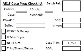

I use a label for every set of cases/rounds which captures all my reloading details and that stays with the set whether the case or completed rounds are in a box, tub, ammo can or plastic bag.
I anneal after every 3 shots so I can keep track of the times the case has been fired.
