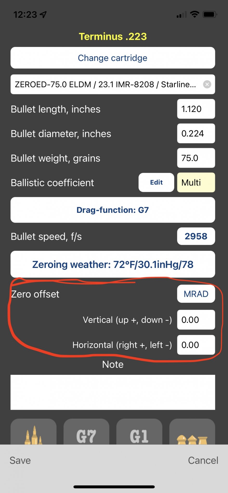

OP says he is using "the Hornady app," which I take to mean Hornady 4DOF. This reply assumes he is not familiar with other apps, and I may be wrong on that.
4DOF, insofar as I can tell, does NOT support entry of zero offset. So, for everyone telling OP to enter the offset into his calculator - he doesn't have that capability (If I am wrong, please correct me, with direction on how to get to the offset entry point).
OP, below is a screen shot of one load entry (Strelok Pro) for one of my .223s. This happens to be the load - call it "Load A" - with which the rifle is zeroed, so the red-circled offsets default to zero. I use a 100-yard zero, so when I ask for a 100-yard solution the calculator gives me 0 mils elevation and 0 mils windage for that load.
Let's say that I try a different load - "Load B." I shoot five rounds of "B," and the group is .2 mils low and .5 mils right of POA. So, I enter "-.2" and "-.5" respectively in the vertical and horizontal offset fields. Now, when I ask for a 100-yard solution, the calculator shows me .2 mils "up" and .5 mils "right" for Load B. The calculator knows each bullet's BC and other characteristics, so if the 100-yard settings are carefully entered, rounds should be close to POA at distance when the offsets are correctly set.
Hope this helps.
Hope this helps.

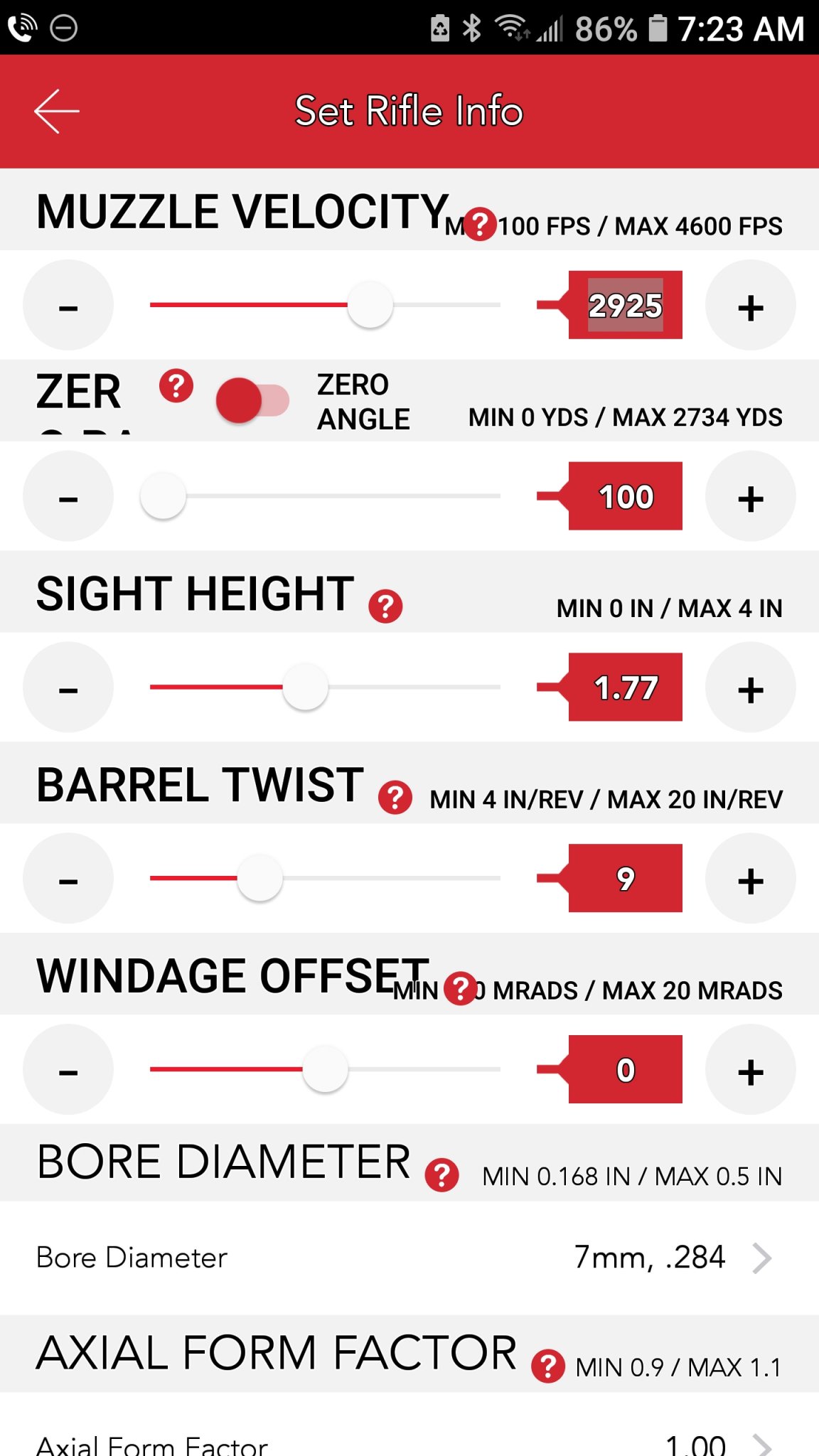

If the OP is using 4Dof, he should create a profile for each load and enter the zero range based on his verticle impact.
Windage offset can be entered by tapping the 3 dots and going to the edit function.
Go to: Set rifle info.
Here's what comes up.
Once that's done and saved, he can simply switch bullet profiles without changing anything on his scope.

if you're .2mil high at 100y with the new ammo, scroll yard by yard and find .2 up elevation. change zero distance to that number (with my 7SAW: 162eldm at 2840fps ballisticarc shows .2 from 160-175y so i'd set zero distance to 167/168y)
and windage offset is right there in the screenshot Mike posted
