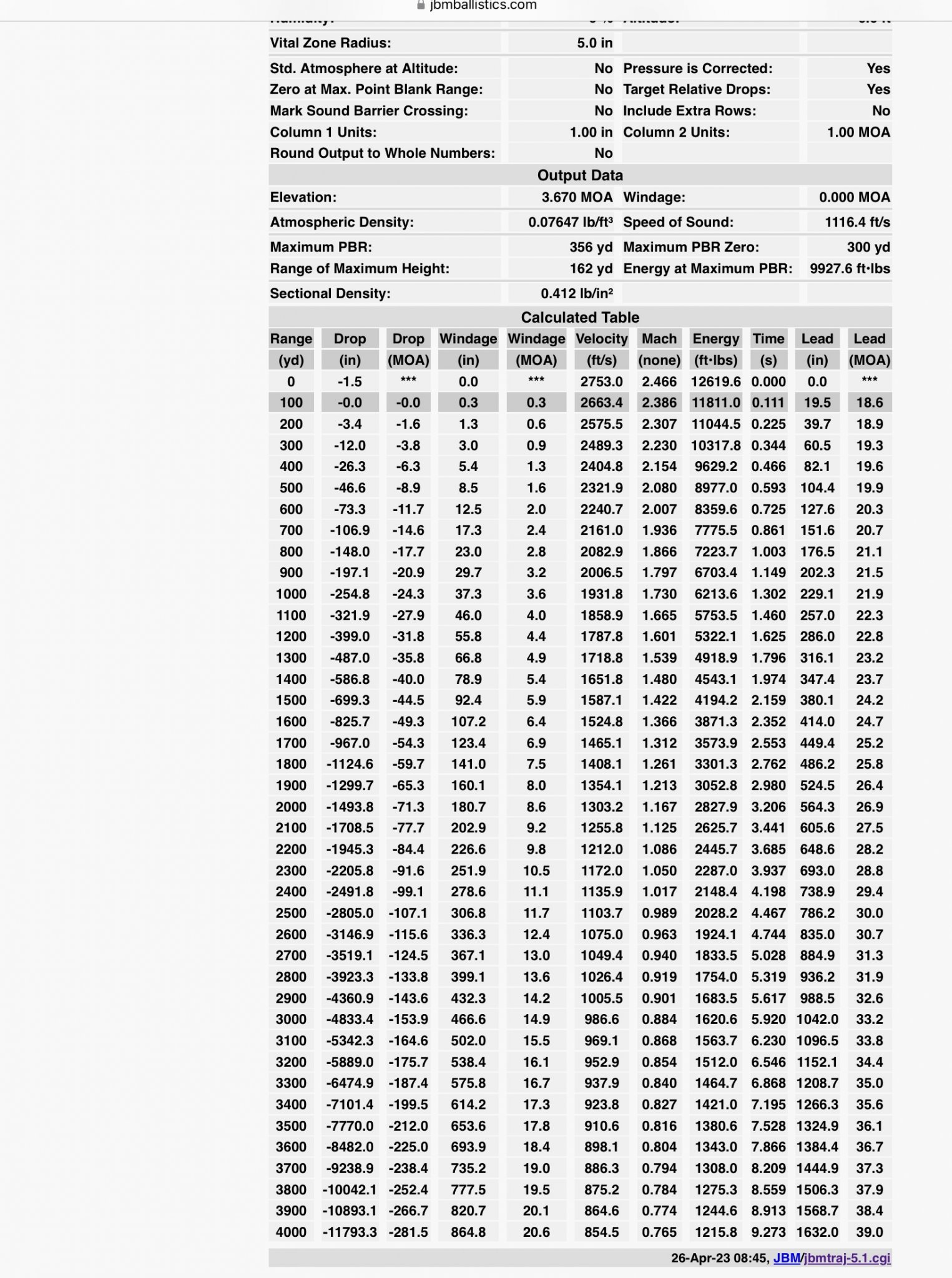

If somebody can tell me how far approximately I can shoot out with this setup I just got, I’d really appreciate it, as I’m not too familiar with these scope calculations and ranges. My setup as follows:
Barrett M99 29” 50 BMG Fluted With 27 MOA Rail
Atacr 7-35 Mil-R
Elevation - 100 MOA/29 MRAD
Windage - 60 MOA/17 MRAD
Spuhr 4302C 10.3 MOA 34mm 1.5” height

Lol 750 grain amax with a bc of 1.05 and muzzle velocity of 2750 roughly. It’s still shooting 1900fps at 1k yards. I knew that already. But I guess I’m just stupid.
Letting the default settings fill in all the details you are still leaving out, I give it 4500 yards.

Looks like theoretically 77 moa of elevation. But I've watched a group of guys consistenly miss with a 50 cal Barrett, and somewhat harrass an elderly couple, while TRYING to hit a 680 yard gong. I moved the couple to my bench and then giggled as I rang the gong with my iron sights FAL. YMMV.
