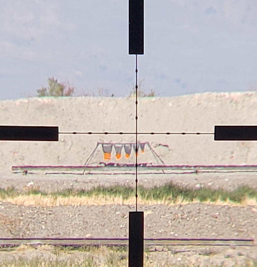

This is looking through an NXS 2.5-10x32. silhouettes were larger than IPSC. The one 2mil left of center is ~800 yards IIRC, and the car is well over 1000.

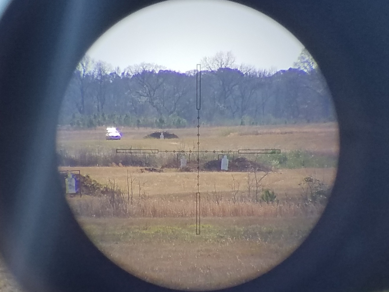

I've gone out to 1k with 2-10 PST gen II with .223. Last Quantified Performance match in Blakely, Georgia, at the Arena training center, one of our squadmates made an 1166 yard impact during a course of fire with a 1-10 Razor gen III running 5.56 ar15 platform. He did dial-up since he was out of reticle (capped turret). Nonetheless, I found that pretty impressive. I don't recall if it was a 16" or 18" barrel, though. I know he was considered General precision and believe they're capped at 18" barrels.
