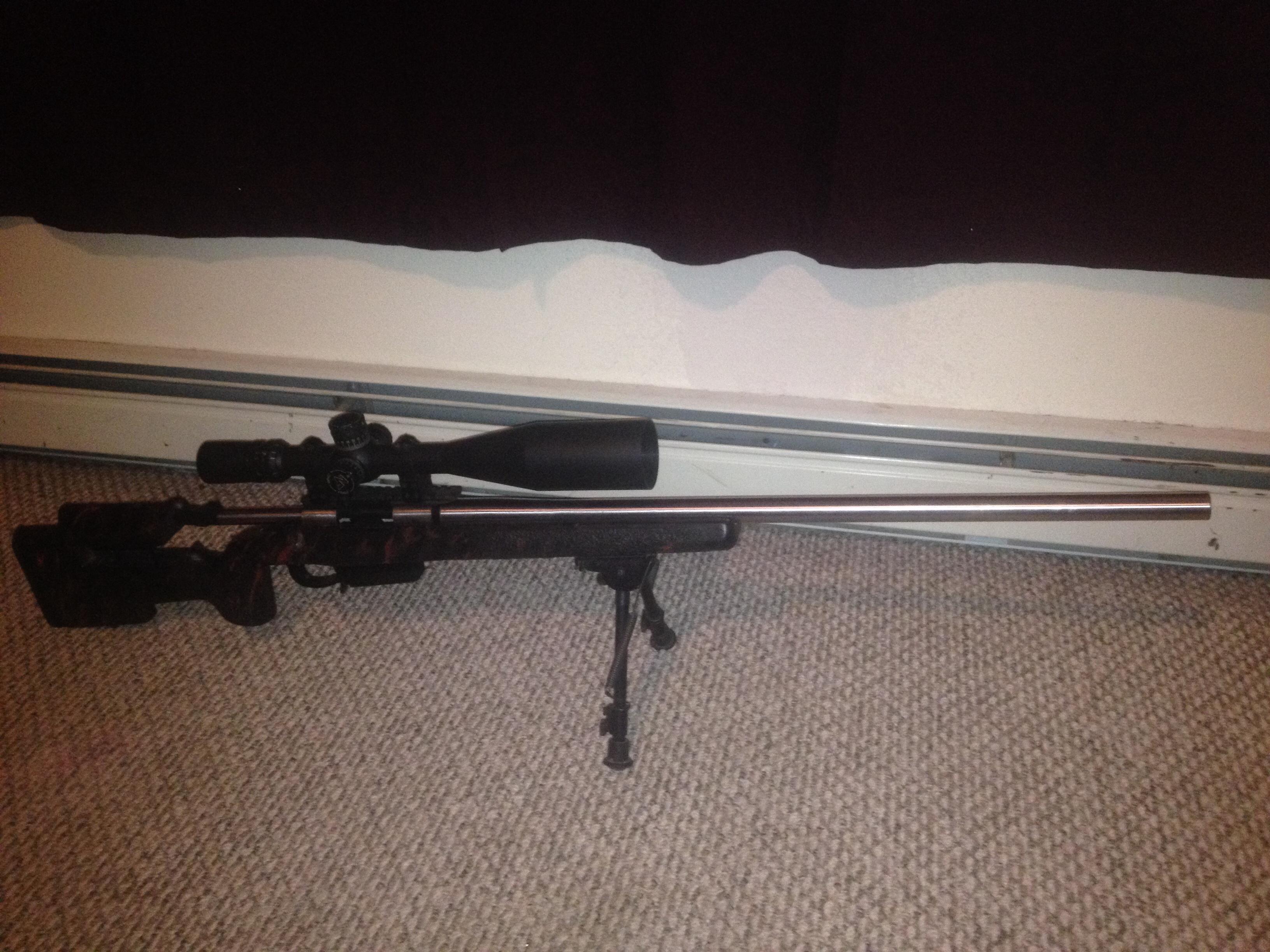

Wow, a .183" avg. over 11 groups of five with three shooters. Friggin' fantastic. I wouldn't touch anything. Two questions, how heavy is the rifle and what kind of rest?
Edit for third and fourth questions: What are the rifle's components and who put it together?
The build was done by my dad and I. It's a blueprinted remington 700 with a krieger barrel, tubb taper and a .375 recoil lug 27" barrel. Mcmillan a5 stock and a nightforce 5.5x22 nxs. We all used sand bags. image.jpg
