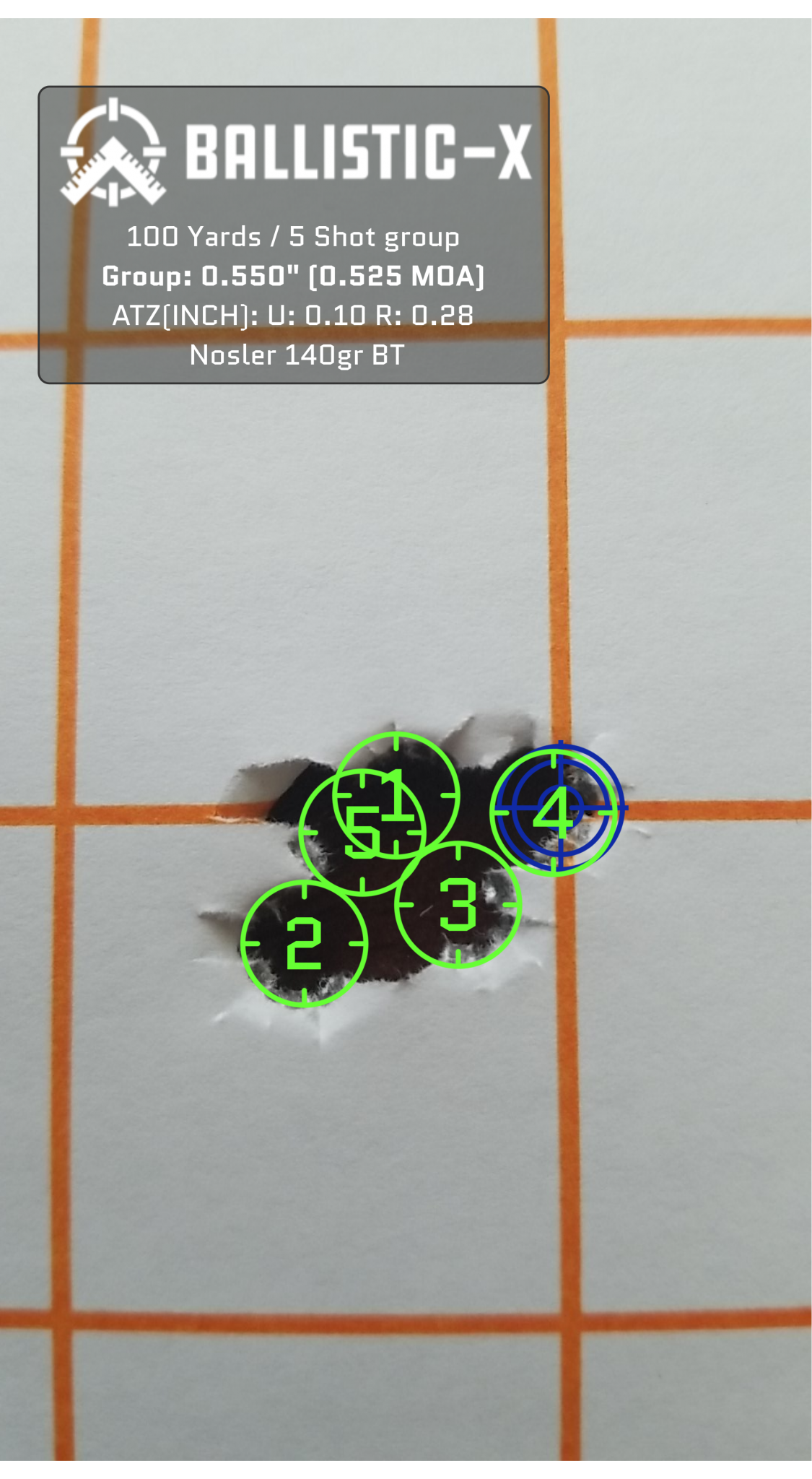

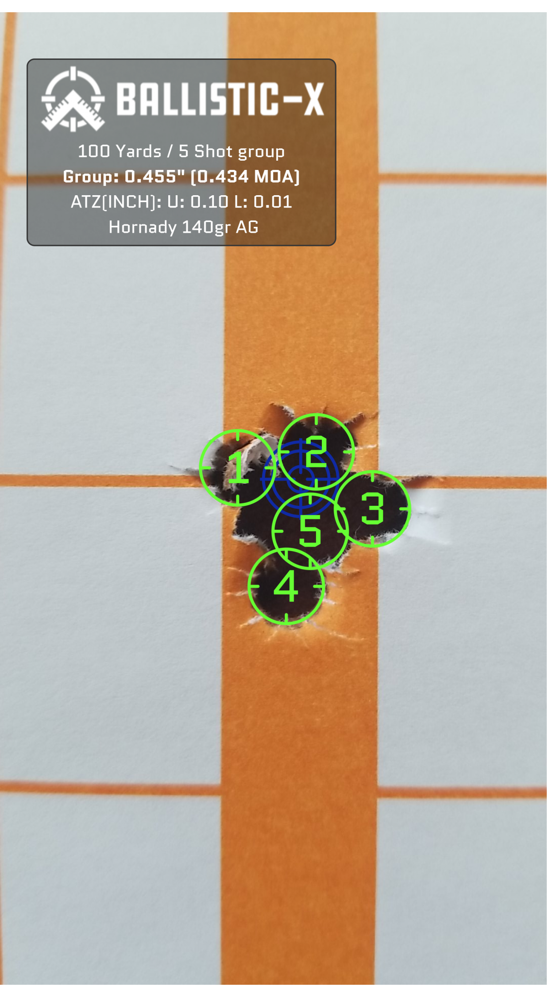

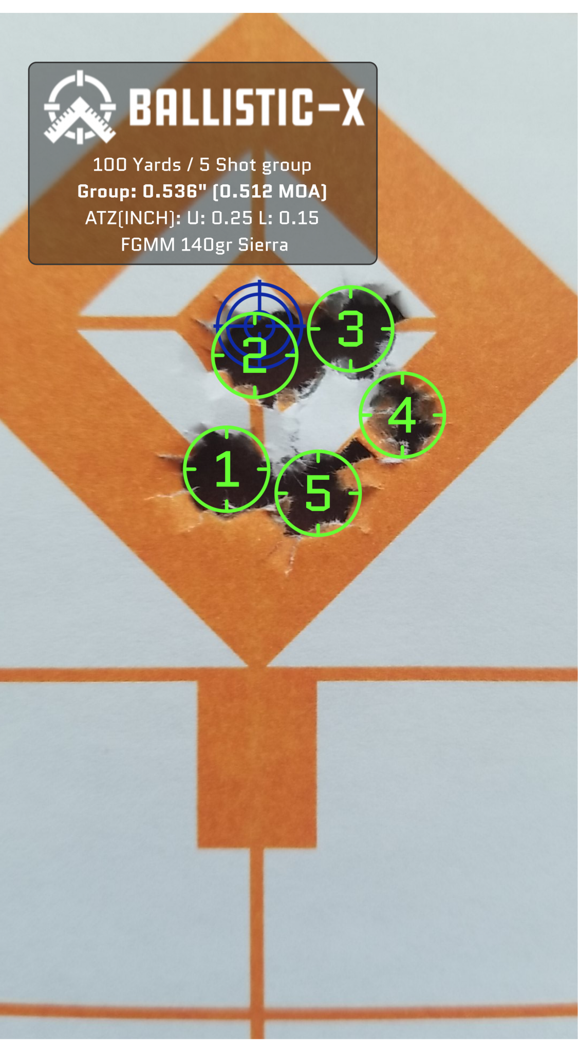

Range Report:
100 rounds in with sighting in and some fiddling with the LOP. Ist groups were ok, not sure if it was me getting used to it or the barrel settling in. We both eventually settled in for some respectable groups.
Also got some chrono data 2660fps with Nosler 140gr BT, and 2721 with Hornady 140gr AG.
No brake on this rifle yet. No extra added weights either.

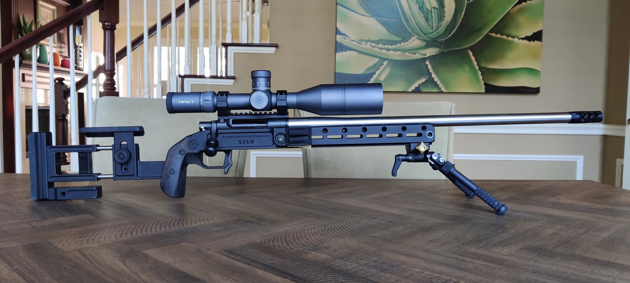

Similar to others, I have a "self-built" ARC (Nuke 1.0 in a XYLO). Accuracy/reliability/functioning, 110% on the action.
So far digging the XYLO as well, especially the grip. I had this setup below at one of Frank's classes this past week and learned that I need to ensure the one set screw on non-ejection side is tightened down. The rear of the stock slipped off on first string as I pulled the rifle up, but an easy tightening w/a T25 and back in action.
