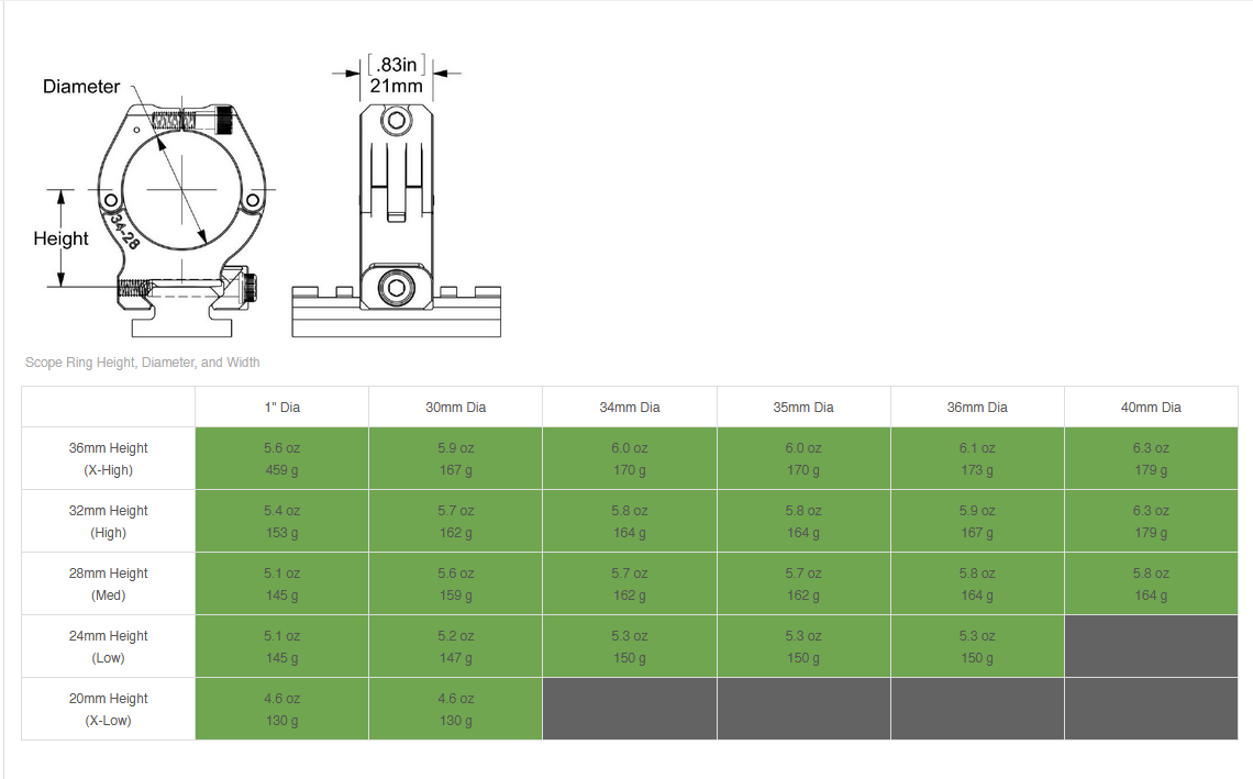

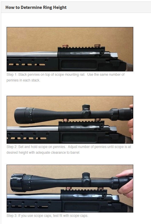

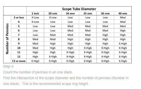

Hey all,
I have a tikka t1x in 17hmr. Got a 20moa pic rail and just got a Maven rs3. Now just need to get some rings. Not sure how high or low I can get away with. I bought a cheek piece as well in case they were a bit too high
Any input is appreciated
thanks
From American Rifle Company site
The table above applies to ARC's M-10 rings but here you can see the height of their various rings and relate that to the brand you want, right?
I have 2 sets of M10 rings and like them a-lot.
