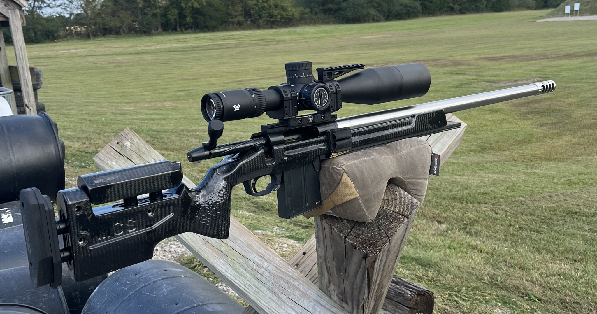

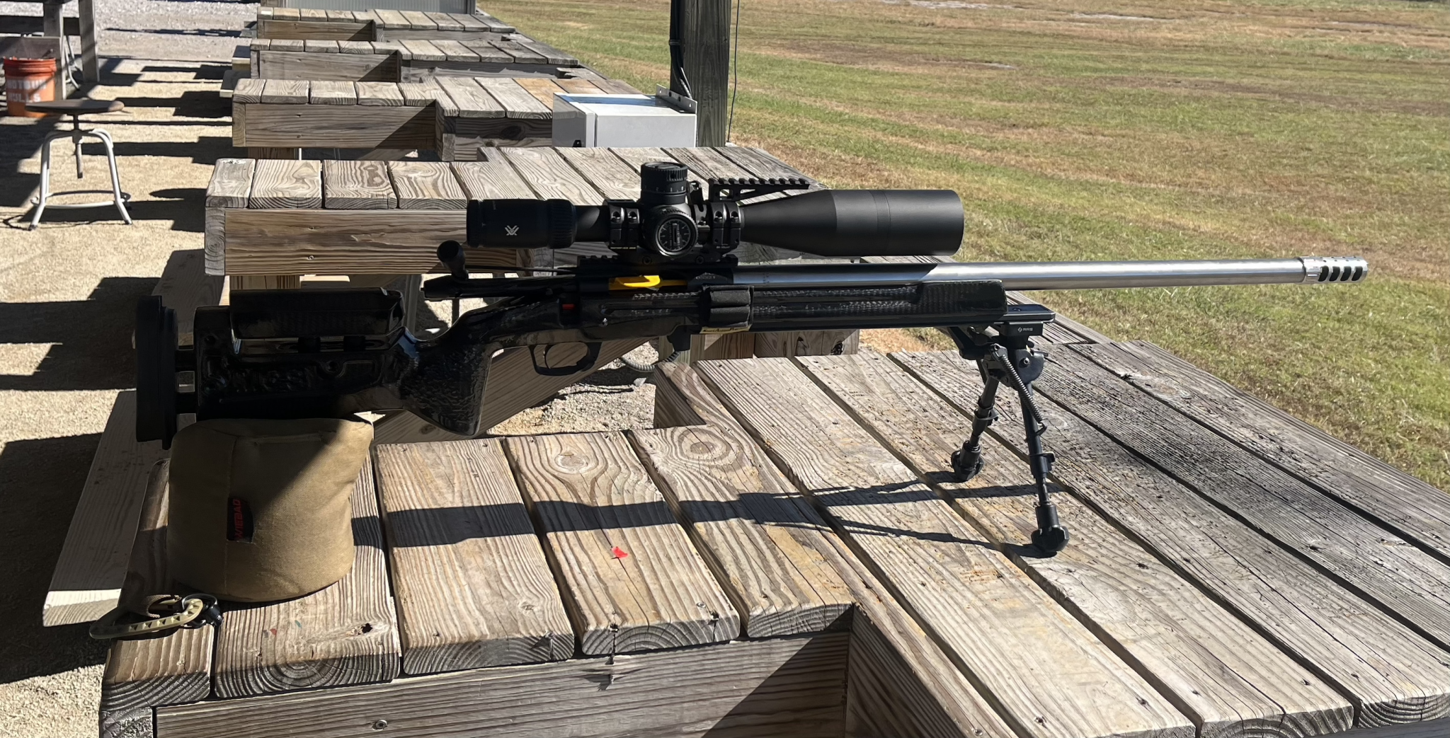

Join contest SubscribeLearned that the hard way. Always had my neck cramped then one day it was like a light going on..."Raise the height, dumbass."Higher is better,
We want our head straight and not rolled over, too low rolls the shooter's head over.
Looks at the door kickers now, they are mounting their optics higher, taller mounts for the win.
I use 1.375" as a minimum now, 90% of stocks have cheek rests that lift, we have plenty of Cheek to use, lower is harder on some chassis today, like the AI ATX, ASR, they are right on the edge of low, so higher is better.
