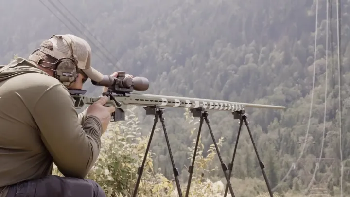

    gonna rebarrel my (shot out) single shot (short action Rem 40-X) 7mm mag to 7PRC, loaded for 180s. Current barrel is 27.5", but it has a brake. New barrel will run a TBAC Magnus RR can. I ordered a Krieger w 28" finish length, but I'm beginning to wonder if that's going to be too long with a 10.5" can on it. Shortest I would go would be 26". Going to 28" will get me ~50fps more velocity. This will be a varmint slayer (Sendero profile, heavy), so won't have to carry it anywhere
    When does barrel + can on a traditional bolt gun get so long as to be a mistake?

    In all seriously, barrel length is free velocity or same velocity at lower pressure meaning less powder and longer barrel life. Always take free performance if there is no downside. For a bench or prone gun no reason to keep it short.
    Personally, I don't want anything over 30 if it's performance rifle. I think my 300 Norma Imp is 28" +2 for a brake is 30.
    Rifles I want to be even remotely maneuverable I want it at or around 24 tops.
    My 22 Creed, and 6.5 PRC hunting rifles are both 18" with a 9" can, which comes in right around 26.5 and Ideally I'd prefer a couple less, either with a 7" hunting suppressor, or a 16" barrel.
    I have a 7 Rem Mag that's purely a bench gun, pretty sure it's 26" with a 9" can and it's just too much for me.
    Reactions: secondofangle2
    ^ that’s kind of what I was worried about, but I think given the totality of the responses here, I’m going to start at 28 and then buzz off a couple of inches if I find it to be unmanageable. Either that or just go back to muzzle brake.

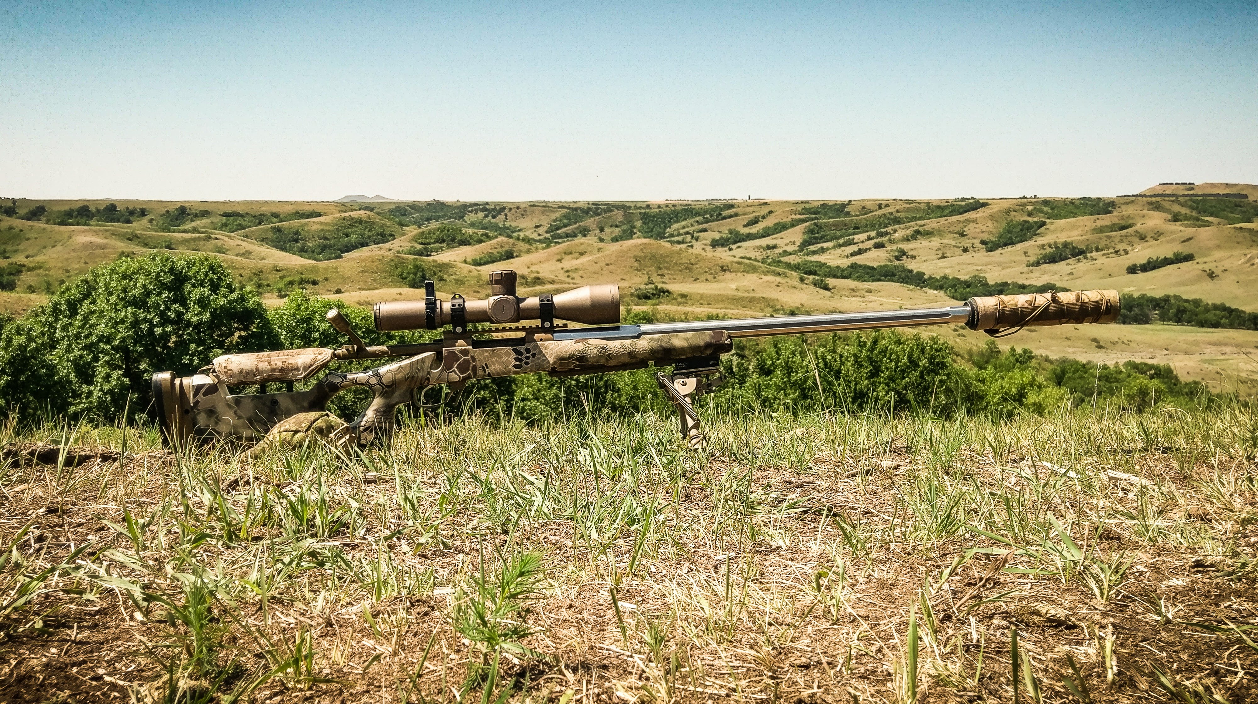

    Running a 26" Krieger in 6.5 Creedmoor on my Ruger RPR custom shop rifle.
    Also have a CGS Hyperion on the end too. From butt pad to end of can is 54" long. I'm not worried about length either 🙂.
    Adding it's not my hunting rifle, so no carrying distances and it's 19 pounds unloaded.
