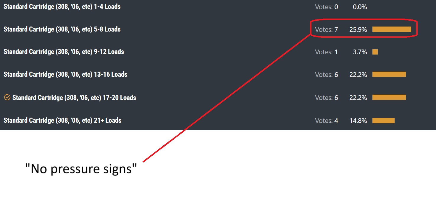

    I think we're seeing some strong patterns already. 67% of standard cartridge responses are in the range of 13-20 firings, and 60% of magnum responses are in the 5-8 bin. It seems like I could reasonably expect a reloader with good reloading practices and good brass to end up in that range, of course with significant +/- due to all the factors we know have an impact.
    I’ve got 2 different barrels and 19 firings on a batch of 300 Lapua that are ex-22-250->6CM (new/born-as Lapua 22-250 that I ran a .241” mandrel through and then fire-formed into 6CM on the first firing). I got them during Covid when brass was scarce, and since Lapua doesn’t make LRP 6CM brass and I had a bunch of CCI200s… I made it myself lol. The only side-effect is shorter than normal necks (so they end up sort of like a big Dasher case). FWIW, I never ran either barrel hotter than ~2900fps, and they’re still going strong (and I’ve never had to trim them lol). I anneal every firing on an AMP. I’ve lost ~5-6 to matches/props only. If I get another 6CM barrel, I’ll use them.
    I’ve also got 300pcs of Alpha 6GT “Gay Tiger” head stamped brass with ~13-14 firings on them over 2 different barrels that are still going strong. Same deal, annealed every firing on an AMP, ran/running slowish at 2800-2850fps, though I’ve lost more like ~20 due to matches/props (seems other guys will pick up the 6GT cases but leave the 22-250s lol), pockets are still tight so I’ll probably use them for another barrel (#3) before I retire them.
    (I’m voting 17-20 and 20+ firings because I don’t see why they won’t make it.)
    Was that 6BR brass a set of 300?
    No, either 100 or 200, although I'm not sure why that would matter in this context.
    I disagree. Presently, there are 6 votes each (which isn't a lot) for standard cartridges 5-8 and 13-16. Why is there a gap? Without drilling down further (brass type, book max vs SH starting loads, bolt vs semi, etc etc) it's not much use for predictions. Even then, why did I get half the firings that some other 6BR bubbas got? Should I change my practices because I get 10 instead of 13? I dunno man, there's a lot of slop there - and with such broad categories, I'd expect that.
    It is neat to see as a 'gee-whiz.' I'm not sure how to rephrase the question to make the results applicable, without making each choice so niche that there aren't enough votes to draw conclusions from. It's a tough poll to do, IMHO. Maybe it will shake out with more votes.
    It's not relevant to the poll at all - I was curious if I could combine your 2 comments (300 virgin brass, 16x firings = 4800 rounds on a 6BR barrel and still going).
    Fair points. I've added the most poll options that it would let me, so drilling down further would be a challenge. With the small sample size and many uncontrolled variables the results will not be great statistically, but still interesting.

    Fair, although my loads are using reloading manuals and chrono’ed to be within the expected velocities.
    Yeah I'm mostly joking. If you're getting case head separation it's not usually a pressure thing, more of a stretch/resize thing. Guys that blast Lapua/Alpha primer pockets in 5-8 firings though... It's pressure.
    I'm also in that range and most of my loads are around 45k psi (according to GRT) for that batch of soft brass, and getting a few loose primer pockets. Brass quality makes a big difference. I also have a set of Lapua brass for the "good loads" and that's higher pressure and 15 firings with no signs of problems in the same rifle with same reloading technique. Mind you, the cheap stuff came as loaded ammunition for less $ than the empty Lapua cases.
    You may want to check how much you're pushing the shoulder back with the FL die though - if you're mostly neck sizing the FL die is probably set to size it too small if you're having case head separation problems.
