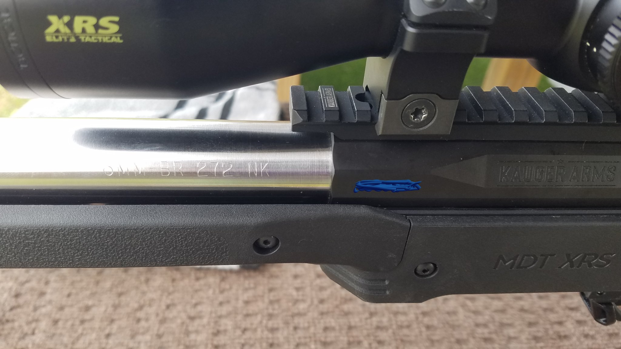

If you don't care about having the engravings timed then maybe a prefit is good enough.
Some actions have clocked threads and you can get the barrel engraving timed.
The gunsmith never touched my action. Had a barrel drop shipped to him. He did the work and mailed it to me.
