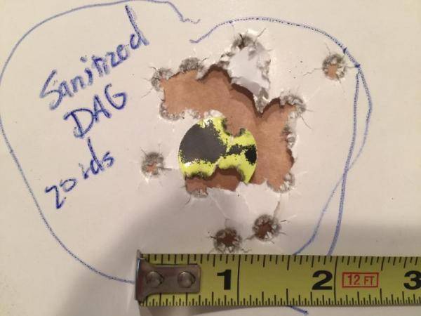

FWIW... some surplus can be quite accurate.... 20rds rapid'ish fire, 100yds.... YMMV
Here’s a thread I posted seven years ago with chronograph results for the DAG, MEN, AB Ballistics:
https://www.snipershide.com/shooting/threads/7-62x51-military-surplus-report-dag-men-a-b.71577/
The DAG was clearly the best in the bunch.

(as the weapon warmed up the spread got worse… I need to try it with the bolt gun)
Thank you for the chrono data, that is a very nice, low SD from the DAG, MEN and your reloads.
Actually pretty amazingly low for "MilSpec" ammo.
Again thanks for sharing, I had not seen your post before.
