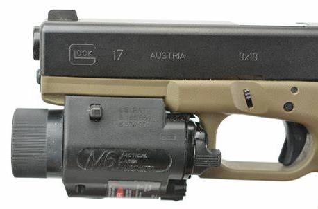

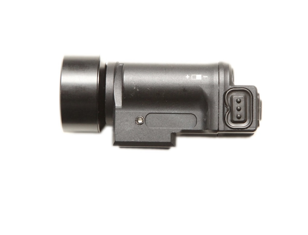

So is this unsat, or is it ok?
I’m going to have to 3D print a new plastic pic rail “key” so it will lock in the forward/back slot, but as far as gripping the actual rail is this ok, or not enough rail for this light?

Being a 9 it will probably be fine. I don’t think the brake will effect it much either
Not sure I’d expect it to take abuse really well but for general stuff it probably will hold up ok
Probably get covered in powder residue. Especially if the lens gets wet

Hold up due to the location or the rail?
Figure the MP5 ran a light in a similar position blast wise

Big question is the rail situation

Location to me looks great. I just meant if you say smacked the light on a door or vehicle etc that the mount on the light itself may fail with only a bit attached to rail.
Honestly it will probably be just fine
I mean I’ve cracked spuhr mounts before. So my worry on a fail point would be the aluminum clamp with all the pressure on one side of the screw

Gotcha, and that makes sense
But outside of taking a hit, probably would be ok without self destructing the rail or light with recoil and normal handling?
Sucks trying to find the totally correct light for that mount, I guess it’s a Russian light, which makes sense as the gun is a K-USA’s vityaz clone
But impossible to get with bidens proxy war, and also appears to only be 500l vs the stream light being 1000l
Would be the same as this setup in theory. This has been used for a long time and everyone seems happy with it still View attachment 7964174
He’s asking about the clamp only engaging on the back 40-45% of the light clamp
There’s not much recoil with the 9 so it’s probably fine. Again the kicker would be drop the gun, hit it on a door etc and shear the aluminum clamp as it’s less than half engaged and it’s the back half so anything that contacts the front of the light will have a longer impact leverage (if that makes sense) vs say the contact point being in the mid point of the light
If you have a way to make an adapter to clamp completely to the lug then completely to the light that probably be better. Would be the weak point should it take a hit.
Although nobody plans to hit something with their gun even bending down behind a barricade or exiting a vehicle etc the light will contact the ground before the muzzle device
I personally don’t think just shooting it as a range toy will cause any issues whatsoever. But most people don’t put lights on range toys

Is the recoil lug in the light against something so it doesn’t slip forward under recoil?
That’s the other thing, I’m going to have to 3d print a new plastic lug for it, just kinda wondering if there is a better option, I really like that stream light, but it somewhat feels like I’m trying to force a square peg in the round hole
