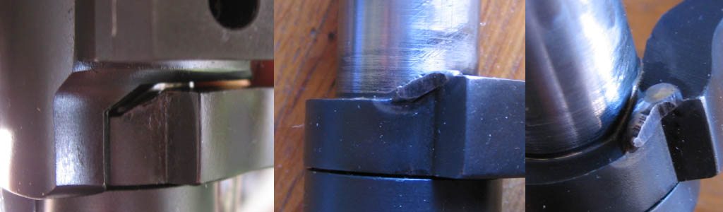

I've handled new remingtons at the store that had essentially zero cam. The proper way to fix this is to relocate the handle, but I've also been able to fix the problem by putting a small blob of weld in the right spot then grinding it down to the right shape. This was easier for me and achieved the same thing.
