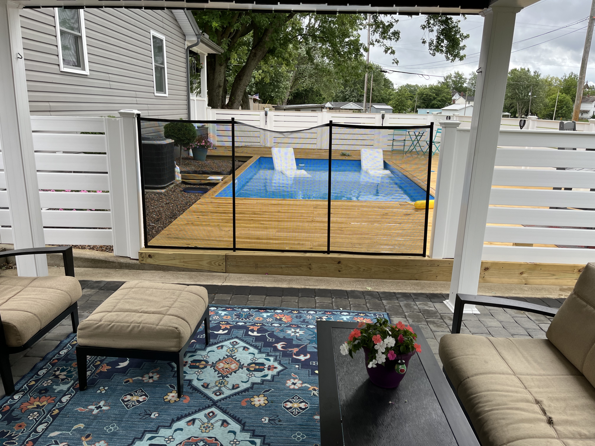

I can relate, I built an in ground pool from scratch. Naysayers said it will fail, waste of time and money, blah blah. Here it is done for pennies on the dollar. Was it a risk ? you betcha but I have a pool for 5k.
Thats a god dam nice pool lol.
