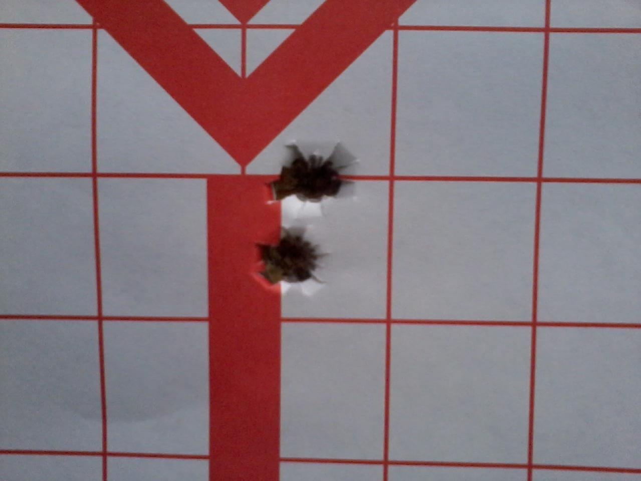

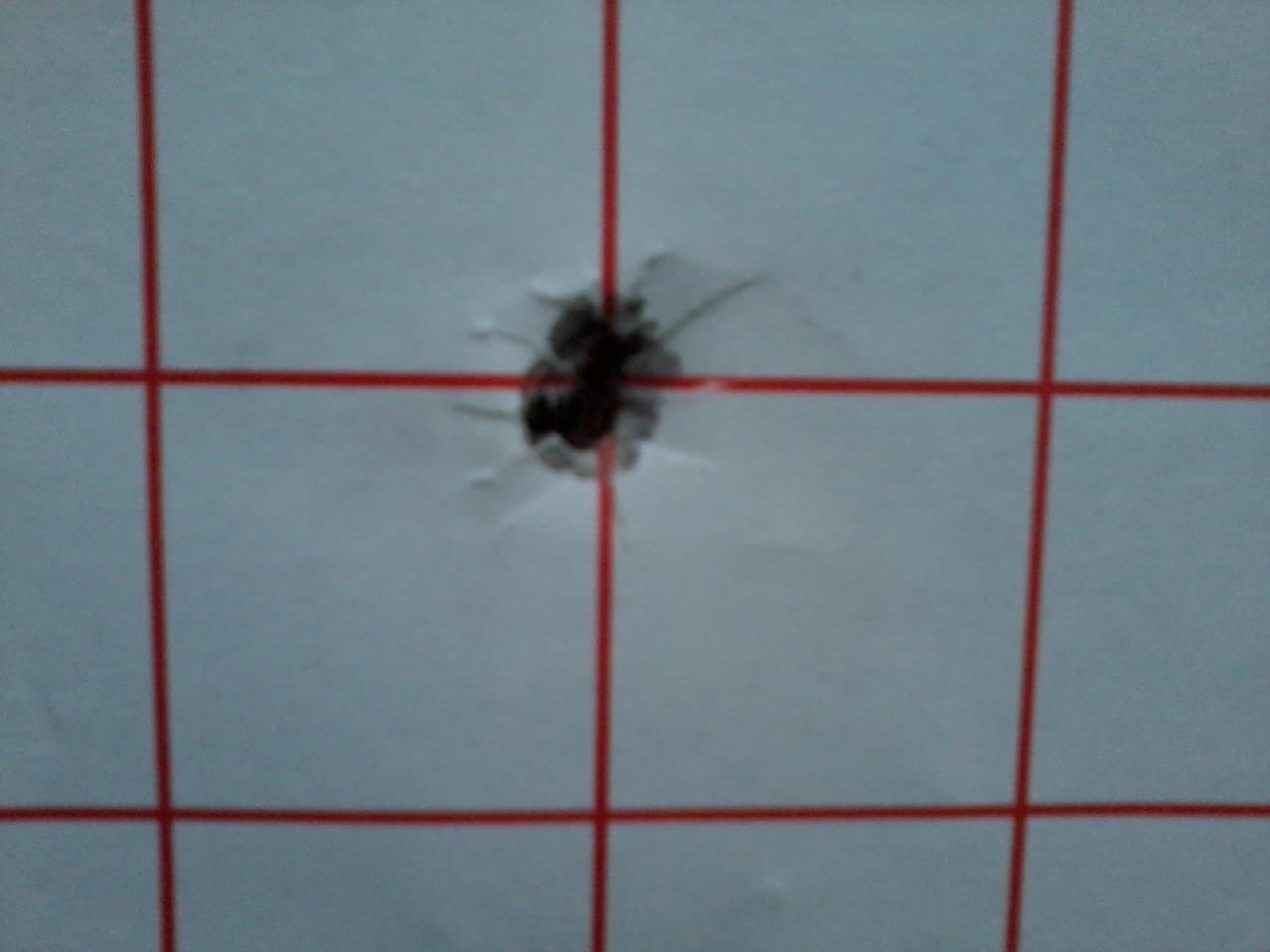

im in the middle of a runup with 300 scenars and h1000,lapua brass and fed 210m. gun is a rem 700 pss with a 6-20x50 zeiss conquest in burris xtp rings. i shot the groups at 200 from a bullsbag. these are 2 shot groups to see if anything was worth investigating further. the 5/8" grp is 88.5 and the 2 in one hole is 89.5g
i will run them thru a chrony and see how fast they are going next range trip
