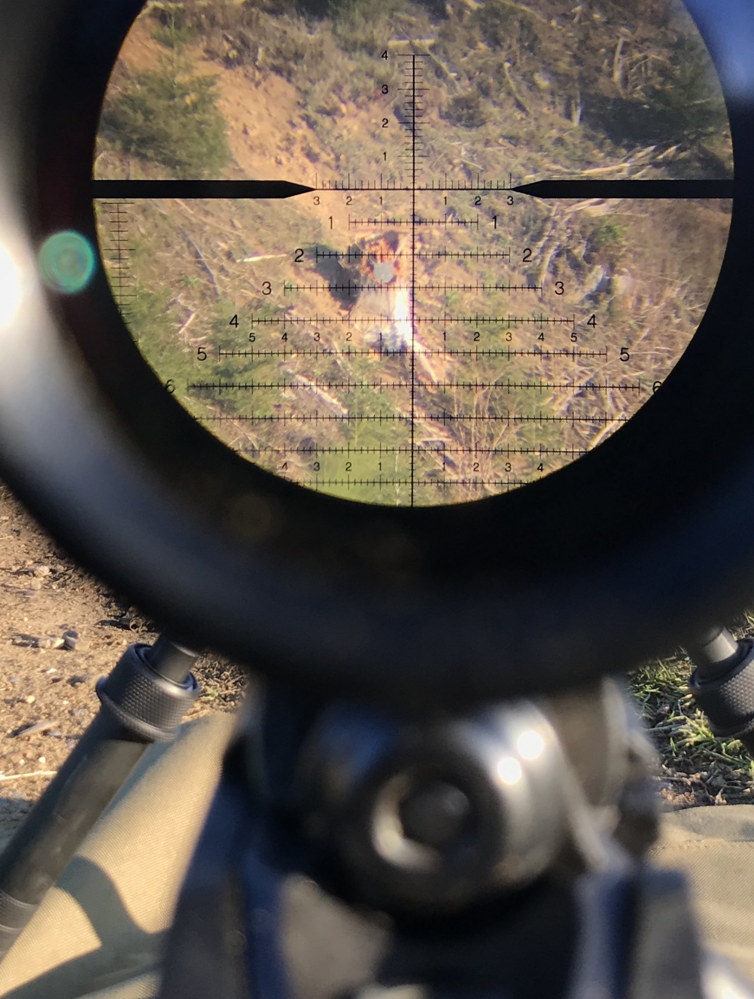

doing some research for a upcoming project...
for guys using tree rets how many mils/moa will you hold over before you start dialing elevation?
or do you only hold over until using the bottom 25% of the FOV etc?
ex:
"zoomed in" the tree only shows 6 mil below center/crosshair.
if your elevation hold is 4 mil would you dial or use the bottom of the ret, or dial up.
the more answers the better:
scenarios
with night vision
with thermal
rapid engagement
ELR
Guys who were over seas
thanks
Brian

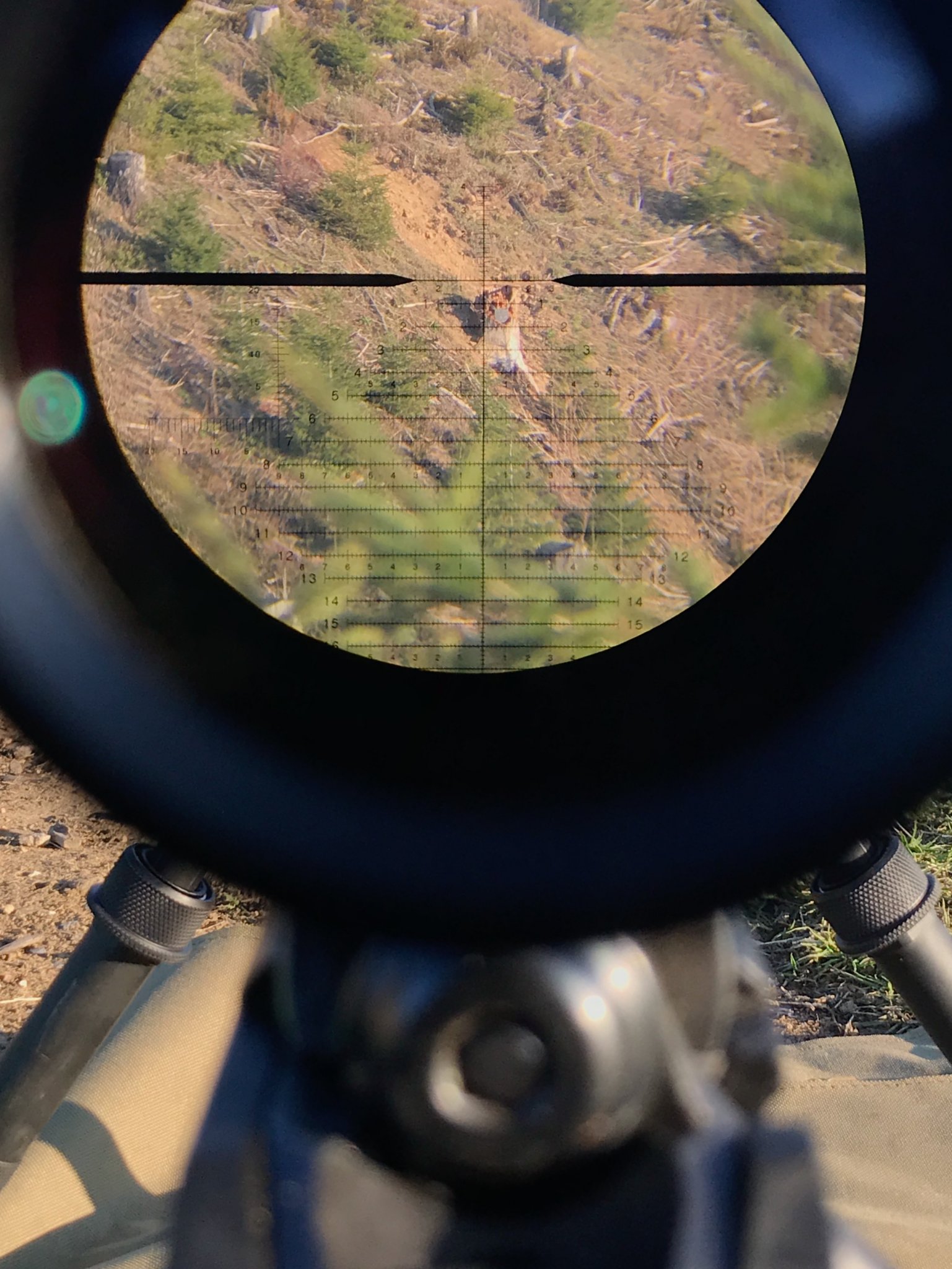

That’s correct. It’s only a $250 scope, my thoughts are that the reticle etching is probably more accurate than the tracking on this scope. I’ve used one on a 243 to hit out to 1500 yards, and only had to dial after 1200. The one I have on a 300 WM I’ve used to hit steel at 1345 yards with no dialing at all.

Shooting my 260 right now.
on max(20x) I’m comfortably Holding 6-7 mils.
on 12x 12-13 mils is totally comfortable
