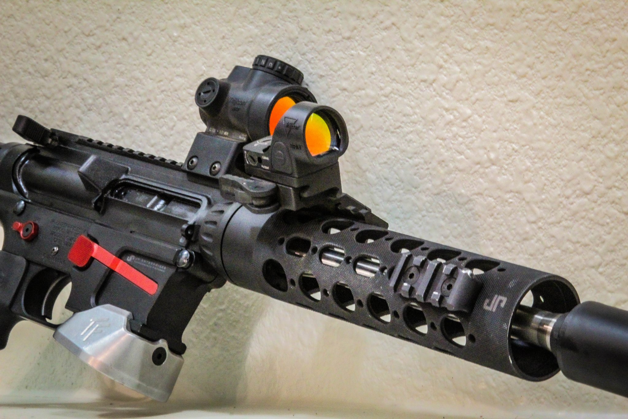

@Kwfranklin88 I love my JP PCC's. They are just like any rifle. When they are set up well the 9mm's have minimal recoil. Here's a shot of my 10.5" getting ready to shoot a night match. With the Omega 9k suppressor it's hilariously soft and a blast to shoot. I think we ran 3-4 people at that match on the GMR so call it ~500 rounds in an evening? In that configuration the rifle probably had near 10,000 rounds before it went back to USPSA configuration with a comp.
Most of the time my JP PCC's are shooting USPSA. They get loaned out at matches to folks that either want to try PCC or have a PCC go down. Since 2016 they have a couple hundred thousand rounds spread over 4 different rifles. If you want quality and reliability you need to seriously consider the JP.
Photo for the looks.
Video shows pretty minimal recoil despite being a bit rusty from the winter break.
