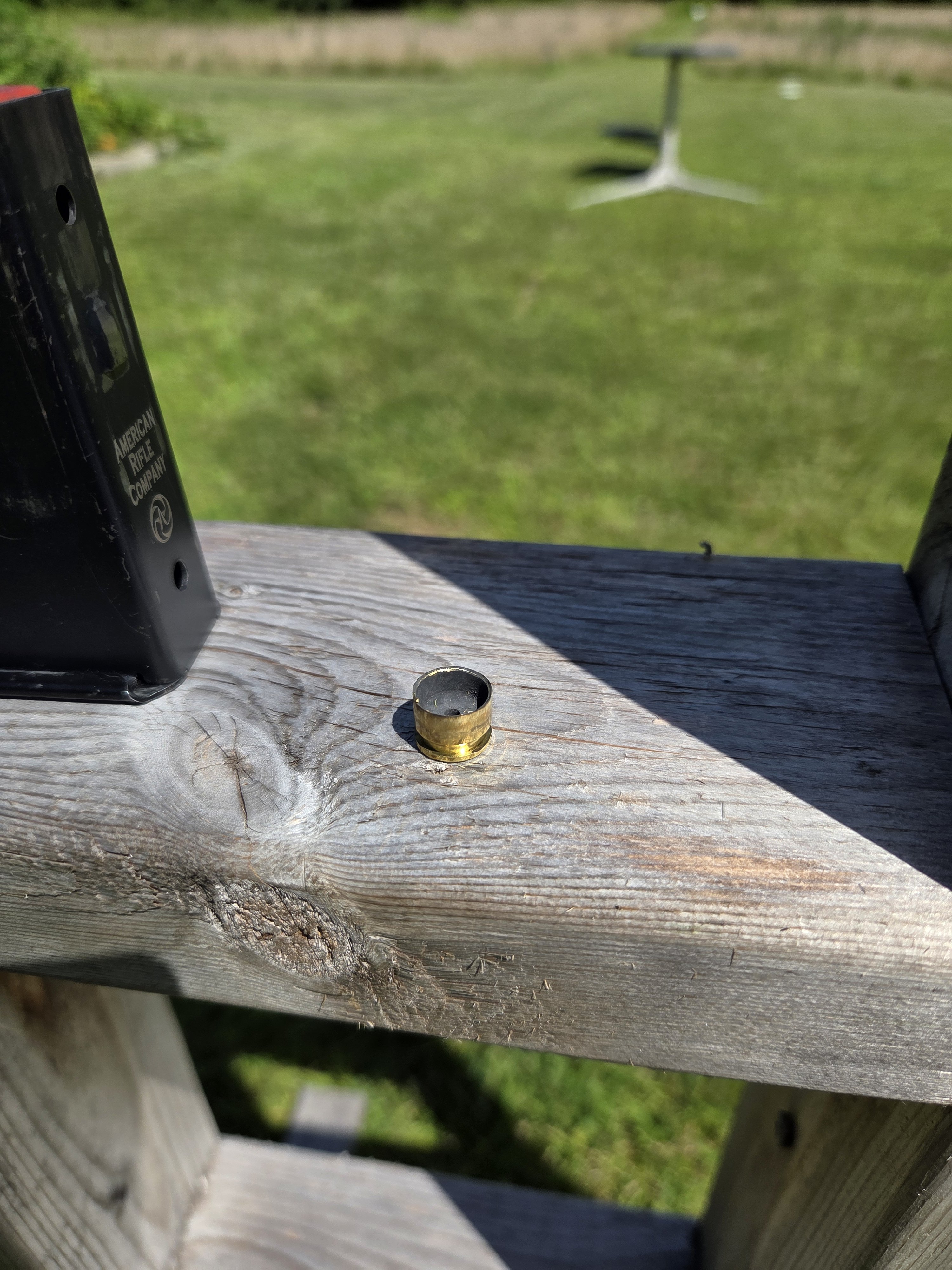

I've been getting randomly oversized brass, shoulders that were bumped 8-15 thousandth. I found 9 pieces in a lot of 340 that were in this windows. Last week I decided to load them and see what happens. Shots 1 and 2 were fine. Number 3 was not. Case separated as I extracted. This was with 6x fired 6gt.

What conditions are you looking for that tell you a case is going to rupture. The case I had that ruptured didn't appear any different than the rest of my brass other than being bumped extra. At least that I could see or know to look for.

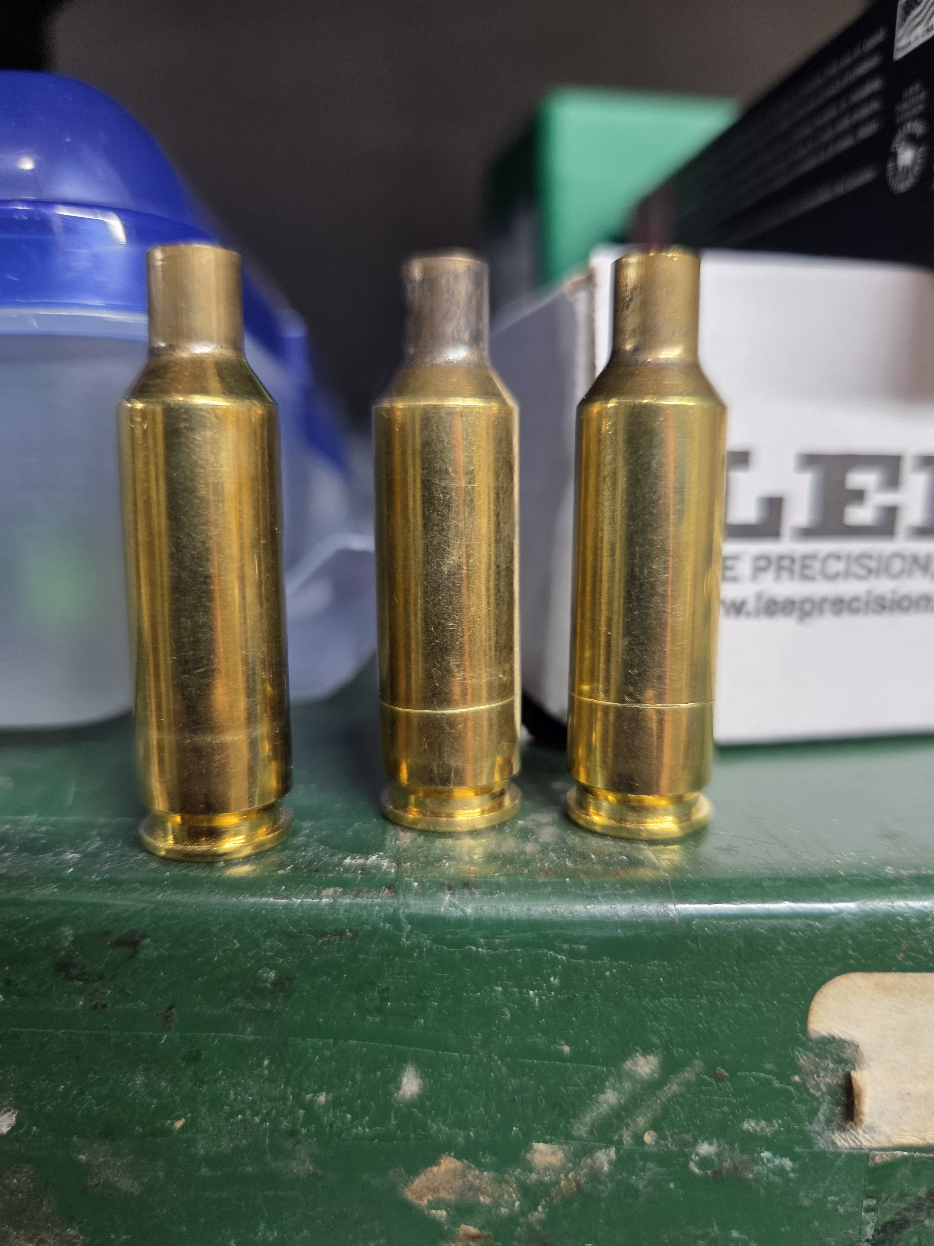

Oh boy, like before they start looking like the one on the left. Though I've also had them appear like the one in the middle too without warning, but only a few times in the past 30yrs.
Sure. I pitched all 3 of these. What I'm saying is if they dont have these lines, what would you be looking for? The case rupture I had last week didn't have these lines and I couldn't see anything wrong with it. I knew it was bumped excessively because I had measured.
Borescope the insides of them to see any premature stretching. Or the old bent paperclip method to detect the separation from the inside before it goes to the outside. I also had a Lapua case rupture once. The rupture was so clean it looked like a laser cut the case head off. Nobody could explain it, not even Lapua themselves.
