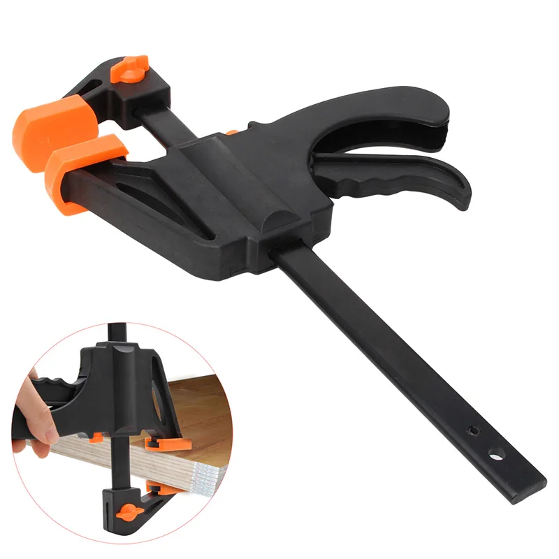

It may or may not be the right thing to do, but I'll usually use a squeeze clamp like this one to seat the action into the stock/bedding compound. My reasoning is that it eliminates the question of getting bedding compound on the action screws or in the action screw holes (I'll usually plug them with wax or something similar). I give it just enough pressure to make sure that the tang is seated firmly.
