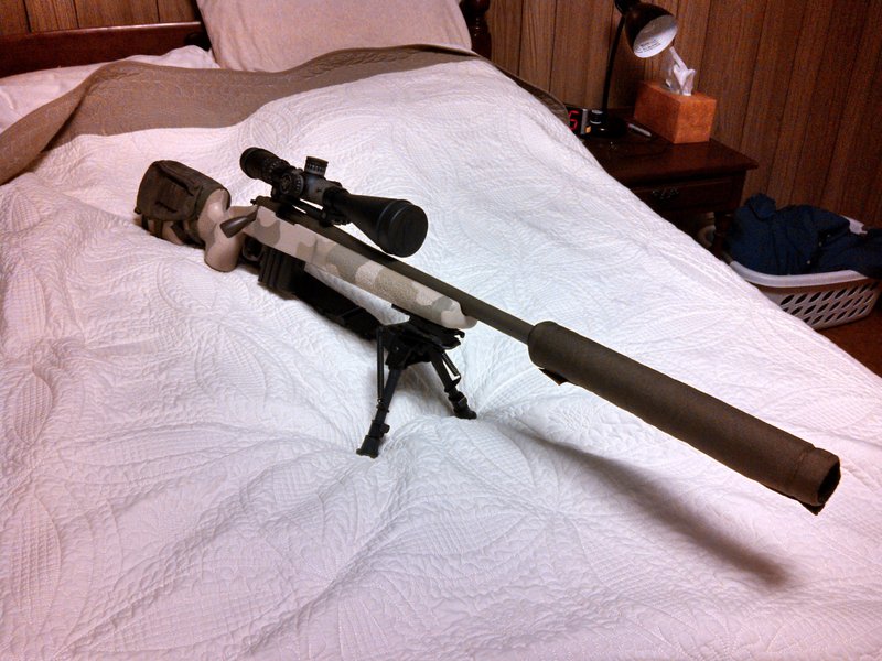

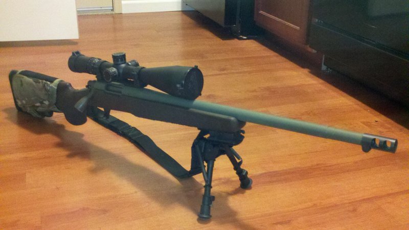

Tac Ops used to do an upgrade on R700 PSS rifles where Mike would set them back, and cut the barrels to 20" to increase the stiffness. He would still give the same 100yd 1/4moa guarantee (with FGMM 168 ammo) if they were bedded into a McMillan or Tac Ops stock. That's when I got sold on making the R700 barrel work. It ended up a solid, repectable shooter, especially when I bedded it a McMillan A5. The McMillan didn't really add that much weight. Both stocks are around 2.75-3# as configured.
http://www.snipercentral.com/tactical-operations-remington-700p-tune/
