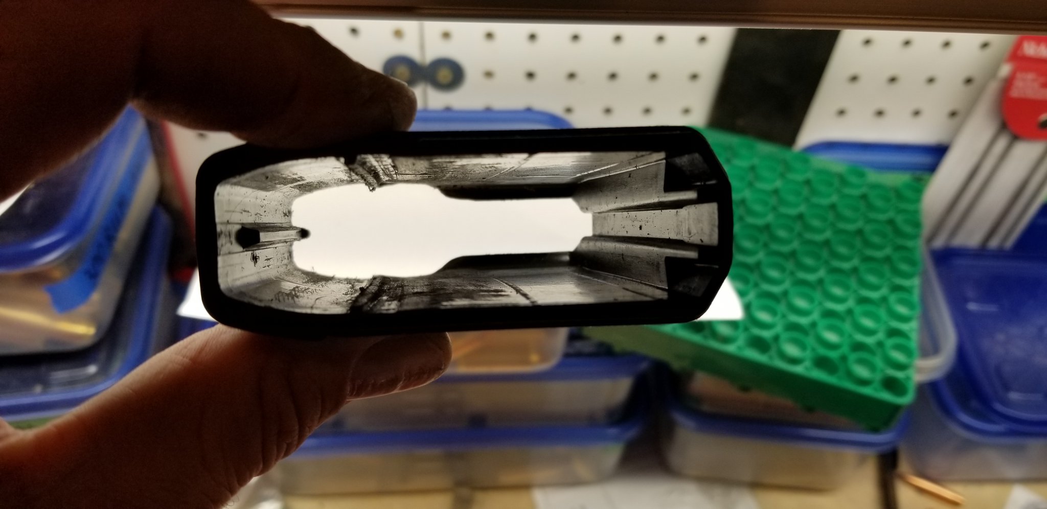

I filed the ribs off in the middle of the mag, that run from top to bottom.
Works great

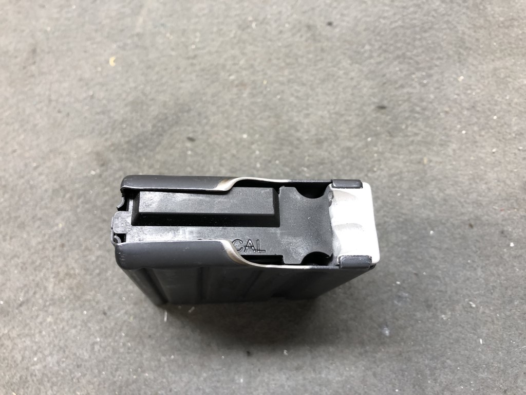

Before I hack up a PMag, are you talking about the two ribs on the inside of each side? No spacer to keep rounds from going forward or feed ramp(s) like the Medesha mags use?
A problem I saw w/ Medesha mag is it bulged when loaded and seemed like too much spring pressure. I've only got a 5 round for now. He was supposed to get back with me when he had 10rds but never did and I just let it go.
This is a view from the bottom of the mag
I'm not using a spacer in the front of the mag, because I'm using longer high BC bullets that so I have a @2.7" COAL.
So they fit and feed from the modified mag pretty good.
The shortest loaded round i can reliably feed from the mag is @ 2.35 to 2.4" long. Any shorter and it jams.
