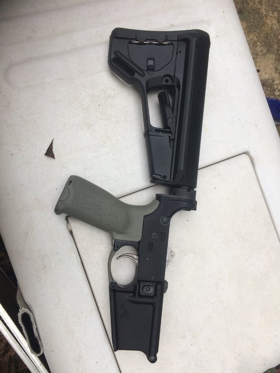

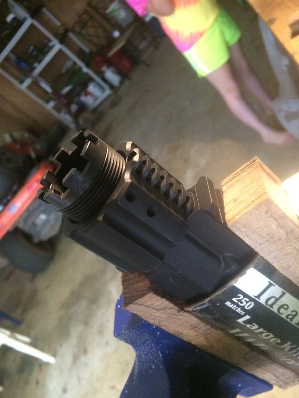

I've got the lower complete, chucked a scrap of wood in the vise to use as a block and whipped everything together. A brass punch and a 2-lb works just right for putting some torque on the RE nut. The friction lock on the ACS is nice, and the stock itself is chunky without being heavy. The BCM mod3 is a little more vertical than others, is fatter, has a nice attached storage cover, and is stippled tastefully.
The last parts will all be in this week so stay tuned to watch a slack-ass mill hand build a gun. There will be bonding agents and hammers.
A pic of a boring lower for your enjoyment:

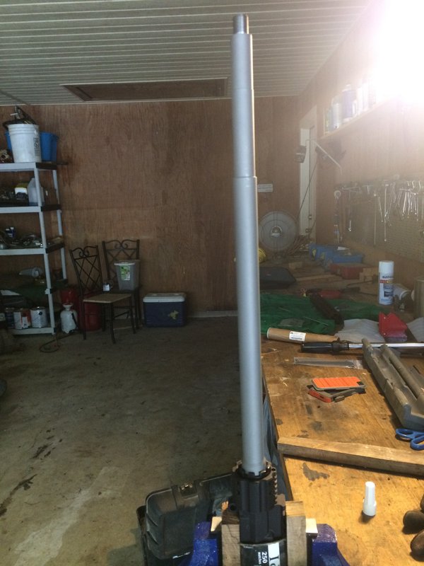

6/13/17 Update

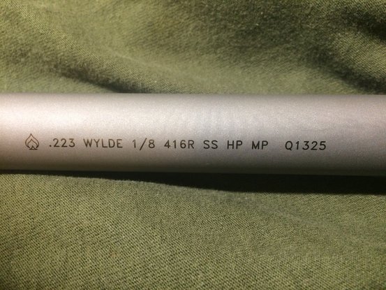

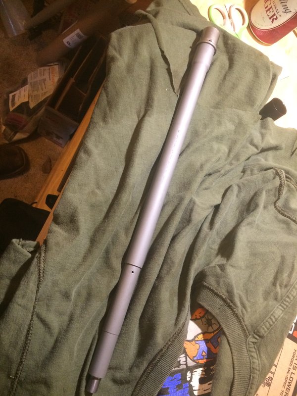

The barrel and BCG came in last night. Barrel is pretty nicely done, bead blast looks good, machine marks are minimal. The barrel extension appears to be coated, or at least feels pretty slick and the lugs/feed ramps have been smoothed out. No-name gas block fits nice and tight.

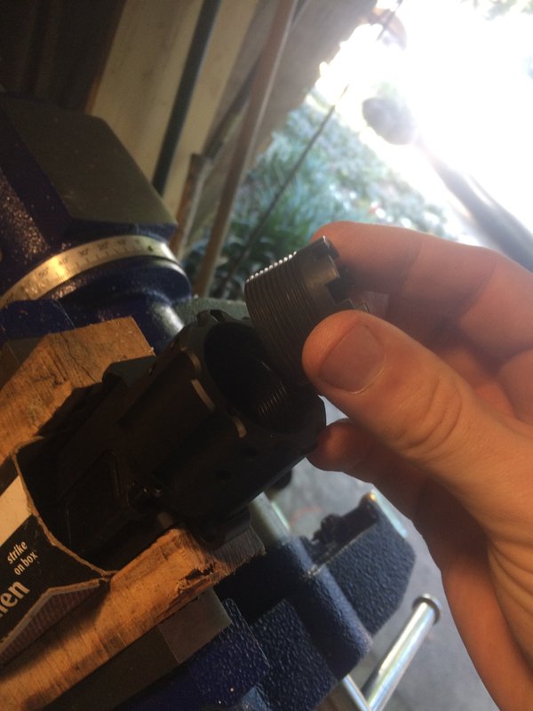

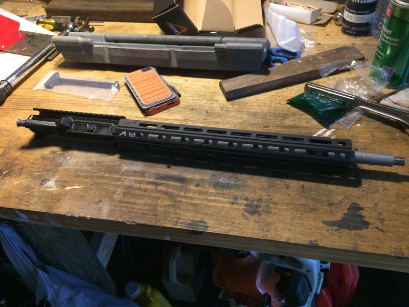

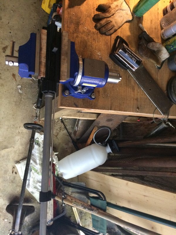

6/15/17: The upper build
The M4E1 is a pretty slick setup, I think. I'm not Mr. Worldwide AR Armorer extreme, but it certainly looks like a stiff setup. The barrel nut has male threads that fit inside the extension forged as part of the upper, and a wrench is included. You'll need a 1/2" square drive to use it. The threaded extension on a standard AR upper looks to be the weak point, with the undercut and all, which this design eliminates. Also, it looks like you get close to double the thread engagement of a standard upper. (Disclaimer- not a company shill)
Used 609 under the gas block as well. I think the tolerance may be too loose for it to work properly, but I can't help myself. Pardon my disaster of a garage. Science says I'm a genius: http://www.huffingtonpost.com/yourta...b_8579478.html
8-T20 screws on the handguard, and we're all done but for the muzzle device. I'm preparing my anus for the TBAC CB mount.
Two pins, and boom, Legos for adults. I'll definitely come up with something lighter than that gen 2 razor for this gun. It's awesome, but weighs near half what the gun does. I'm thinking on trying one of the athlon scopes for this project, but we'll see.

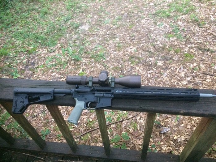

7/1/17: Range Day!
Needed the Razor for my .260, so I put an old bushnell 4-12 rimfire scope on the AR and grabbed a few boxes of winchester m855 and some monarch steel cased 62gn 223 (5.50 a box!)
With the m855, got near-moa groups during sight in and had no trouble at all hitting an 8" plate at 400 with kentucky windage. As an aside, the duplex reticle in that scope is almost exactly 1 mil from center to where the reticle tapers up. I got a 100 yard zero at the center and 400 at the bottom plus a hair. Handy enough as is to tide me over til i can find a deal/recover the gun fund to get something better. Ive got my eye peeled for a used bushnell 3-12 lrhs.
Had several failures to lock the bolt with the steel cased stuff, but it was flawless with all the 5.56 spec stuff. Ejection with 5.56 is at 4:00 in a neat pile. The PSA nickel whatever plated trigger is surprisingly useful, may get some lighter JP springs for it. It's not crisp by any means, but it is head and shoulders above a parts bin mil spec rip cord.
Overall, I've got pretty high hopes for this gun based on that quick experience. I've got some 75 gn hornady steelmatch and black hills reman 77 smk on the way.
One of my design criteria was cheap factory ammo, but the Nosler 70 gn RDF has my attention as a contender for the local precision rifle club matches...
We shall see, but so far this ballistic advantage barrel is getting 5/5 stars from me. It's more than accurate enough to teach me about the wind without burning expensive components and barrels.
