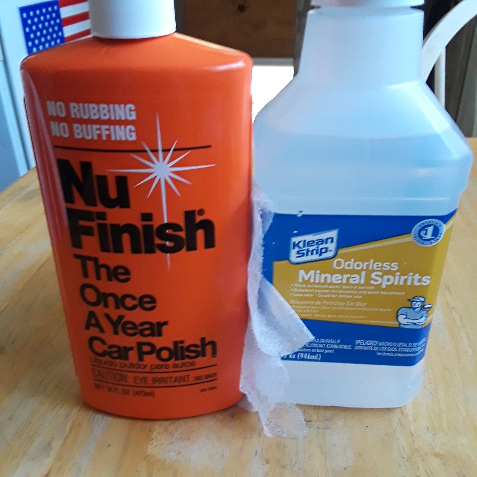

ETA if you’re set on dry tumbling I added about a teaspoon of mineral spirits and a squirt or two of nufinish to my media and it seemed to help get rid of the carbon.

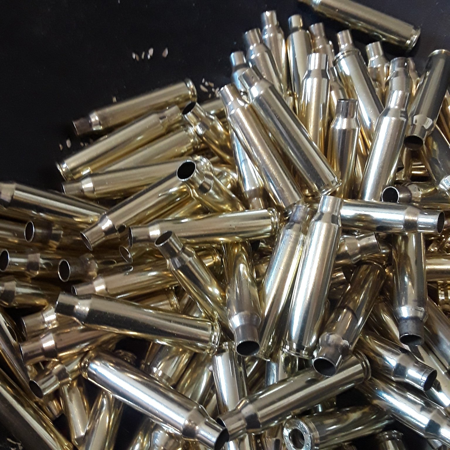

I dry tumble in “lizard litter” from PetCo in a harbor freight vibratory tumbler. Always before sizing and decapping. But, the lizard litter is fine enough that it doesn’t get stuck in flash holes like standard crushed walnut has a tendency to do. Just throw it in and let it run overnight. Generally comes out sparkly.

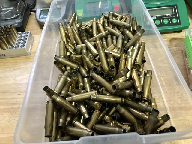

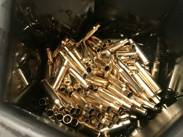

Brass from my MK11 shot supressed.
before
After
All brass looks like the “after” with appx 2-3 hours time in the tumbler.

Nufinish / mineral spirits / walnut lizard bedding and a used dryer sheet. Mix the wax and spirits in a condiment squirt bottle first. 4 full round the bin squirts and let it mix well then add brass.
Passes through the flash hole.
Clean shine dry gtg.
