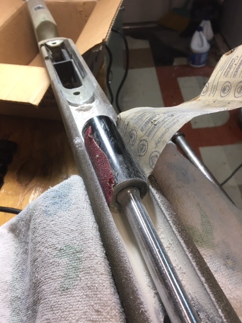

How are guys cleaning up stock barrel channels in front of the bedding. The little sanding drums leave all kinds of little grooves. I don't have a Cnc, but I do have a manual mill. Any ideas?

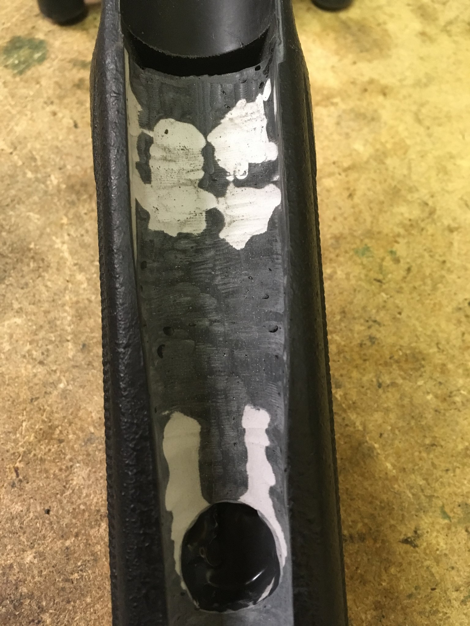

Anyone tried to bead a barrel channel full length ? I have a older McMillan with a 10 MTU channel was thinking about wrapping 20 mil tape on the barrel and bedding it to a varmint taper barrel.
This would work on the OP's stock if he was bedding the action area at the same time.
1. Going to be a mess, but it's possible
2. going to add a lot of weight because the bedding epoxy is a lot denser than stock fill
3. going to take a lot of time to clean up after you pop it out, and going to be a lot harder to pop free.
