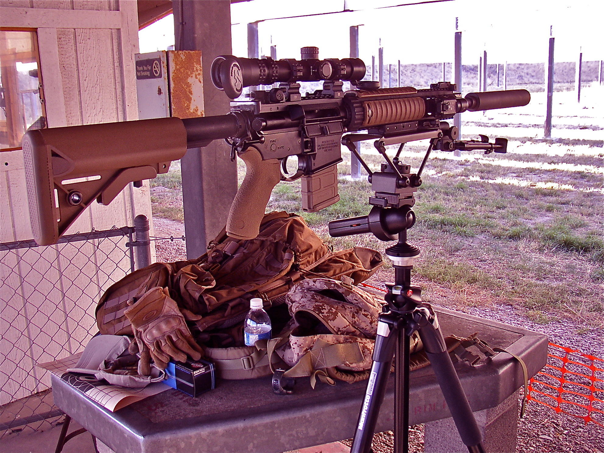

Consider a Centurion or High Caliber Sales RECCE rifle upper or a .308 LMT, GAP built rifle or the like. A bolt gun will be more accurate, a semi more versatile. Clearly go for an 18" stainless 1:7 twist barrel if you build a 5.56 A Geiselle SAA-E trigger merits looking into. This is a Mk12 Mod01 that is solid out to 600. I have shot it out to 1200 yards, but it is hit and miss after 900 yards. If you want a good crash course in marksmanship, go see a Marine Corps recruiter. Or follow the links above.
What tripod setup is that?
Looks interesting.
The tripod head to rifle interface, in particular.
Shooting 600 on steel is not a problem at all, hitting it or calling hits. Here is a video of me shooting a 8" plate that is 3/8" AR500 hanging at 500 yards with mine and you can see and hear all the hits. Yes I missed the 4th shot but I wasnt exactly trying my hardest with the iScope on the rifle. Just follow the links and practice the fundamentals and you will start seeing results.
