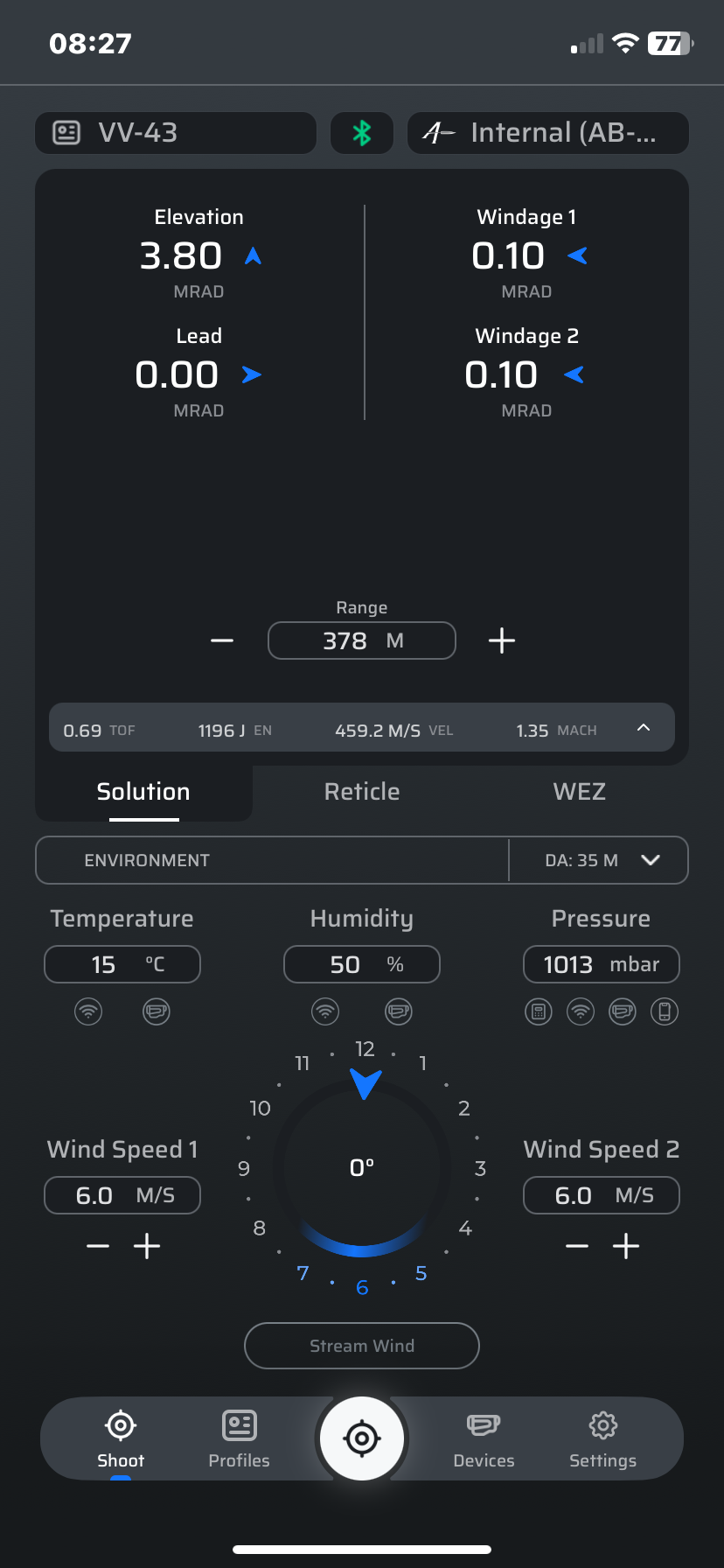

My Kestrel 5700 Elite connects via Bluetooth with the app, but the pressure, humidity, and temperature values do not update when I click on the device buttons. I also tried reinstalling the app.

As shown in the photo, the Kestrel is connected (Bluetooth on and live environment), but it is not reading data from the Kestrel 5700 Elite. When you press the device buttons, the same values always appear: 15°C, 50%, and 1013 mbar. Wind speed and direction are also not updating.

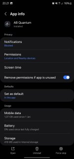

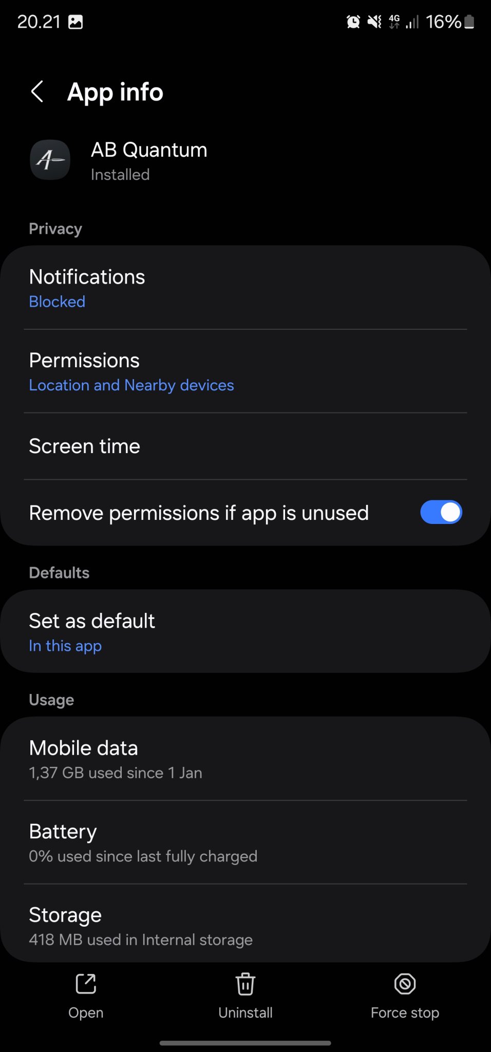

I had the same problem with profiles not loading nor uploading. It just stalled downloading and uploading showed it did something but kestrel never knew about it.
The quantum also had used 1.4GB of data.
I reinstalled it and in short order it had used another 500MB of data.
All foreground, background data was few KB.
I uninstalled it for now.

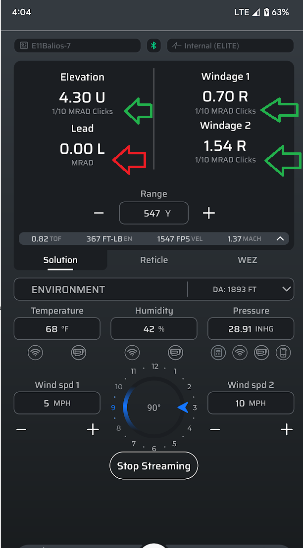

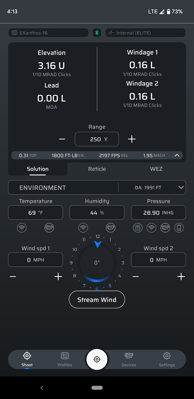

This bug appeared only on profiles that were received from the Kestrel, despite the Eunit and Wunit for these profiles being set to mil in the Kestrel 5700 Elite Ballistics. I have not been able to recreate these issues in any profile created through the AB Quantum app.
Profiles ->Scope -> Scope Units - any changes made to scope units do not save properly. Seems to want to either default to MOA most of the time. Profiles that were properly received in MRAD will default to that despite changing to something like 1/10 MRAD Clicks
On random occasions, profiles that were received will have weird mismatched scope unit solutions when scope units are changed.
Examples in pics, where the scope unit was changed from MRAD to 1/10 MRAD Clicks or changed from MOA to 1/10 MRAD Clicks and the units for the solutions are mismatched.
These bugs still appear after restarting the app after saving scope unit changes.
