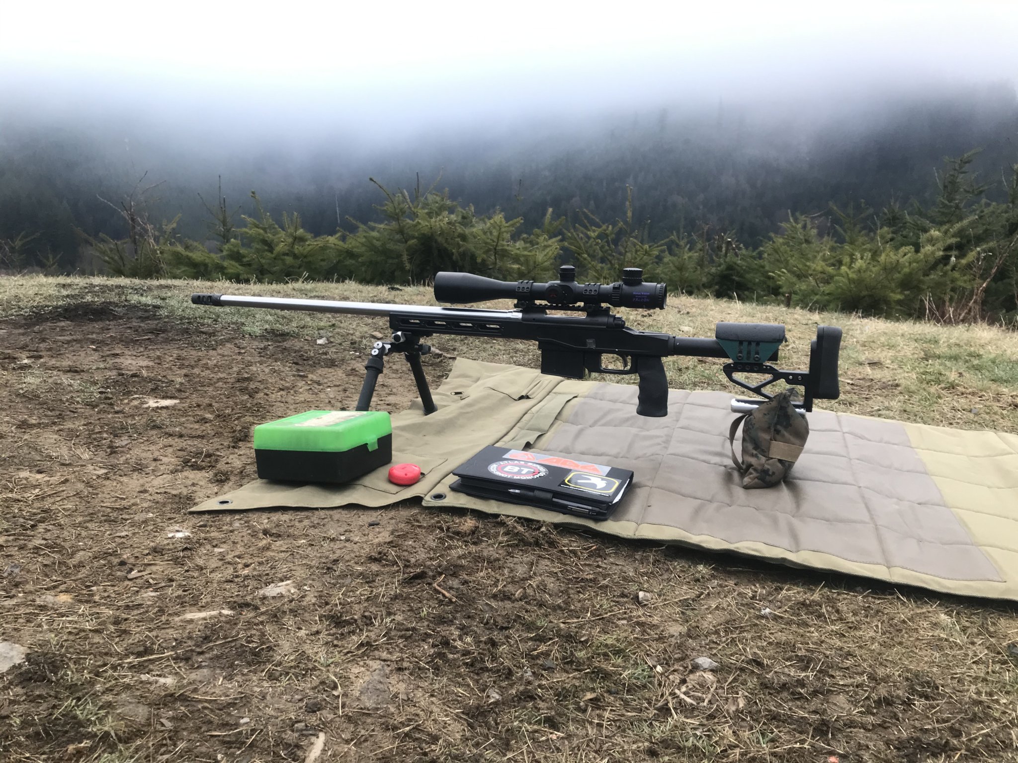

You could build up your 700 up like my 260 savage.
It’s 13#, capable and pleasant to shoot.
1000+ yards is easy
Chassis/stock
Trigger
Remage barrel in 6 or 6.5mm cartridge(or the awesome 7-08)
Brake
Scope
happy pew pews after.
You could easily lose a pound or more with a light Palma barrel and modern scope instead of that old steel bodied dinosaur on my rifle.

That looks like almost exactly what I'm after. Is that an XLR chassis? I've had my eye on one as well, could even have the folding option on the standard element and be lighter than my magpul stock, yielding a more portable setup
She sits at ~10.5 pounds at the moment sans bipod, with the 10x SWFA. If I went with the XLR, something like Hawkins long range hybrid rings, and ~25oz for the optic, I'd be right at the same weight if my math is correct.
Seems like a really workable set up. Maybe down the line rebarrel it with a nice carbon wrapped barrel and maybe shed some additional weight from the varmint profile and change calibers in the process to something a little more suited to long range (6/6.5 creed, 7-08)
Yes
XLR element.
It or a KRG bravo would be my first choices.
It’s a very pleasant and effective rifle, I even named it Buttercup.
They make a light version of that chassis now as well.

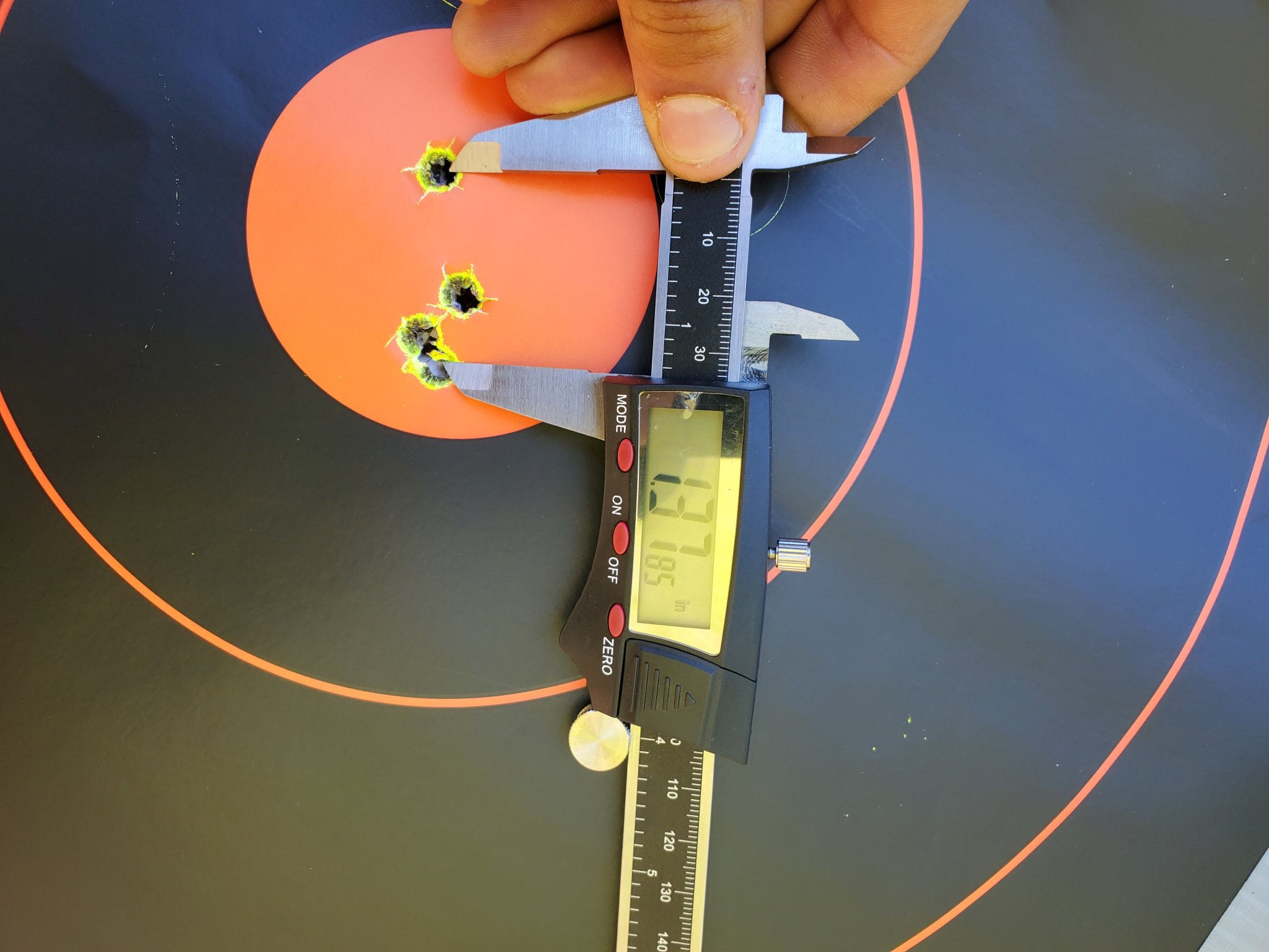

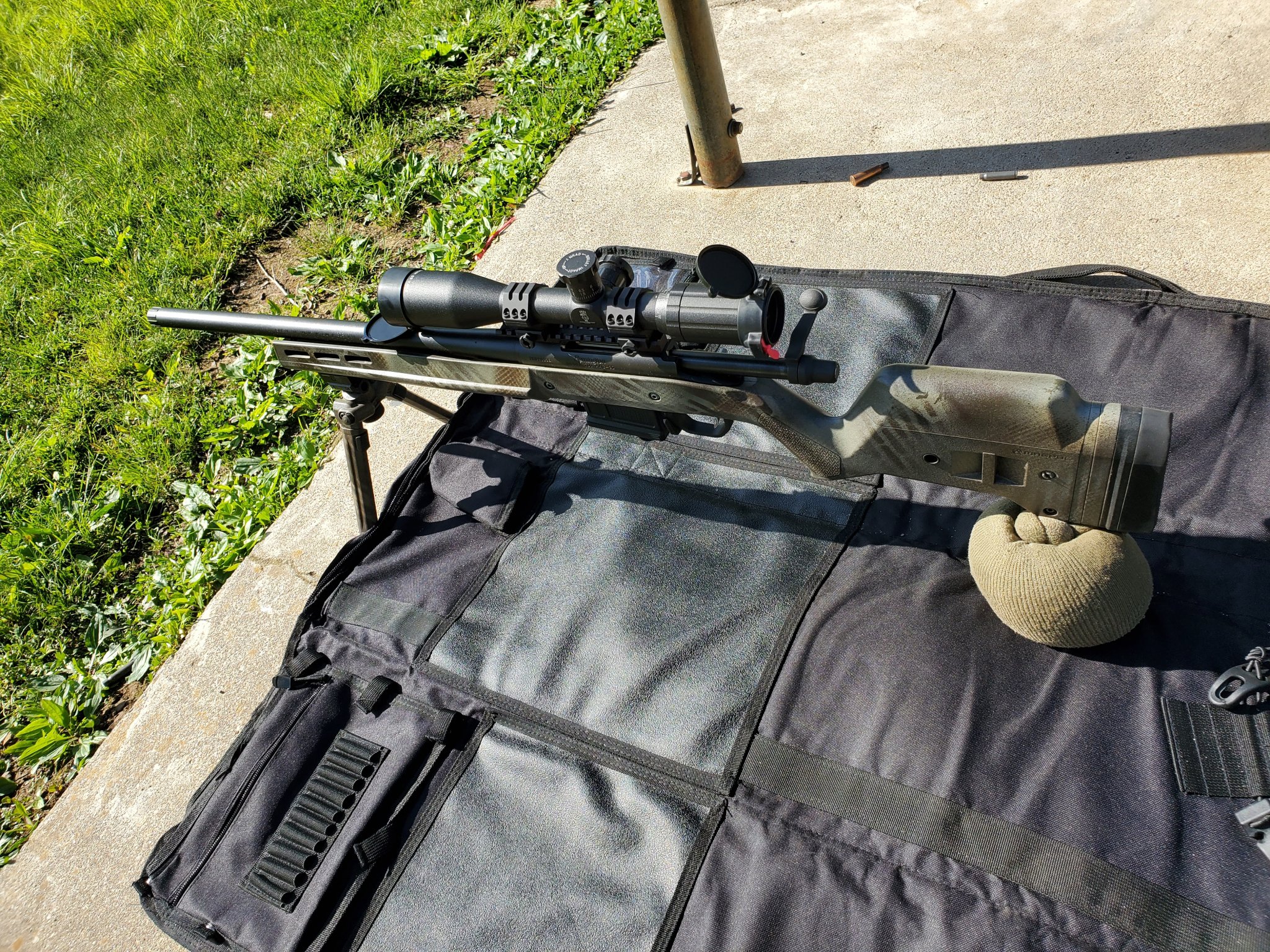

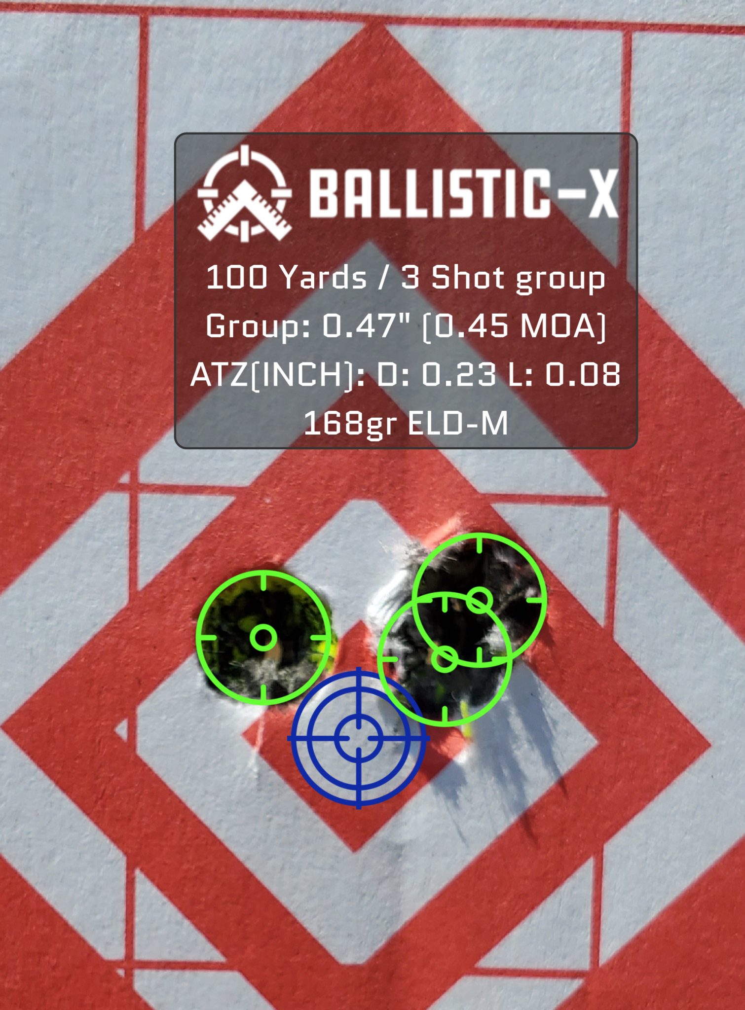

Here's how it sits at the moment
And 4 shots at 200 with m118lr

I have a similar rifle.
- 700 5R, .308, 20" barrel
- Harrells Precision brake turned down to barrel contour
- Jewel Trigger
- KMW Loggerhead adjustable cheek job
- Vortex Viper PST Gen II 3-15 x 44 with mil reticle. Vortex stuff seems to go on sale a lot. This is the EBR-2C. Now its the -7C. Very similar and I was fine with getting the -2C at half price.
- Leupold Mark IV medium rings (they don't have "low" and their "medium" is as low as I have found in steel rings at .84" to center")
- Harris bipod
And like yourself, I feel that I got a good barrel out of Remington and this gun shoots very well. I'm really very happy with it.
When we had the action of the HS stock for the comb job, I had it skim bedded when we put it all back together. I think this probably did the most to tighten the gun up as the wear marks on the bedding block were just very small areas around the action screws.
Look, I'm not one of the highly experienced guys on the Hide at all. But I do have a 6.5 CM in a JAE-700 chassis and that is a target gun only and completely unsuited, IMO, to hunting.
The Remington is fun, fun, fun to shoot at the range and is accurate enough to challenge me but its still a deer gun for those few times at 68 y.o. that I get out to hunt one.
I know that guys here hunt with chassis mounted rifles but to me, they are target guns. I like a stock for hunting.
If you want to stay in a chassis, and want to upgrade from the Magpul Hunter, I think you got a lot of input above. But to my mind this 20" Rem 700 belongs in a stock. Personally, I would look at Manners/McMillan over a chassis for that gun. It will shoot great at the range and should be very nice for hunting (depending on what stock you get).
Just thoughts from sort of a novice: take what you like, leave the rest.
