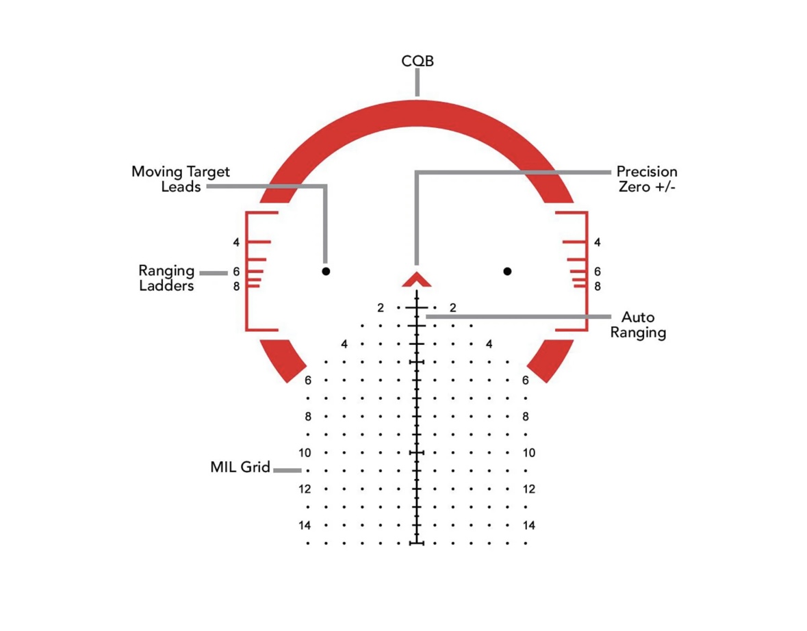

Primary Arms has ranging features for man sized targets on most of their ACSS reticles
My fav from them. ACSS Griffin
Daylight bright.
