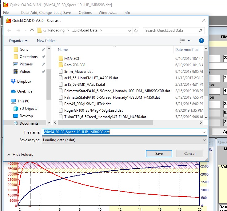

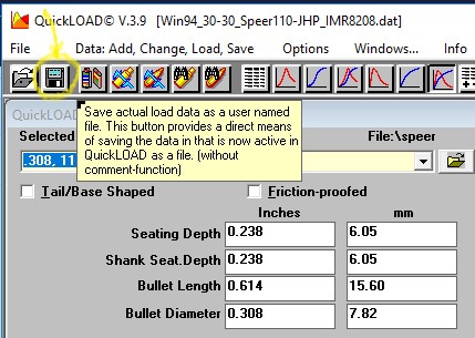

On the toolbar, 2nd icon from the left, is a Save button.
7096850
Click it, and a Save As window comes up. You can then Name the file and navigate to whatever folder you want to save it in.
7096851
FxDrider got it. Next time you want to work on that file just open it within Quickload and tweak to your hearts content. Might want to save a copy though, Incase you want to revert back.
