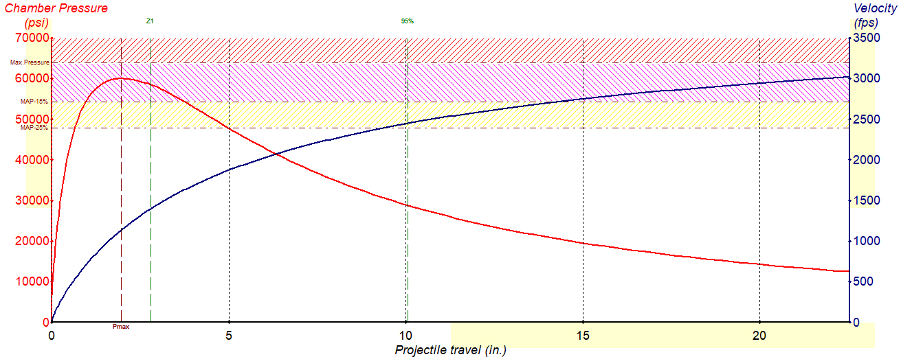

From the specs that I received: QuickLoad says that 63 grains of RL16 yields a 102.3 percent fill. Just slightly compressed. (A 100 percent fill is at 61.6 grains).
63g: Pressure is right around CIP max (63,817 psi) at your COAL/case capacity (take this with a grain of salt - could be roughly 7K+ higher if jamming into lands, etc. - plus temperature/lot variances).
Not bad. I'd run with it if you get acceptable performance out of it and it's a hot-weather load.
