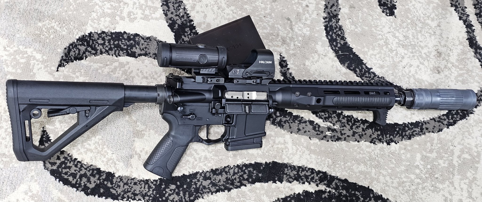

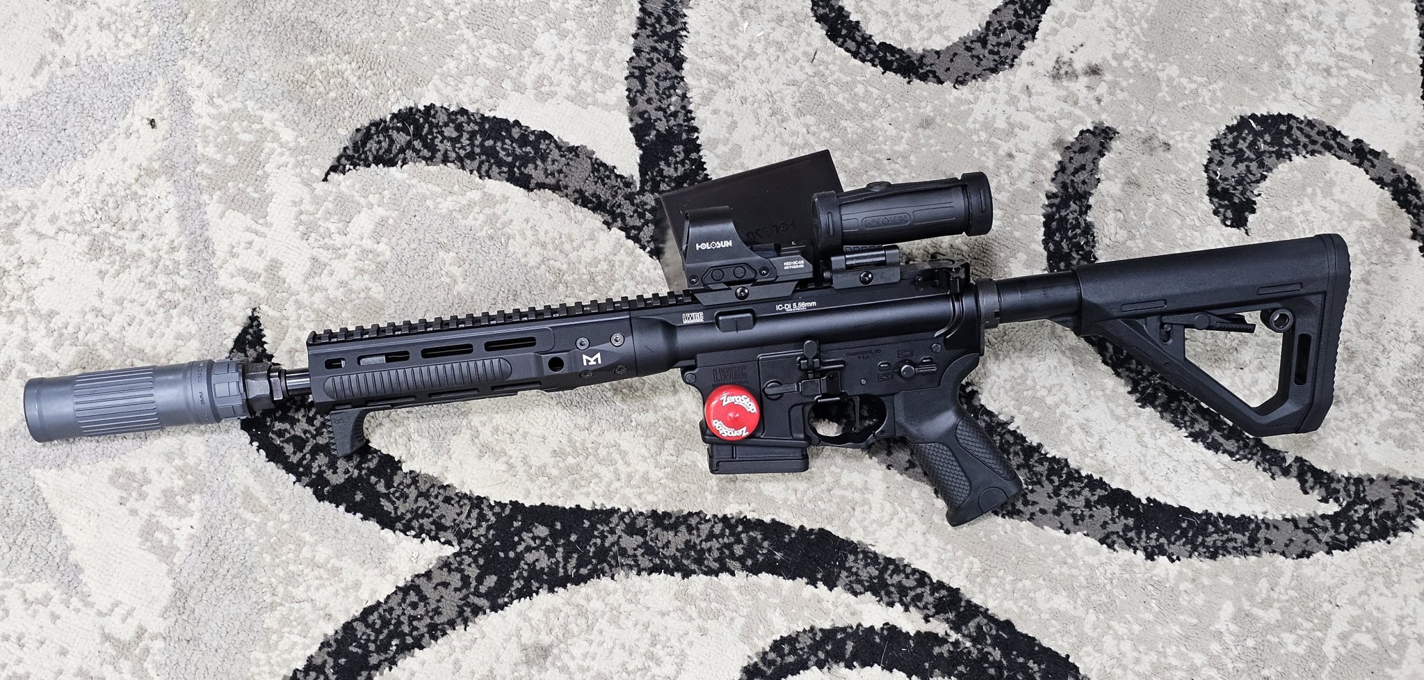

I just picked up a 10.5" Carbine gassed SBR LWRC DI, and it shoots flawlessly suppressed and unsurpressed but even with the low back pressure Lazarus 6 it's still kicking back a fair amount of gas in my face. I pulled the pinned gas block and installed a SA AGB and put it in Bleed off mode, aslo installed the Silencerco charging handle and now it's a smooth lady.

She's beautiful. I have a LWRC DI build to do next year, but I think I'm going to do a 16" build. Is it still heavy despite being a 10.5?
8 lbs 7oz as shown, take the 3x magnifier and the Lazarus off and she sits right at 5lb 12 oz.
Love everything about these LWRC-DI Rifles and they just flat out work, have three of them now and have never had a single malfunction. Outstanding Ambidextrous controls, rock solid lockup, easy Sub MOA accuracy and $1,400 OTD.

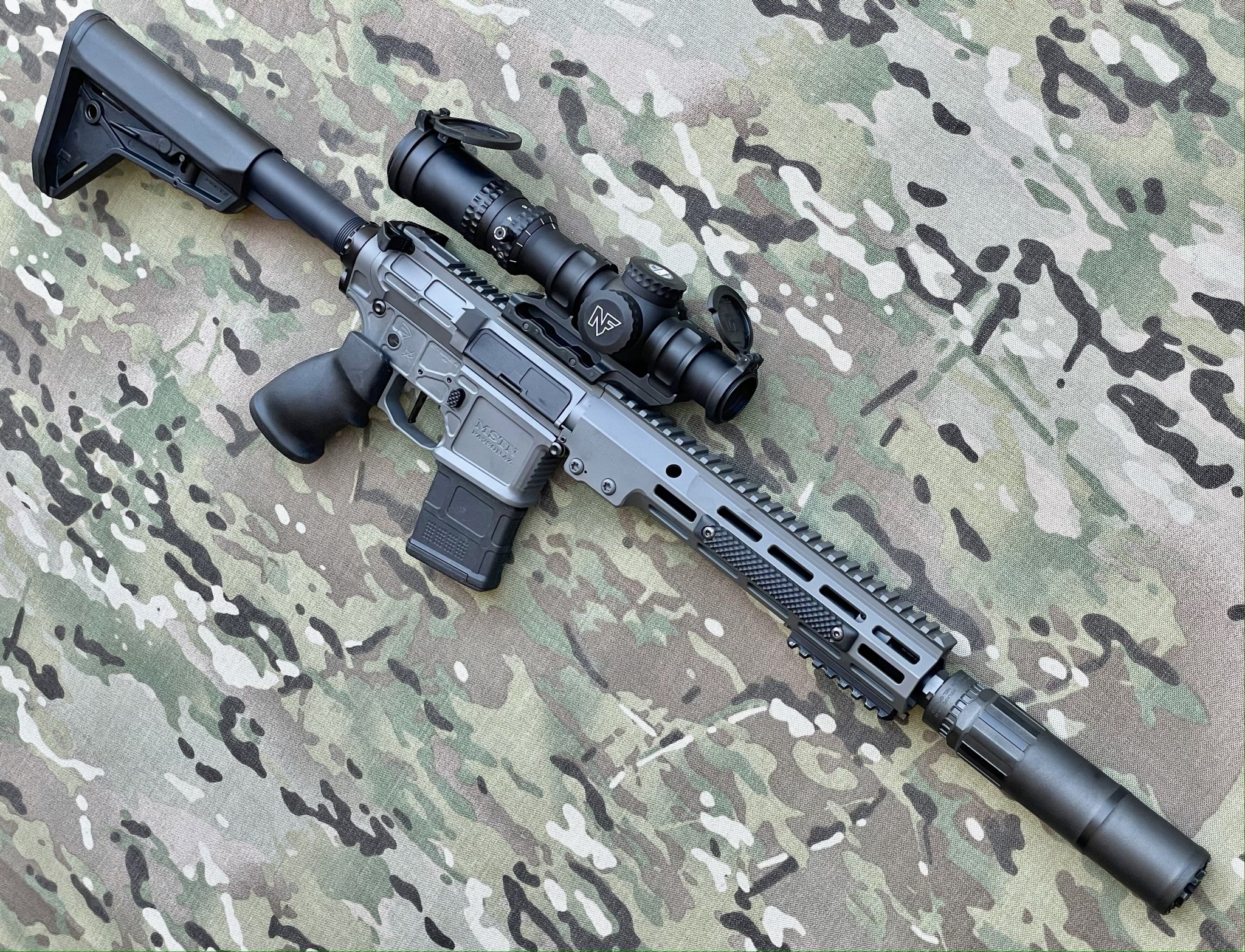

Here is one of the 16" versions that I run damn near daily.
What muzzle device is that?

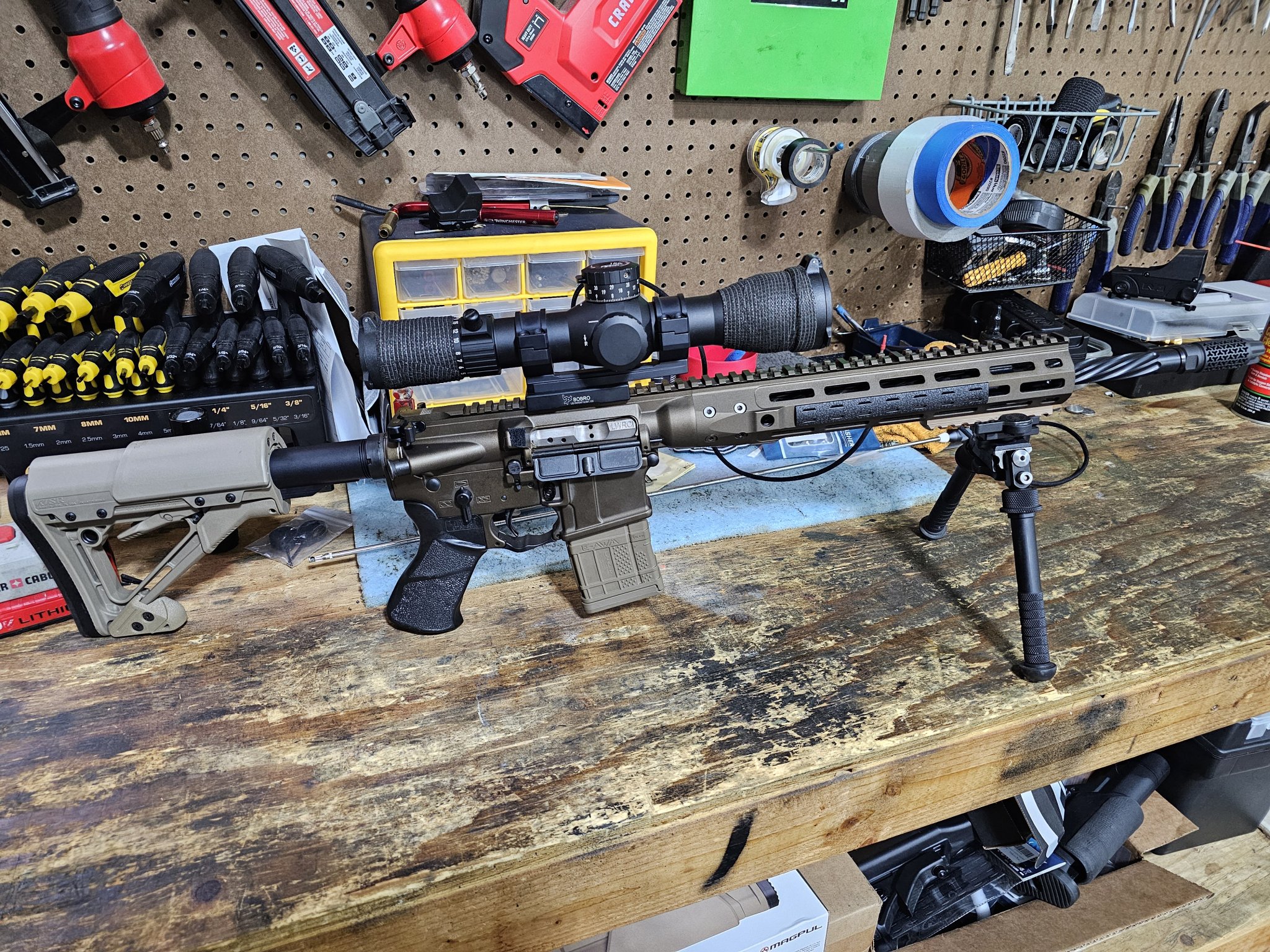

I have an 11.5.middy I put together with a cheapo faxon barrel. I run it with a nomad l for deer season in somewhat urban environments. Sounds great with a h3 and a superlative blow off gas block.
Nothing about it is a combat kinda deal but it's super fun for hunting inside 300 yards which is all I ever do in the SE. I don't think full house 556 pressure loads from an SBR can get any quieter.
I have the e brake on it and it's identical in length to an 18" with an a2
