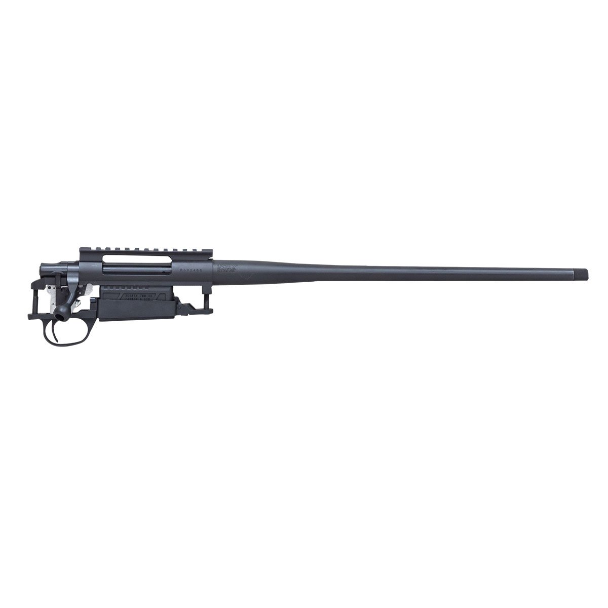

Hi all,
I am planning to buy this Howa 1500 22" heavy bull barrel SA .308 https://www.brownells.com/gun-parts...308-winchester-barreled-action/?sku=430103508
Just curious what you all would recommend for chassis/stock?
Primary use for now will be learning fundamentals of shooting at different distances. So primarily it will be used at the range.
I am considering these:

I am an all around noob when it comes to all of this so I relying heavily on research and recommendations. I haven't even started down the rabbit hole of glass yet lol. I recently bought a Primary Arms SP 1x6-24 (originally purchased for my AR-15 style rifle) that I will probably put on it in the mean time until I figure it out.
I am trying to keep cost down as much as possible without sacrificing quality and functionality as far as the stocks go (So I can put the extra money into quality glass at some point). I'd like to go with the LSS-XL and get a buttstock, but I think you also have to factor in a grip too which all together would have me over $1k just on the chassis/stock. I think for now since I am just learning and starting out I can probably go with the Oryx (although I wish that one had the M-Lock rail) or XRS.
I originally wanted to get the 24" barrel:
22" Heavy Bull Barrel:
but someone on a different site pointed out that the 24" version is a varmit heavy barrel instead of the bull barrel. But looking at their weights the 24" appears to be heavier. I guess I don't see the difference between the bull and varmit. Wouldn't the longer heavier barrel be better?

I just took a look at the first link, that is a standard weight barrel, for your use, you'd be better with a heavier profile.
Bull/Varmint are the same thing as far as I know (in regards to Howa barrels), they are fairly beefy.
With a .308, you're not gaining a whole lot of velocity, but you do gain some.
in all reality, shorter barrels are a bit stiffer, as there is less whip, so they CAN be more accurate.
If you aren't going to run a suppressor or brake, I'd go with the longer barrel as the extra weight helps with recoil.
I'm a sucker for the heavy barrel, especially for a range rifle, I'd choose that over a lighter weight contour.
A 20" HB will probably weigh about the same as a 22 or 24" standard barrel (Howa makes them heavy enough to support threading)
Theses are the two options you should be looking at (pictures don't actually represent the product):

I do plan to use a suppressor. That being the case if I plan to use a suppressor will the 24" be too long then? and the middle ground of 22" will be good?
20" with a can.
You can reach way out there with a 20"
That makes sense. Although I think I might split the difference with the 22" in case I am using my can on my other rifle (I currently only have 1 multi caliber can). Unless there is some obvious advantage of the 20" that I am missing of course.
That will work, except the 22" is not a heavy barrel and it is threaded 1/2x28 instead of the more common 5/8x24
I must be losing my mind because first of all I linked the 20" and didn't even realize it but I have been doing research all day know for a fact there was a 22" heavy bull barrel and I even had it in my cart at one point lol. I am on TGT also someone on there even pointed out to me this morning that the 22" was the heavy bull barrel and the 24" is heavy barrel but varmint. So now I have to decide between the 24" and the 20" keeping in mind that I may shoot it without my can at times.😵‍💫

I took at look at the Legacy website, they do not catalog any 22" varmint or heavy barrel models.
Looks like 20 or 24 are your choices.

Hi all,
chassis:
MDT Howa 1500 SA Right Hand Chassis, Black SKU: 100035258 | Brownells
Check out the MDT Howa 1500 SA Right Hand Chassis, Black SKU: 100035258 available Online at Brownells Today and many more Rifle Stocks & Parts products are available in our Gun Parts Department.
www.brownells.com
MDT Howa 1500 SA Right Hand Chassis, Black SKU: 100038411 | Brownells
Check out the MDT Howa 1500 SA Right Hand Chassis, Black SKU: 100038411 available Online at Brownells Today and many more Rifle Stocks & Parts products are available in our Gun Parts Department.
www.brownells.com
MDT Howa 1500 SA XRS Chassis System Black RH SKU: 100041023 | Brownells
Check out the MDT Howa 1500 SA XRS Chassis System Black RH SKU: 100041023 available Online at Brownells Today and many more Rifle Stocks & Parts products are available in our Gun Parts Department.
www.brownells.com
20MOA rail for glass:
NIGHTFORCE Howa 1500 Short Action Scope Base 20 MOA SKU: 524000351 | Brownells
That link at the top is for a 22" standard sporter barrel. The bbl abreviation means barrel...
