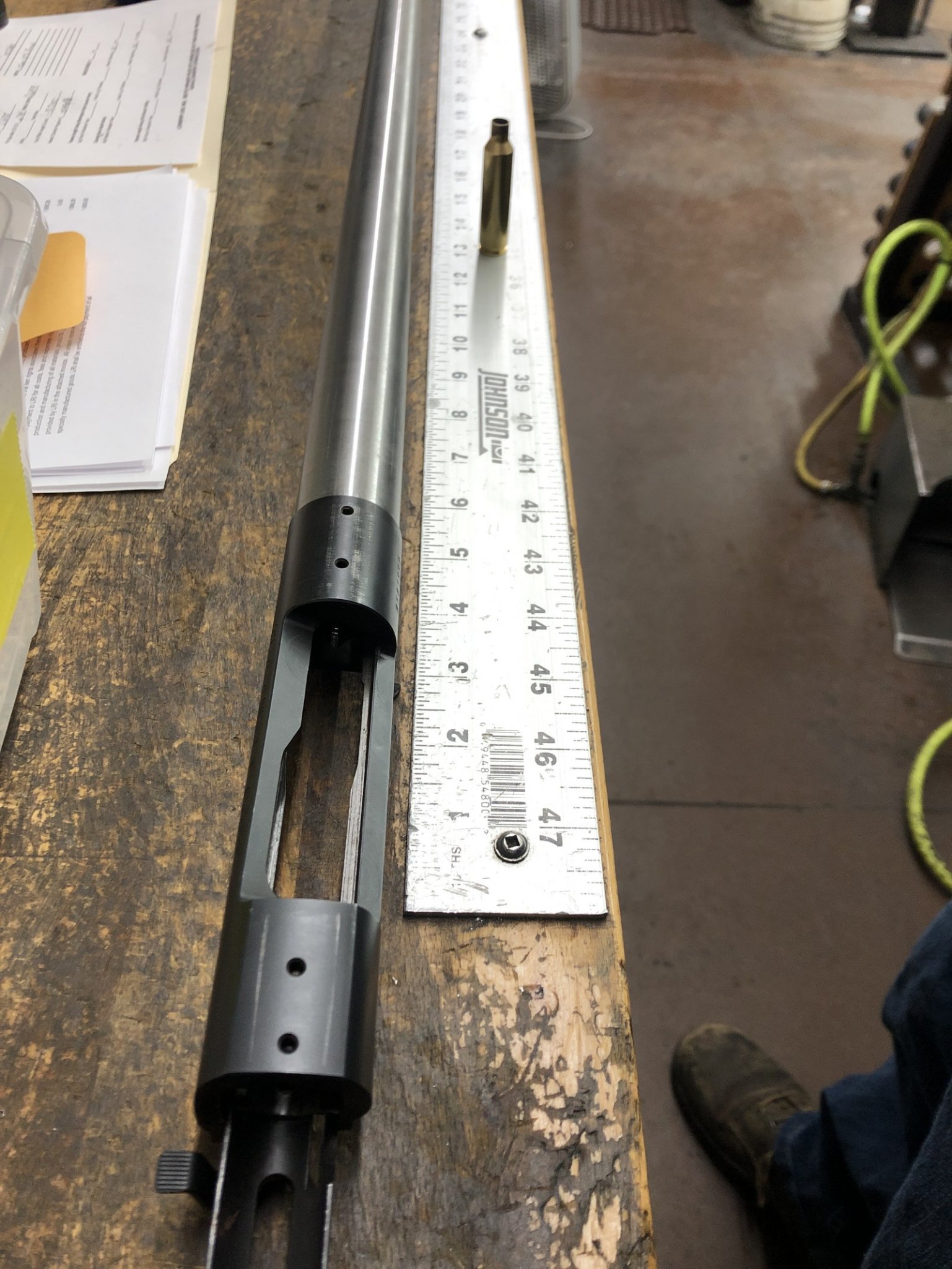

Its going to be a blueprinted Howa 1500 with an LRI fitted K&P 28" MTU Contour 1:8 Left Twist with an Ultrdyne Apollo LR brake sitting in a Woox Exactus precision stock using the Vortex Strike Eagle 5-25x56 in a 30 MOA American Defense mount sitting on a 25MOA rail.
Out of the box this was a 300 Prc cambered rifle that I had minimal success with out at a mile using factory ammo. It came with a pencil barrel and I knew I would be changing it out so I never bothered buying dies for the 300Prc. I didn't know which direction I would be taking it so I didn't want to get too invested.
I've spoken with Ken at K&P and Eric at LRI. All I have to do it this point is get it boxed up and shipped out.

@Schmo I just had a nice chat with Ken at K&P about barrel length and twist. He suggested a 28" and 8tw so that's what I'll be going with. I did ask him about the 7.5tw and he said that while it is an option, you're starting to play with that ragged edge and risking a projectile coming apart in the right conditions.
I also asked him about the gain twist and he said that he doesn't mess with it but a left hand twist is doable.
I then spoke with Eric at LRI for about the third time and ironed out the final details of it all.
All that's left now is box it up and get it in the mail. By the time the weather breaks, I should have it back and be ready to start working up loads for it. :D

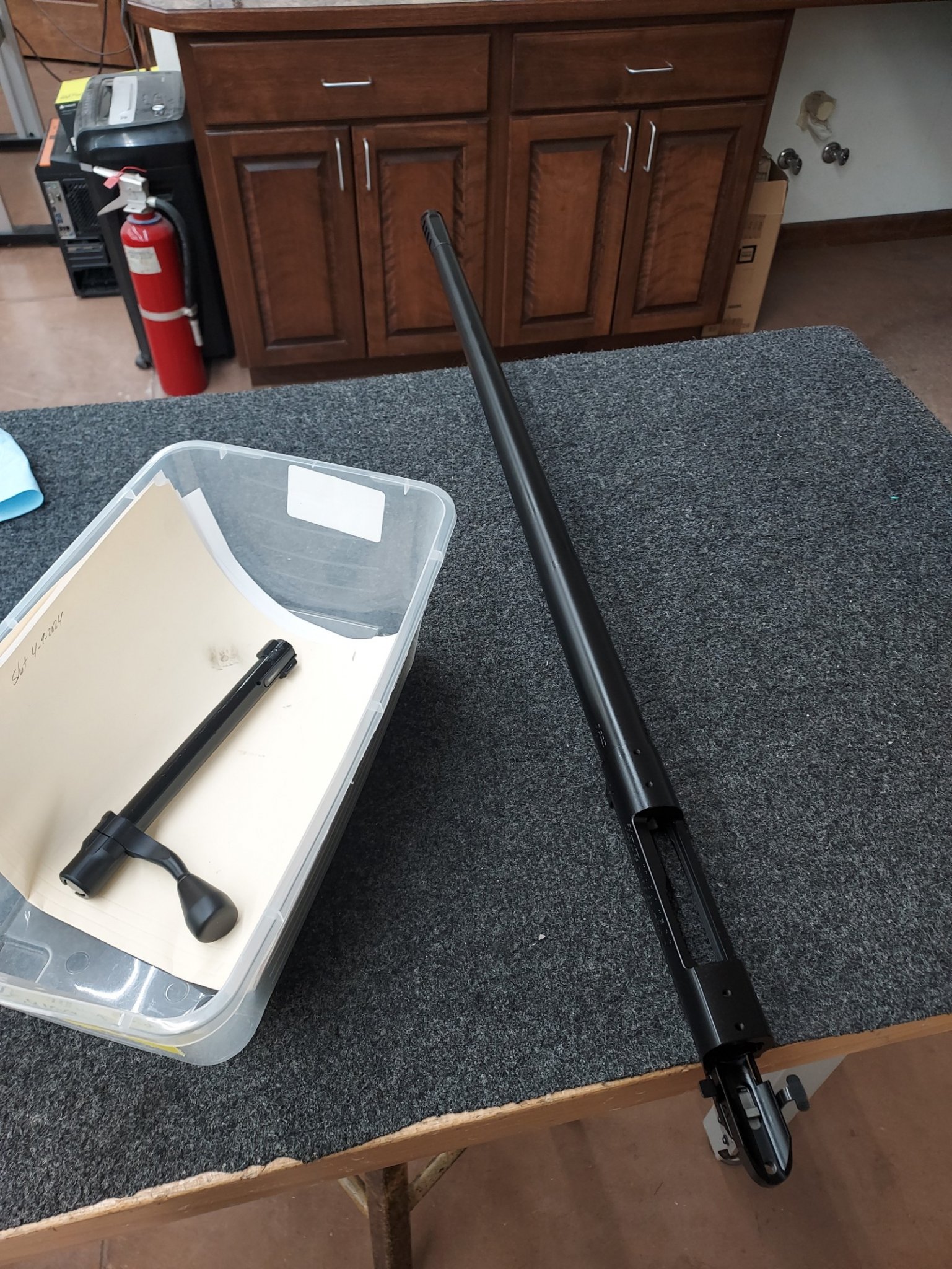

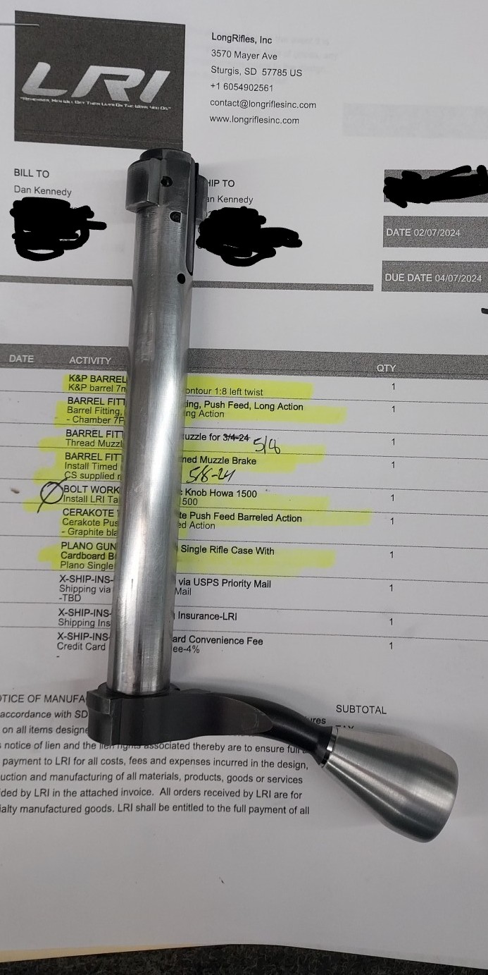

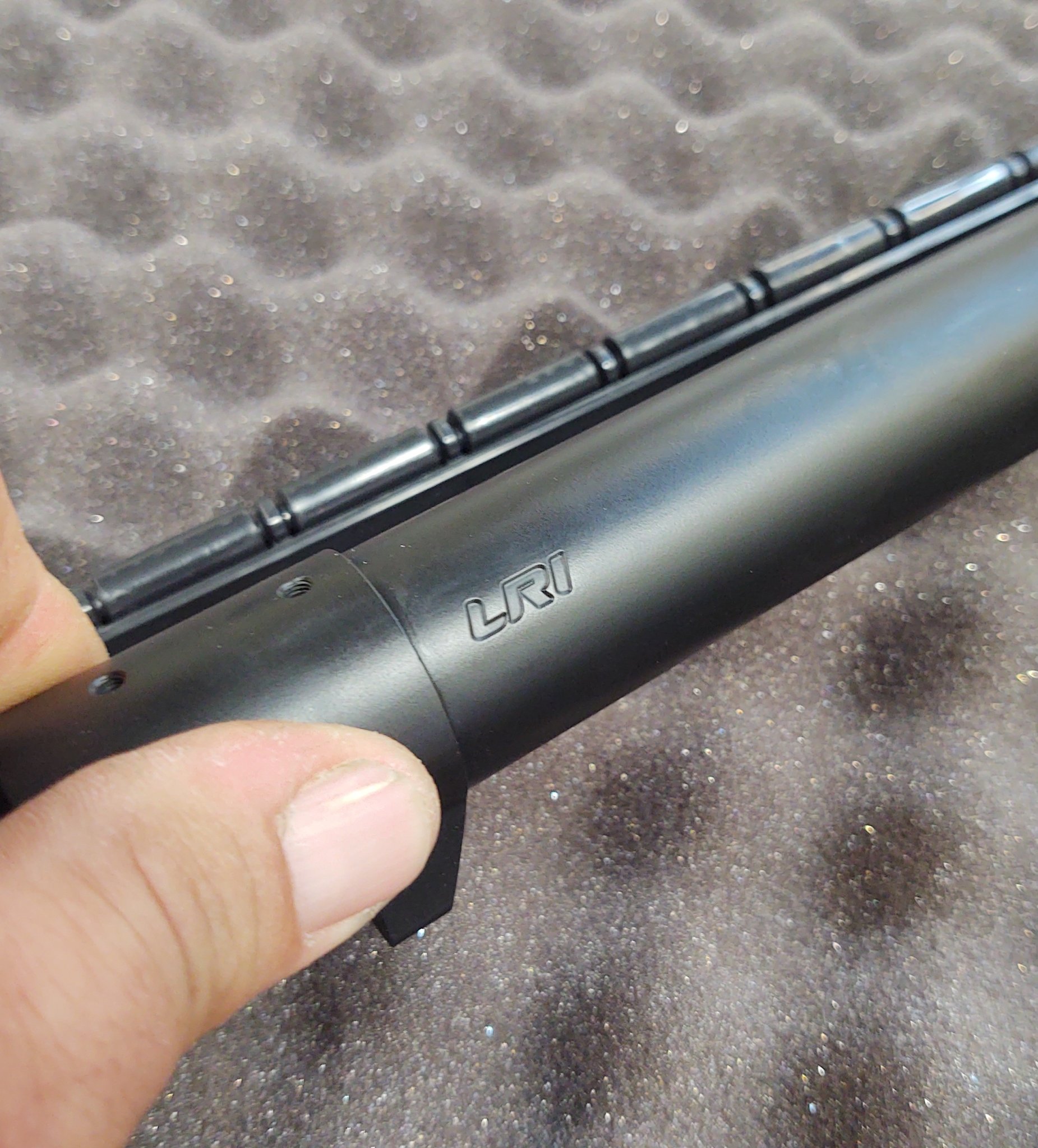

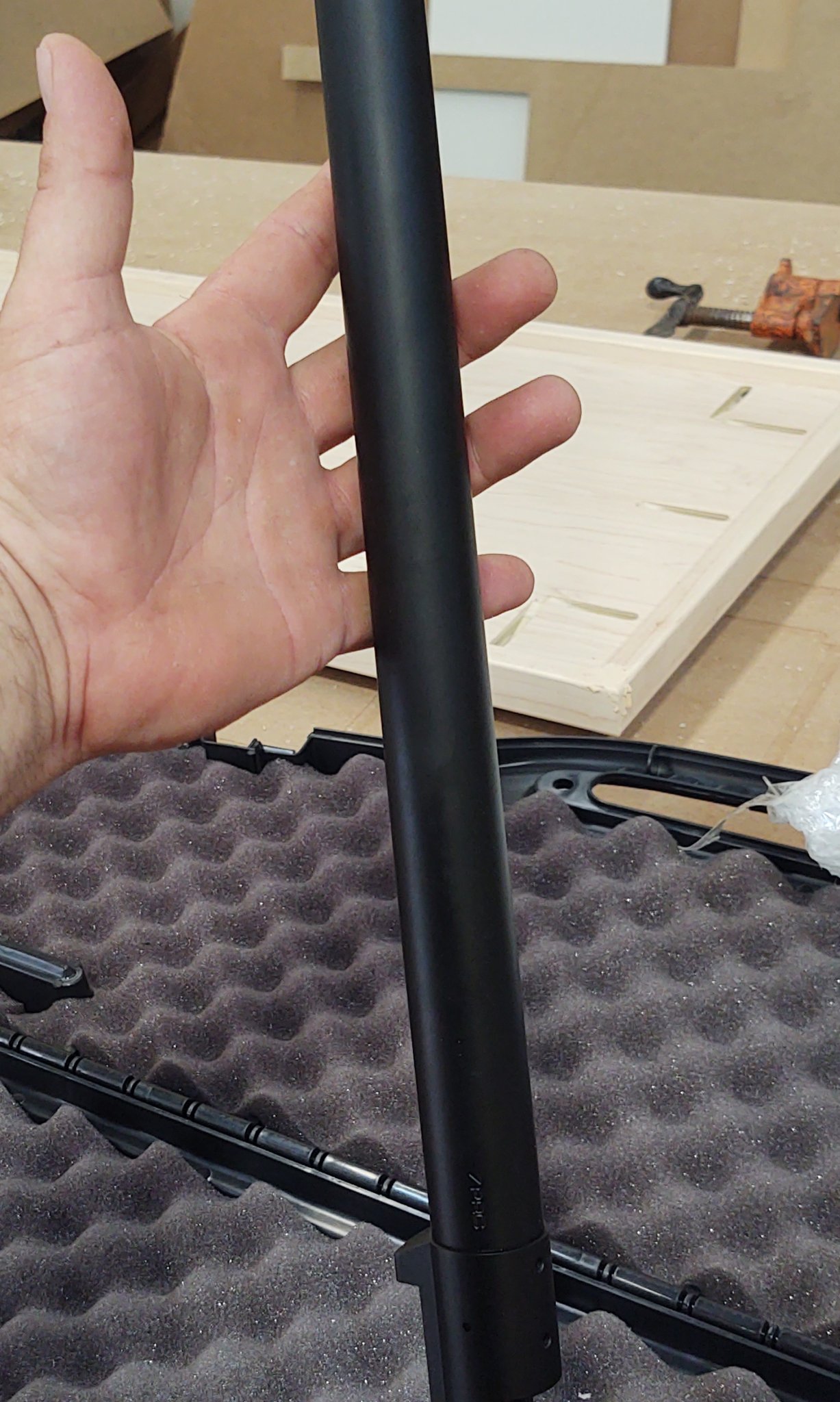

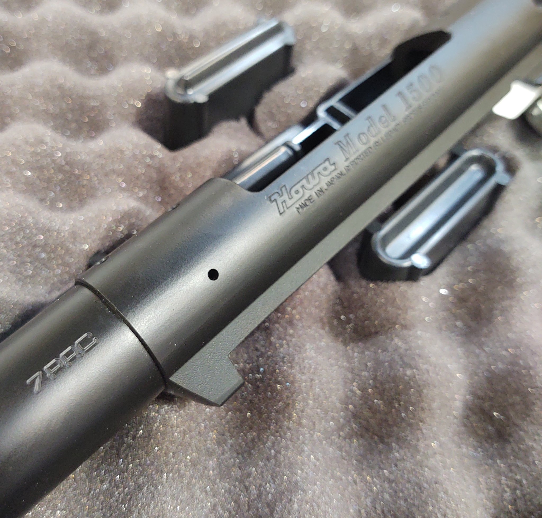

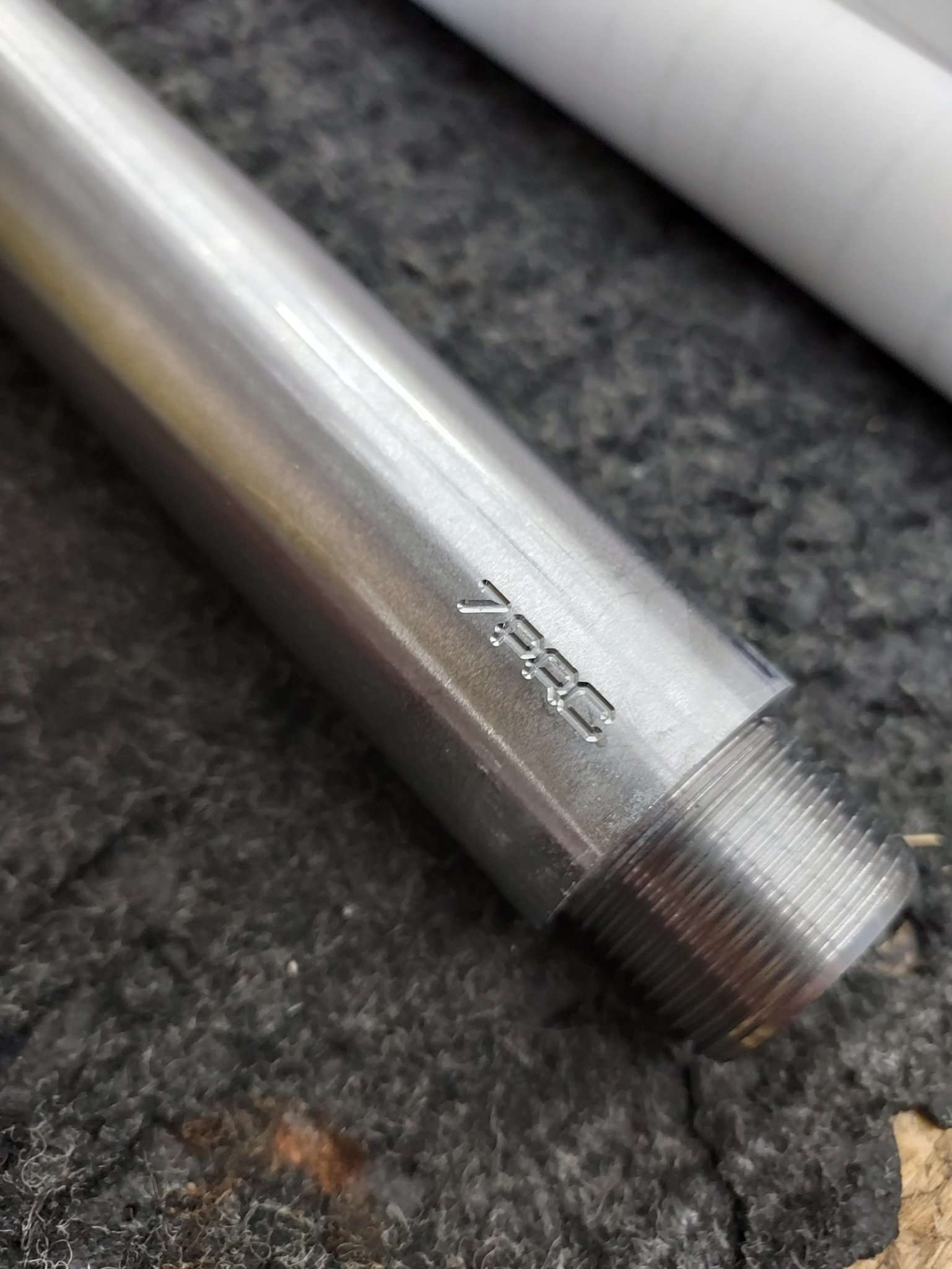

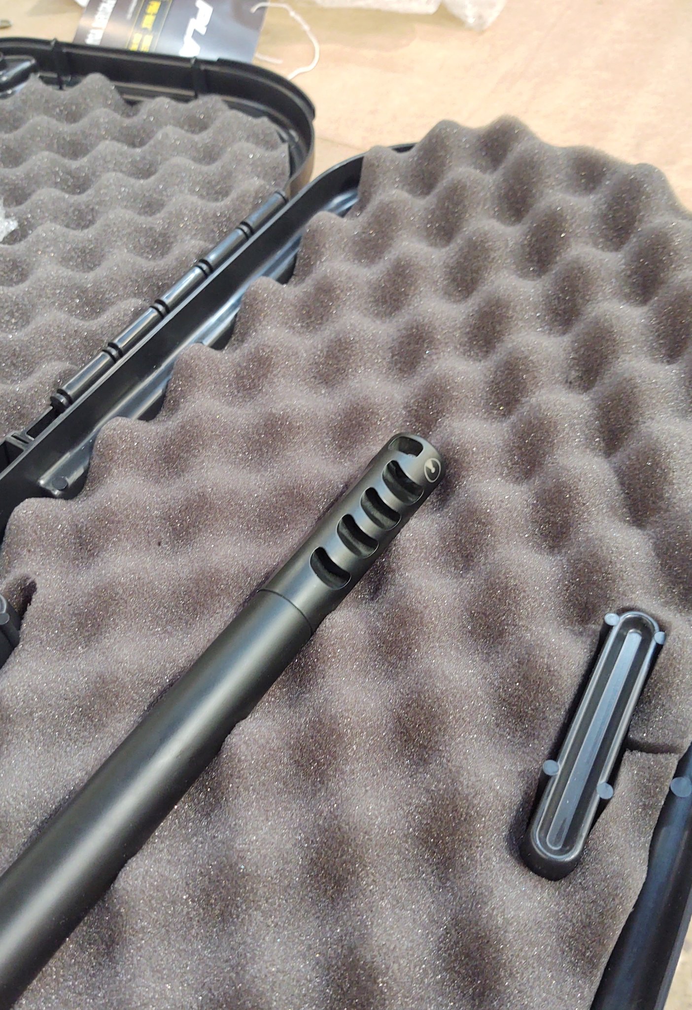

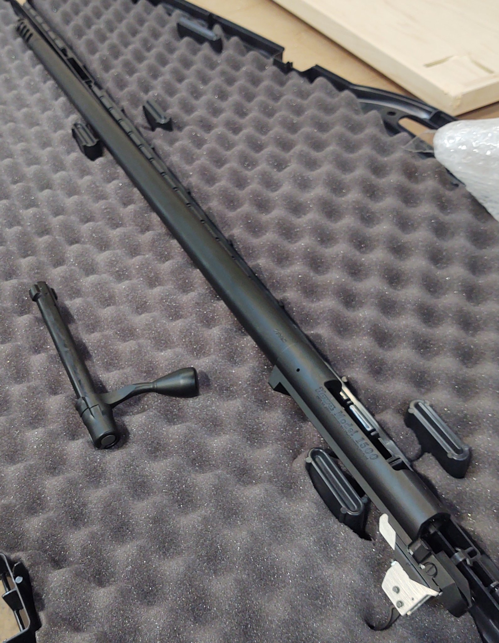

We have been stalling with this for a bit to see if they could get enough of a break in the work to finish up the fixturing and programming for the blueprinting but it doesn't look like it's going to let up for them anytime soon so we are going to go ahead with it without the blueprinting. Not the end of the world but it sure would of been cool to have the first one they did.
It's looking like the machine work will be completed this week and it will be handed off to the paint department for cerakote.
Hopefully it ships out sometime next week and I can get to finishing up what I need to do to fit it into the stock and then get some rounds thru it. 😁

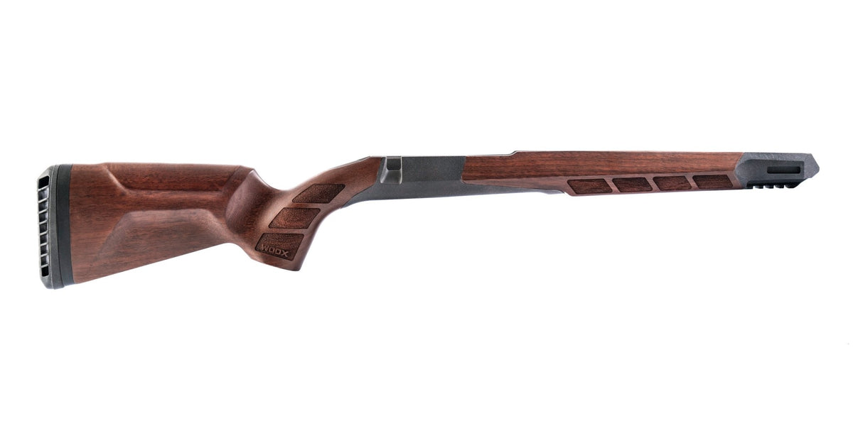

I really like the look of that Woox Exactus precision stock. A chassis with nice wood hardware. Would look great on a short barrel hunting rifle, if maybe heavier than some would want.
I really like it. Unlike some of their other ones, it's not all "Tacticool" looking.
They do have a lighter model, the "Superleggera", at 2.2lbs.
I did see that and were I expecting to be going on any long jaunt hiking hunts, I’d go that way. But the exacta precision just looks great with a 16-1/2” barrrl on it, as host for a can.

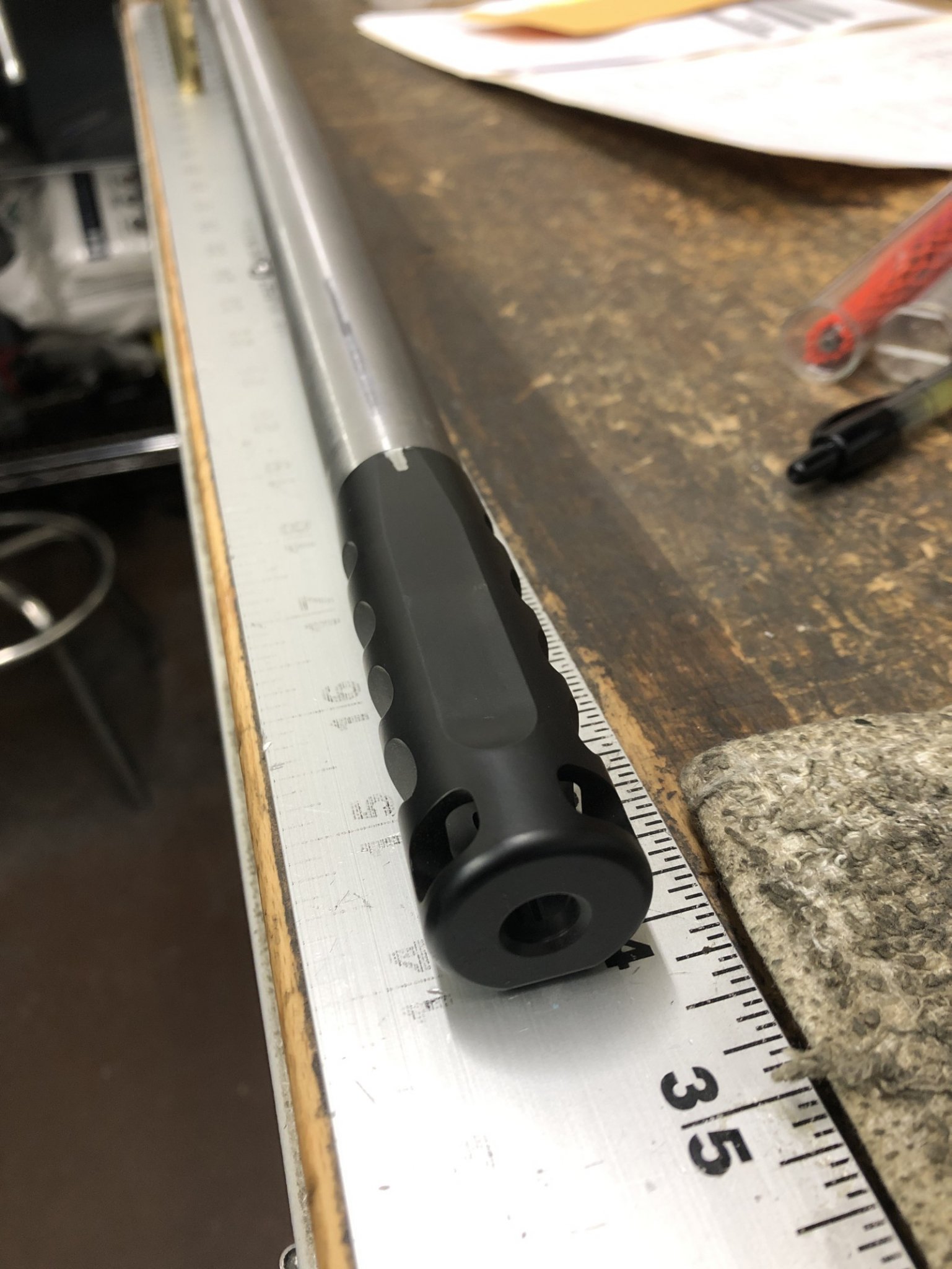

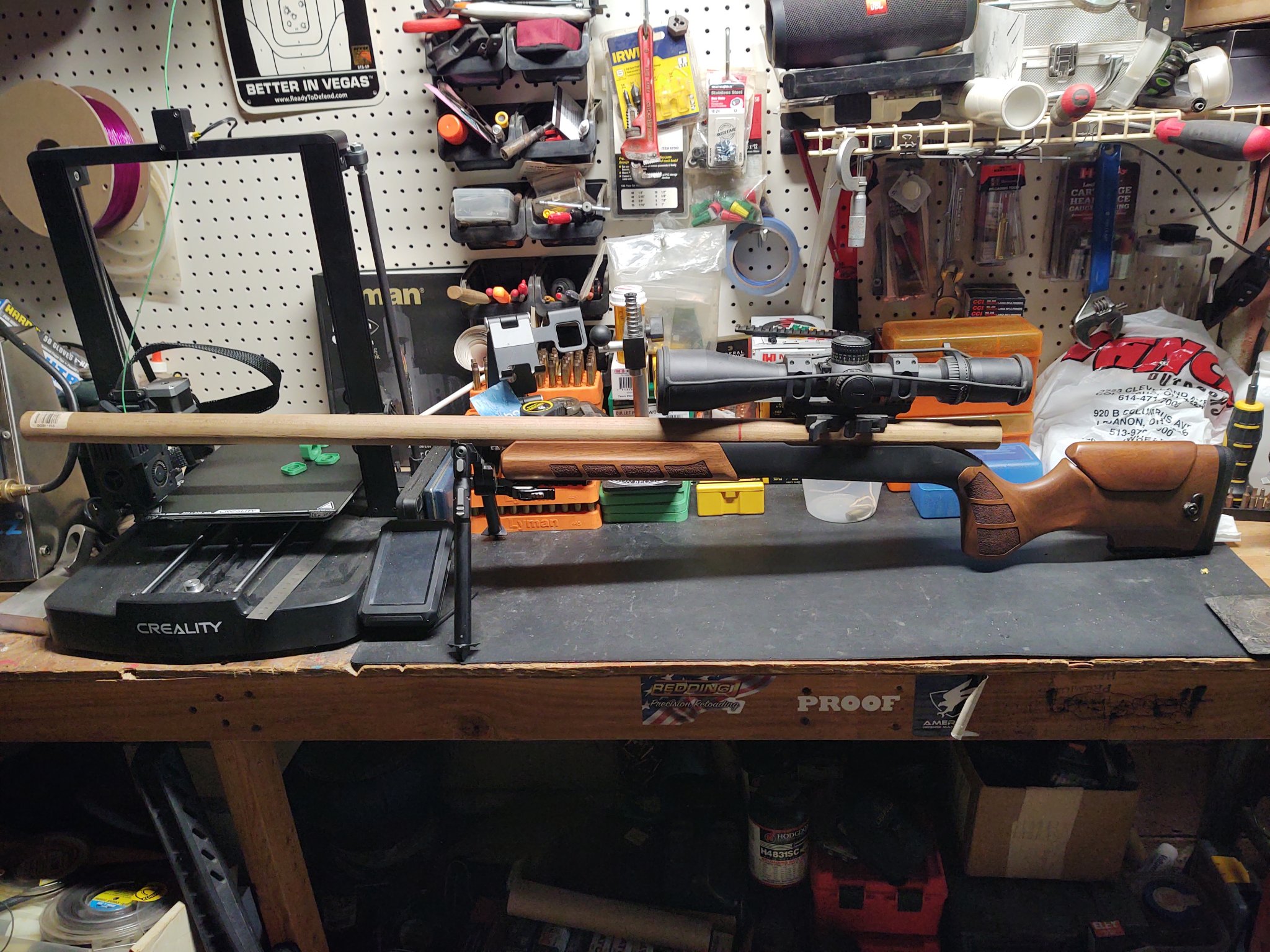

This is mocked up simulating a 28" barrel and a 3.5" brake.
If you drew a line up from the left edge of the 3D printer screen, that would but you somewhere around a 16" barrel.

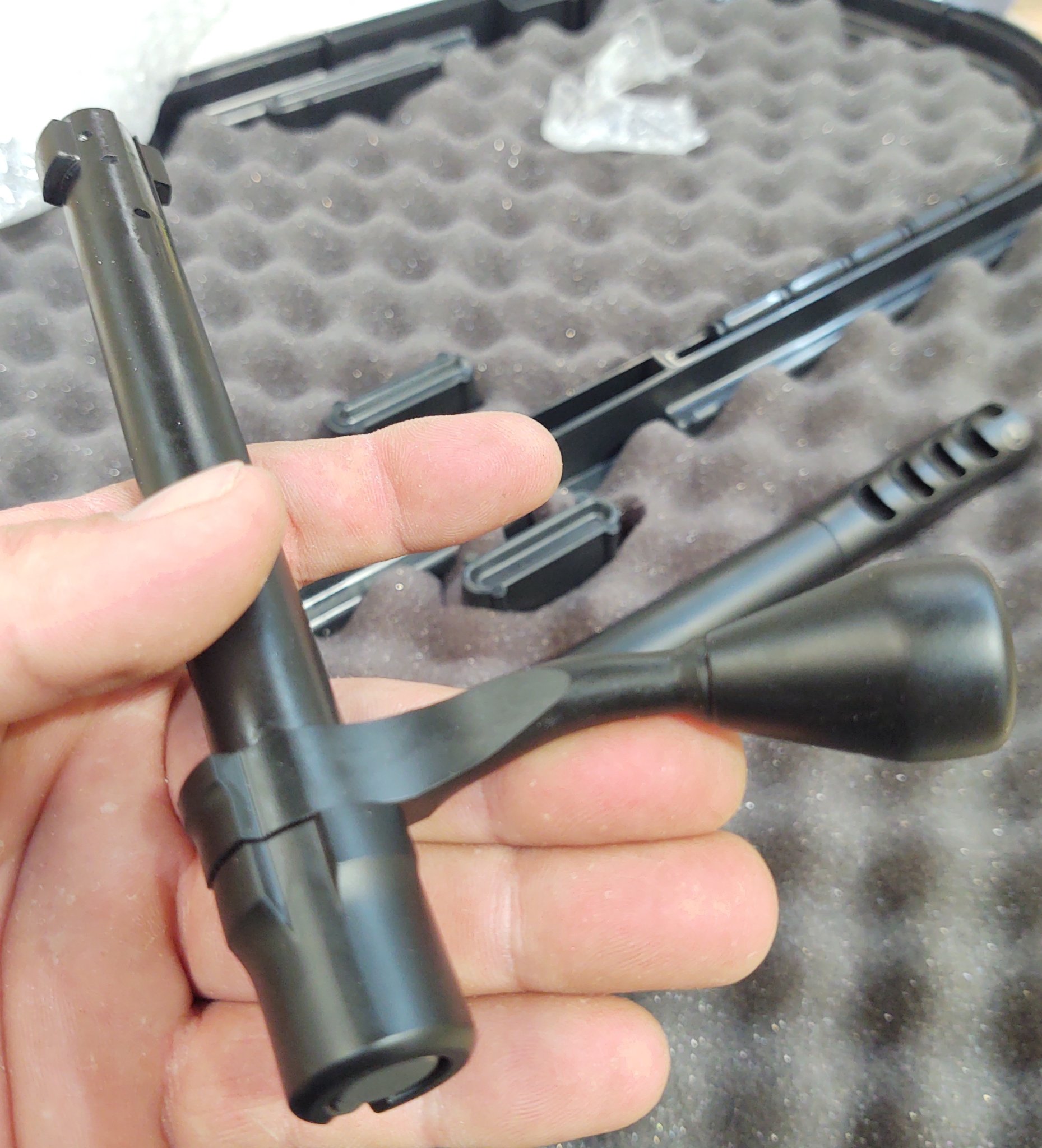

(E)LR is exactly what this build is for, hence the 28" barrel. I had it out a little past a mile with the 300Prc pencil barrel and factory ammo but wasn't very consistent with it. Partially the barrel and ammo, partially me I'm sure.
With the new set up and reloads, blaming the equipment is going to be out of the question so all misses will be on me. That's a good place to be I think.
