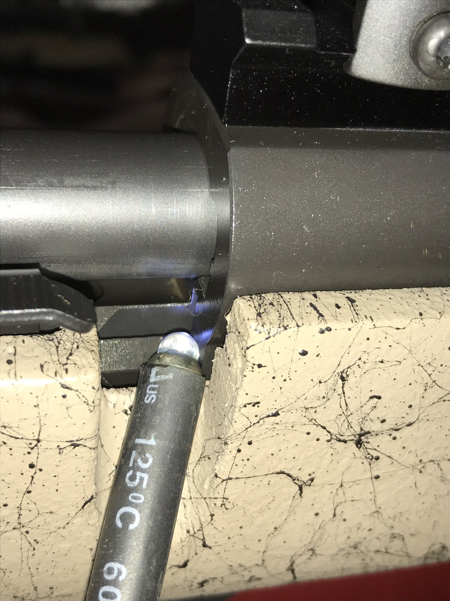

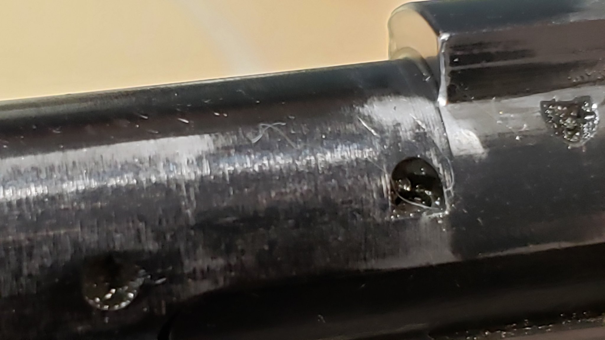

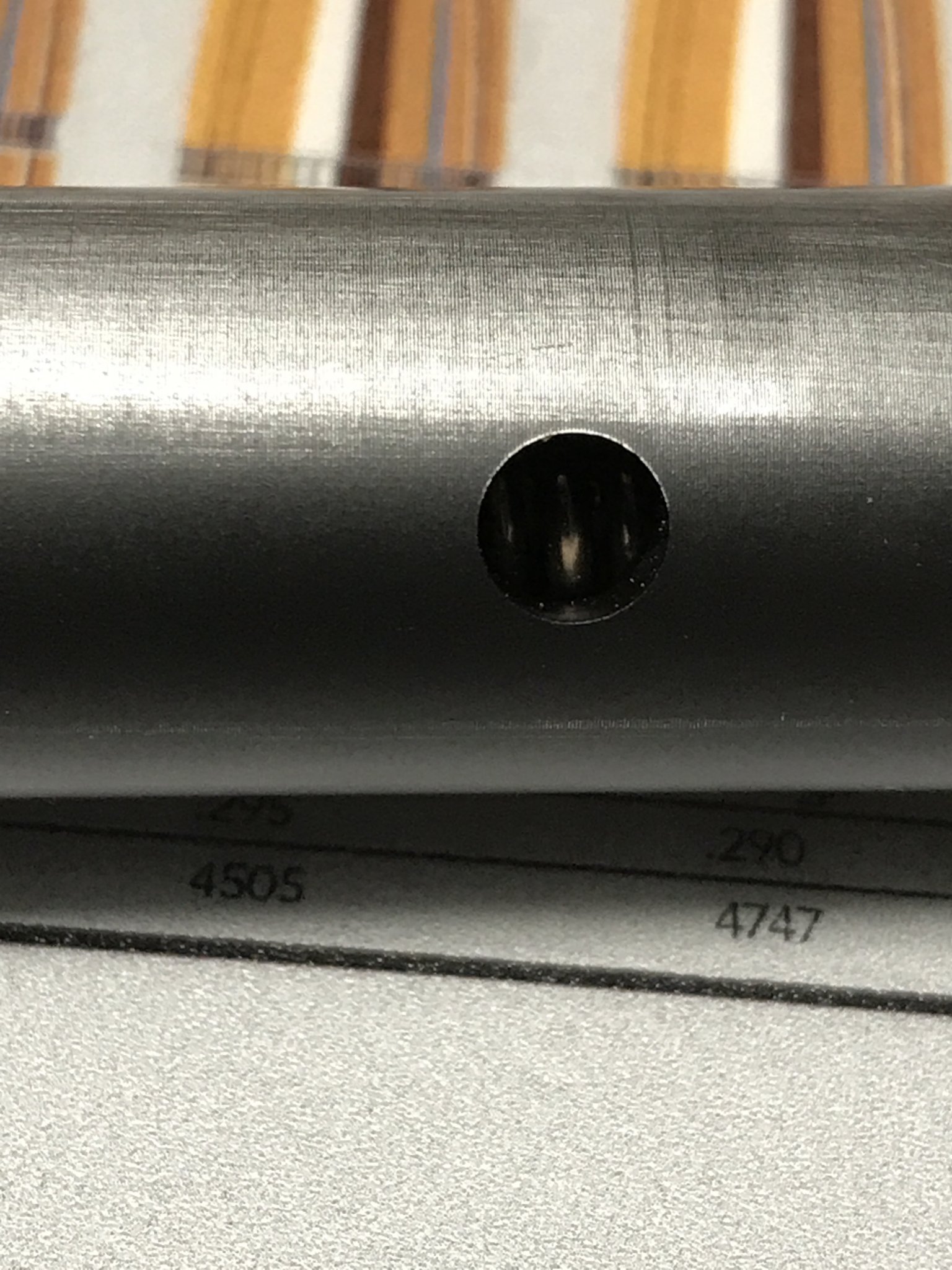

I'm curious if it just mine or the norm with howa. I have a howa 1500 LR 6.5 but the bolt feel like is very rough and ratchet. I was thinking of polishing it or have it treated. looked at it and it the fine machine tool marks doing this. all my other bolt guns fell like butter but more than a few are high end and customs.

Huh... I have one full size and two mini Howa actions, and none of them have the bolt finish that you're describing. Personally, I'd polish it and use some thick-ish oil to keep it lubed. That's what I've done with the Ruger American that I have (which does have the surface finish that you're describing on the bolt), and while I'll never mistake it for a Tikka (let alone a nice custom action), it's absolutely serviceable.
The only part of the bolt that makes contact with the inside of the receiver while cycling are the lugs. Specifically the outside diameter of the lugs. The bolt body cannot touch the receiver raceways because it's much smaller in diameter.
The point of all that is that tool marks (which are present in everything even if you don't see them) on the bolt body and handle are irrelevant to your problem.
The answer to your problem is in post #4 of this thread
Reactions: addictive hobby

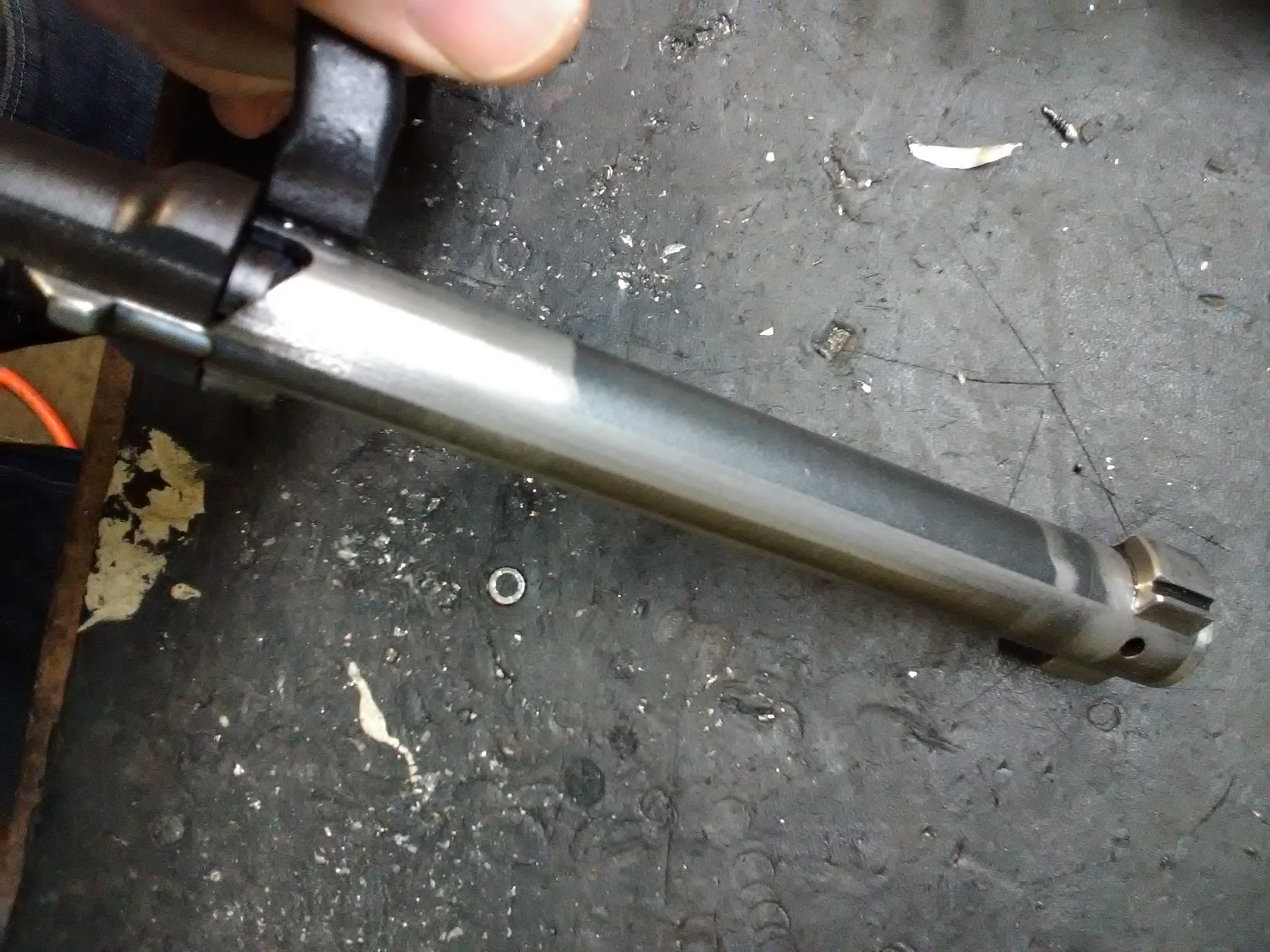

I have two, a 308 about 10 years old and a 223 that's a year old. The lathe tool marks on mine have been burnished/polished down and the bolts are as smooth as butter.

The finish in the pictures is fairly normal for Howa 1500s. I've built 6 of them and while they feel rough at first, cycling them several hundred times will lap the contact surfaces and it will be very smooth. Mine had 4000+ rounds through it and a 308 had 5000+. I'll post photos of what it looks like after extensive use.

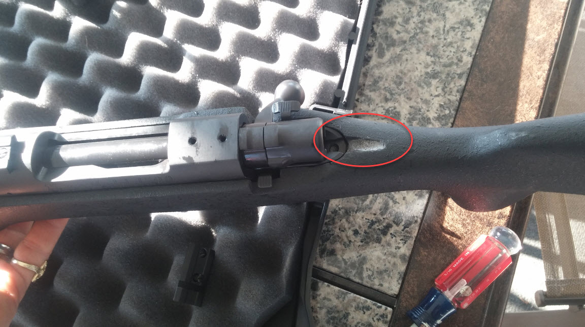

I put a Howa 1500 .308 together this past summer and I thought there was a problem with the bolt, but it turned out to be an issue with the stock. When I cycles the action alone (not installed in the stock) the action was like butter, but in the stock the action would hang/drag a bit halfway through the action.
For me the problem was there was not enough of a travel groove in the stock to allow for proper bolt travel. I took a dremel tool and CAREFULLY took away enough material and now it's great:

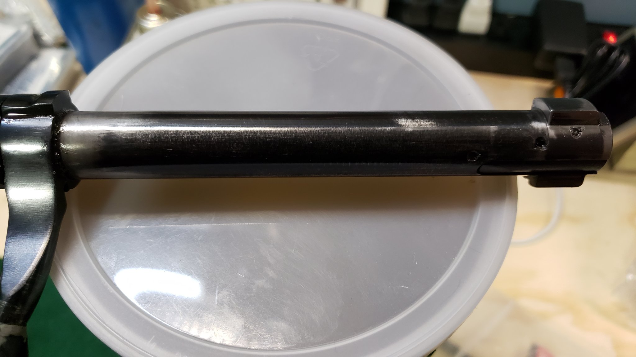

Here is my bolt (4000+ rounds). You can feel the tiny tiny machine marks if you run a finger nail over them but it's impossible to feel when cycling bolt even slowly.
The shiny spots are the wear points (obviously) that needed to be broken in to smooth bolt throw.
Not at all the norm. For sure I would call Legacy.
I think the OPs photos make finish look worse than it is in person; my bolt is black (where not worn) and it looks virtually identical to the OPs. It smooths in very quickly with some cycling but that is the cost of a factory action vs custom action.
However, if he has a cerakote gray action (that's what it looks like from photos), it may take a long time to wear in compared to a standard blued action.

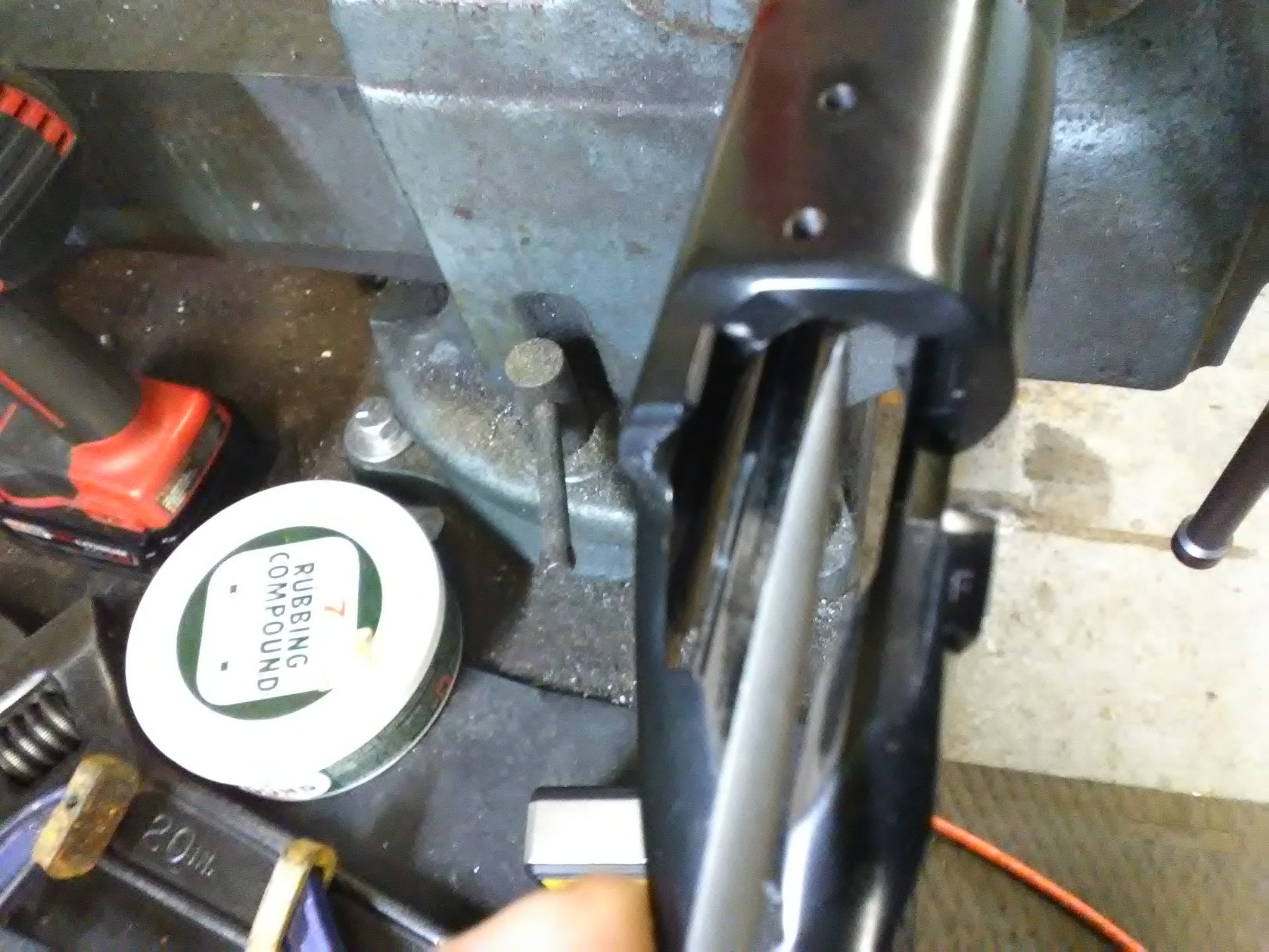

I haven't had this with my howa but if you're a do it yourselfer you can make it nicer I'm sure.
On new Remington the bolts aren't engine turned like they used to be and have a rough surface.
The bolt pictured hasn't even been shot but the bolt was cycled a ton with lapping compound.
The other thing that smooths it out is taking a small file and knocking off the sharp edges of the receiver that contact the bolt. (pointing to one area with file)
Any of those leading and trailing edges on the action.
It doesn't take much either.
Make a factory action much more enjoyable with a little time and no expense really.
If you did this don't get compound in the lug areas if not changing barrels you could potentially open up headspace a little.

Absolutely the norm. It's just standard issue spiral (think threads) machining marks from them turning out the bolt. Totally normal and there's nothing wrong with them. It's on my Howa as well. Even though it sounds like an ULTRA fine ratchet when cycling (yes, every bit of this bolt touches the action; it's a very close tolerance gun) it's still smooth as heck, and one of the nicer cycling bolt guns I've felt in a while. As far as polishing super hard steel? Good luck with that. You'll be there for years.

Machine marks normal, yes. Feeling like it ratchets, not normal.
