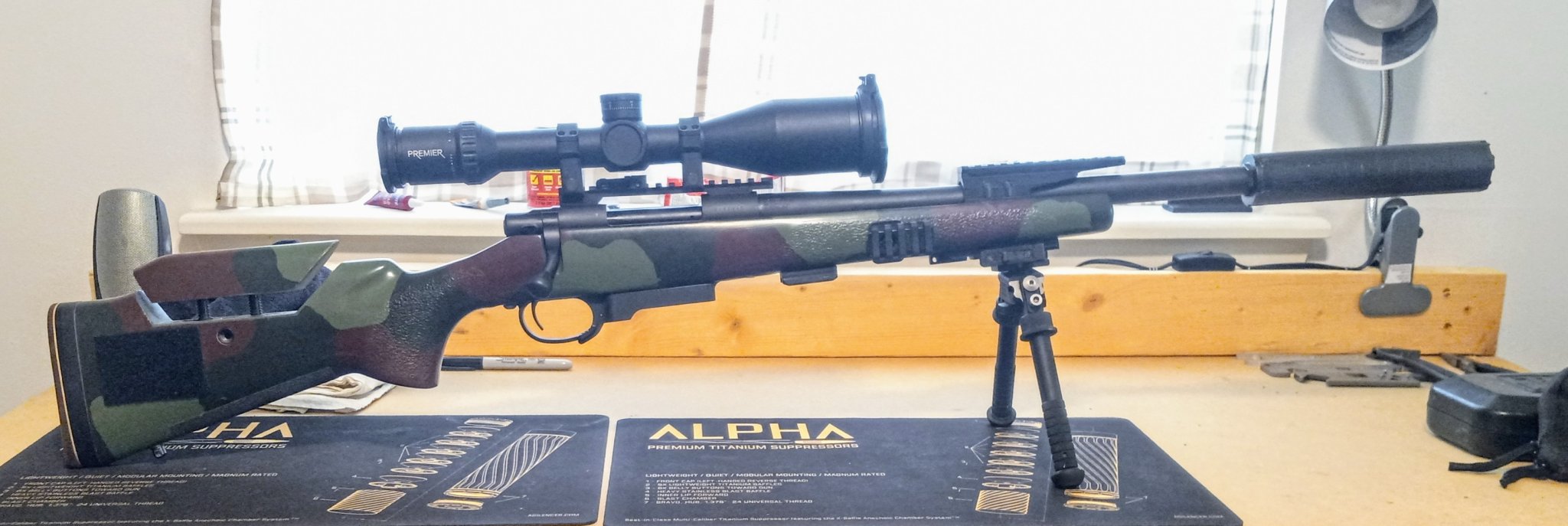

I picked up a Howa Superlite from Brownells in 7-08 20" barrel. But a shorty would be better with a can when shots will be 400 yards or less. I got one of the blem Stocky Stocks for it too. KRG Bravos weight around 3 lbs. My Stocky's Carbon fiber blem is 1lb 5 oz. I have a Bravo on my 260 AI. But for this Howa I wanted to keep it light, very light.
