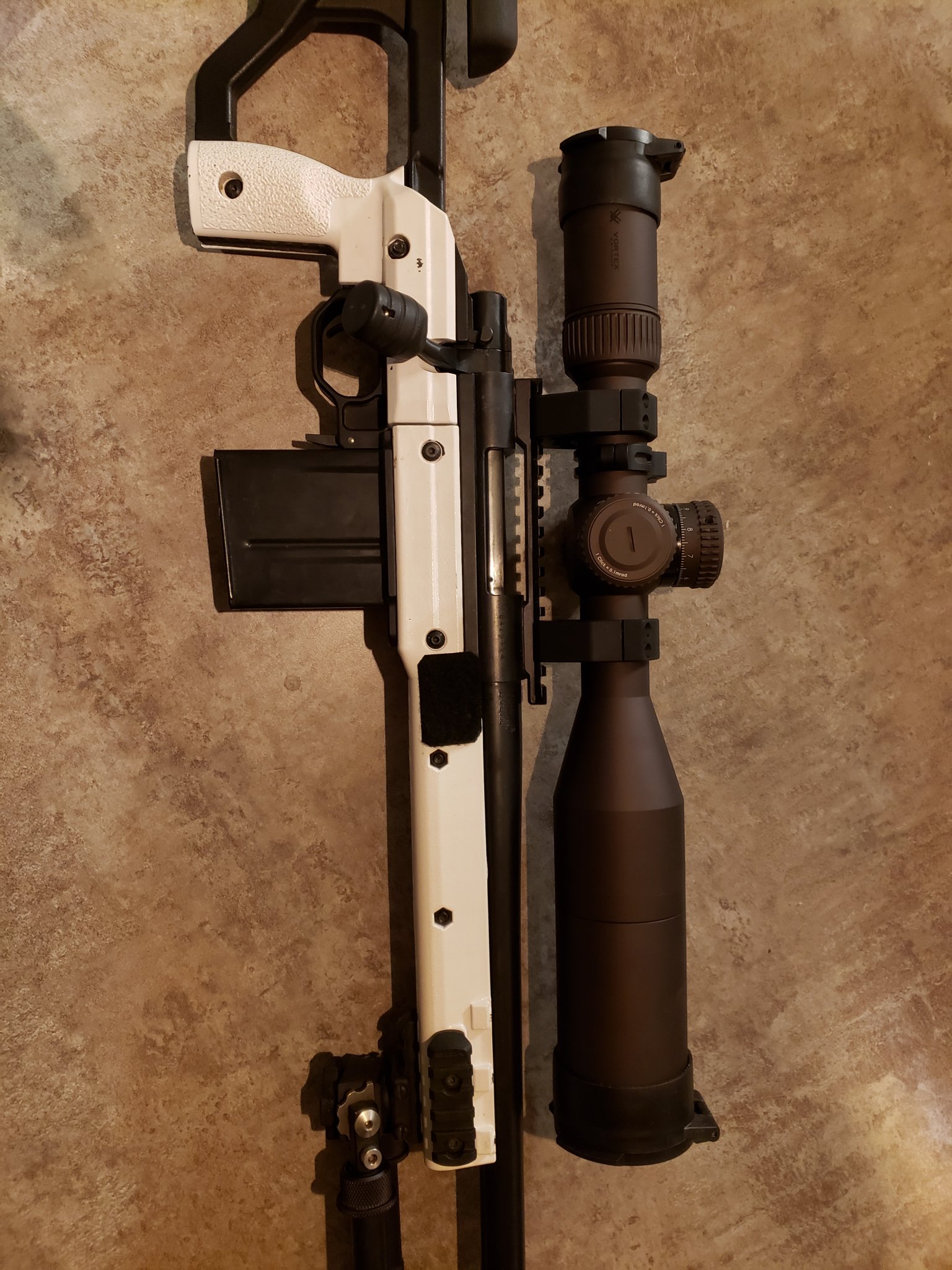

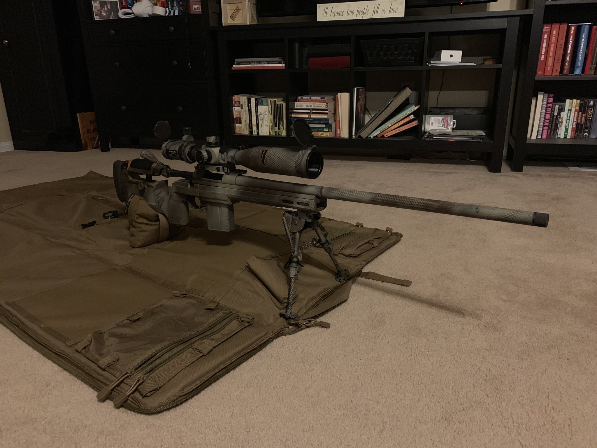

Built this one for under a grand (not including scope, suppressor, and bipod):
Brownells 24" 6.5 action
KRG Bravo Chassis
Quickload bolt knob
Nightforce 20moa rail
7051824

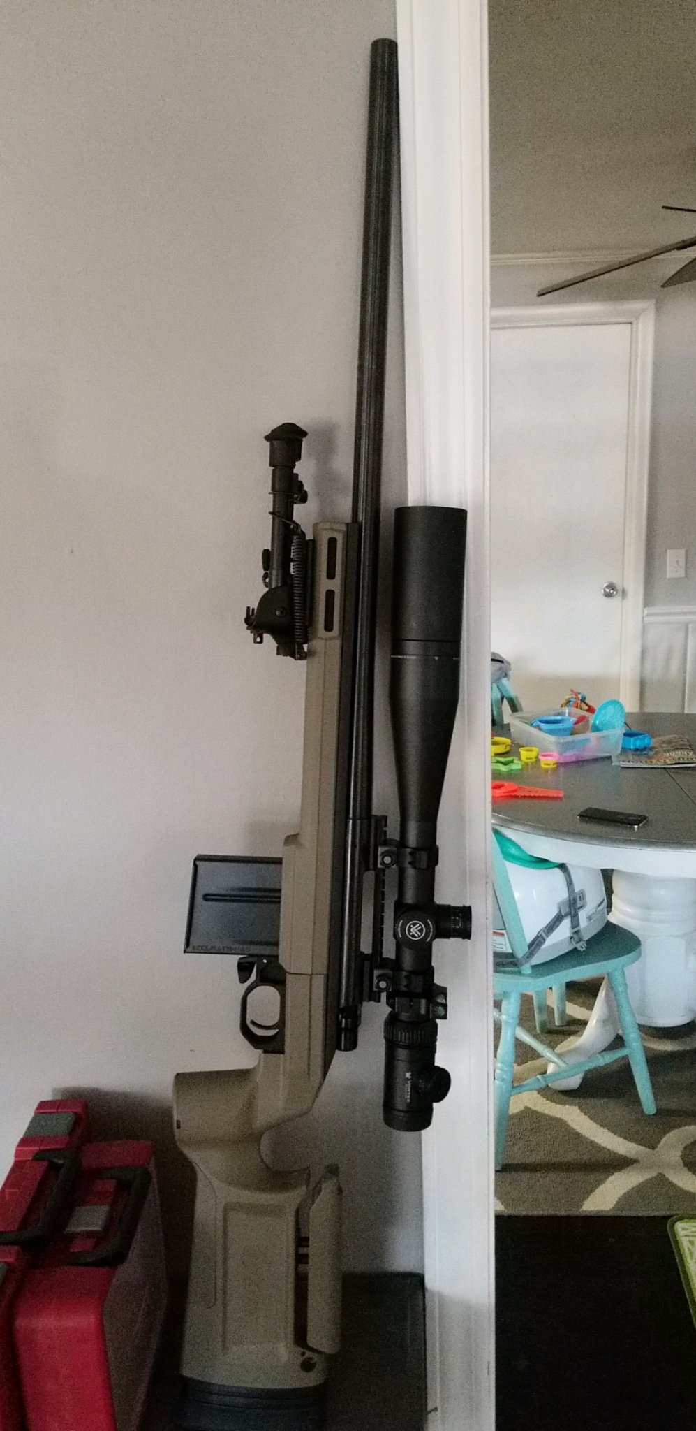

My goal is to do a Howa in .308, hopefully 24" and either an Oryx or Bravo. Brownells has the Howa Bravo already setup but I think with them putting the barrelled actions on sale from time to time I can save some cash that route.

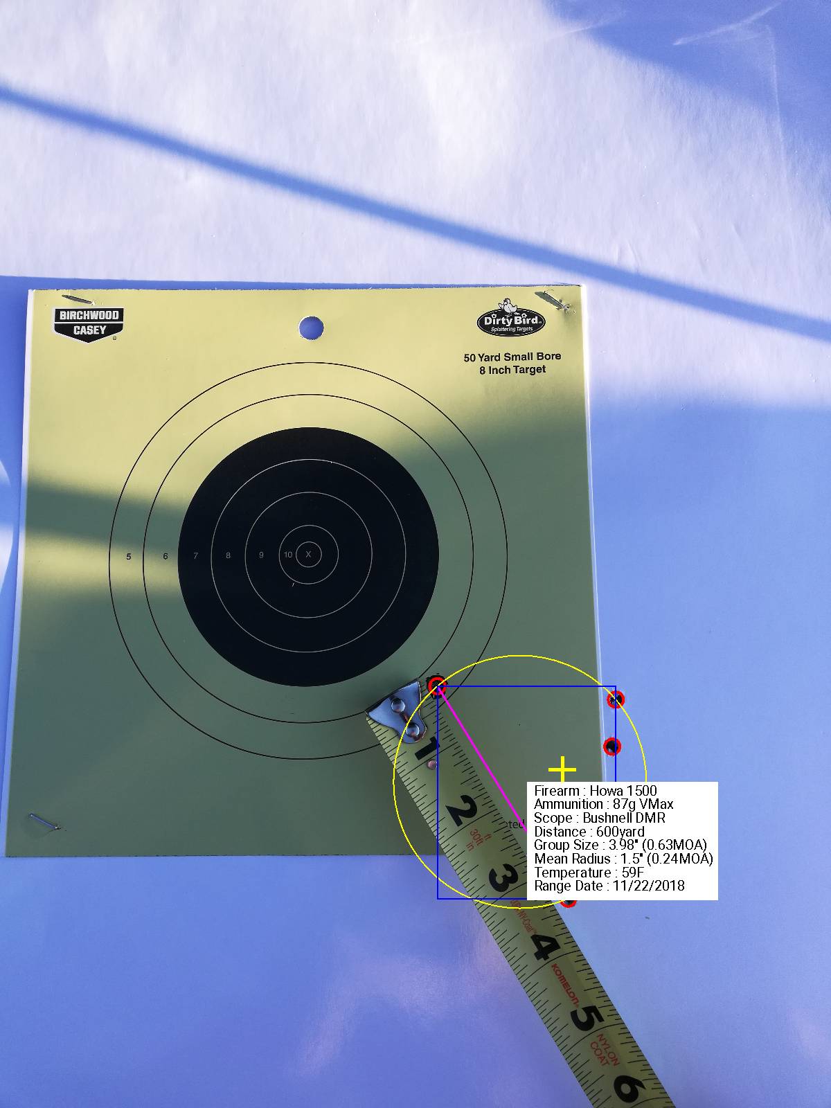

Here is a 600 yard group from my 243 HCR with 87g VMaxs.

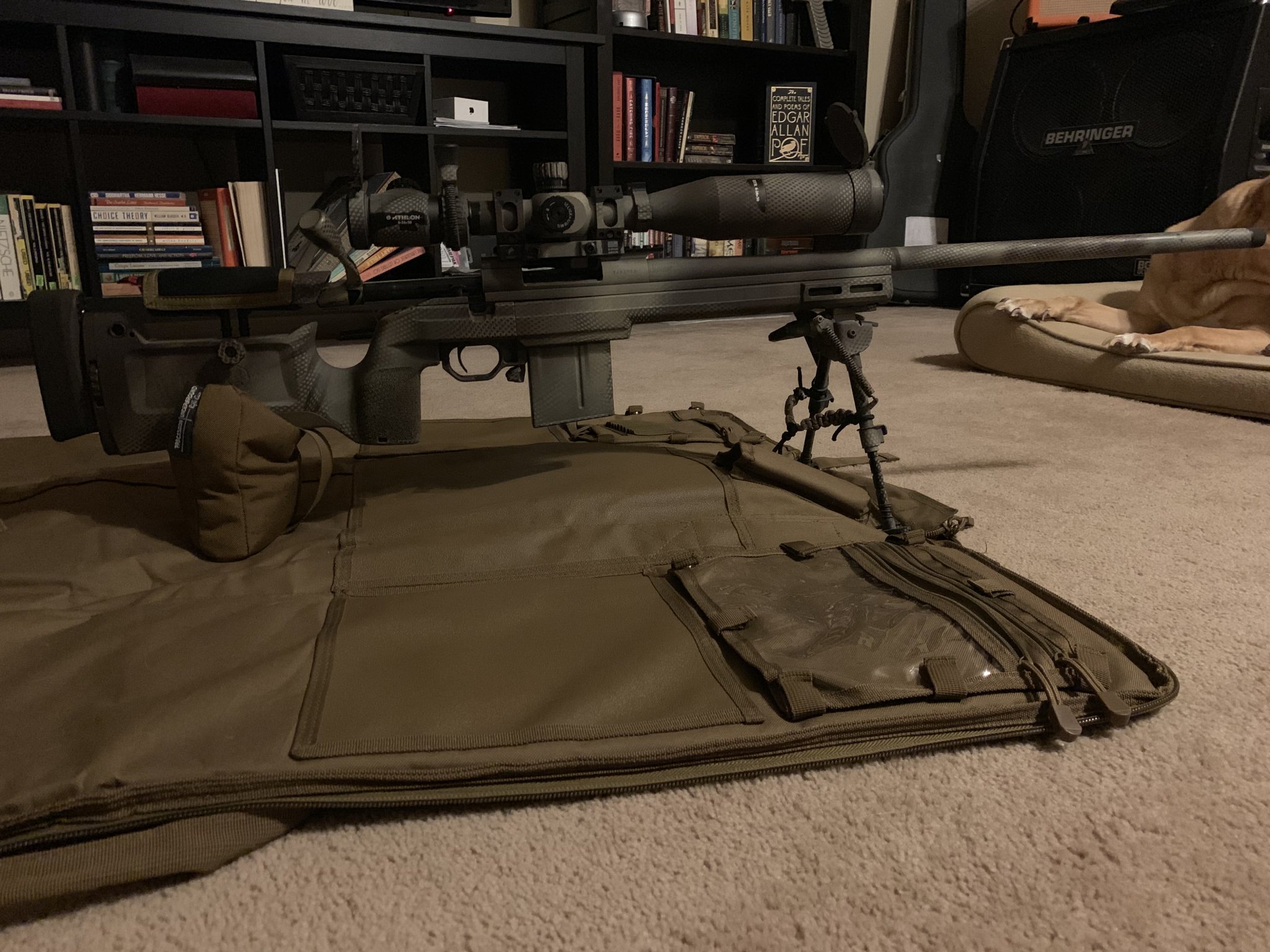

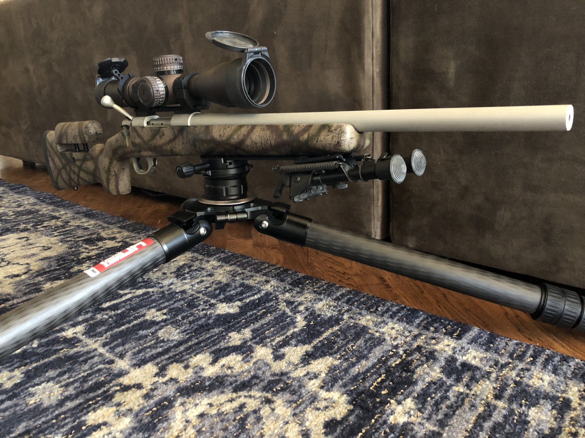

I've been running this one for a few years now. ~1600 rounds down the tube. KRG 180 X-ray (or something) chassis and the timney trigger. Factory 140 ELD-M shoot ~5/8 MOA. Handload 147 ELD-M's with H4350 consistently do under 1/2 MOA. It's seen quite a bit of dust and cold without any issues.
I've been using the EGW 20 MOA aluminum base since it was new. JB Weld bedded the base to the receiver and haven't had any issues.

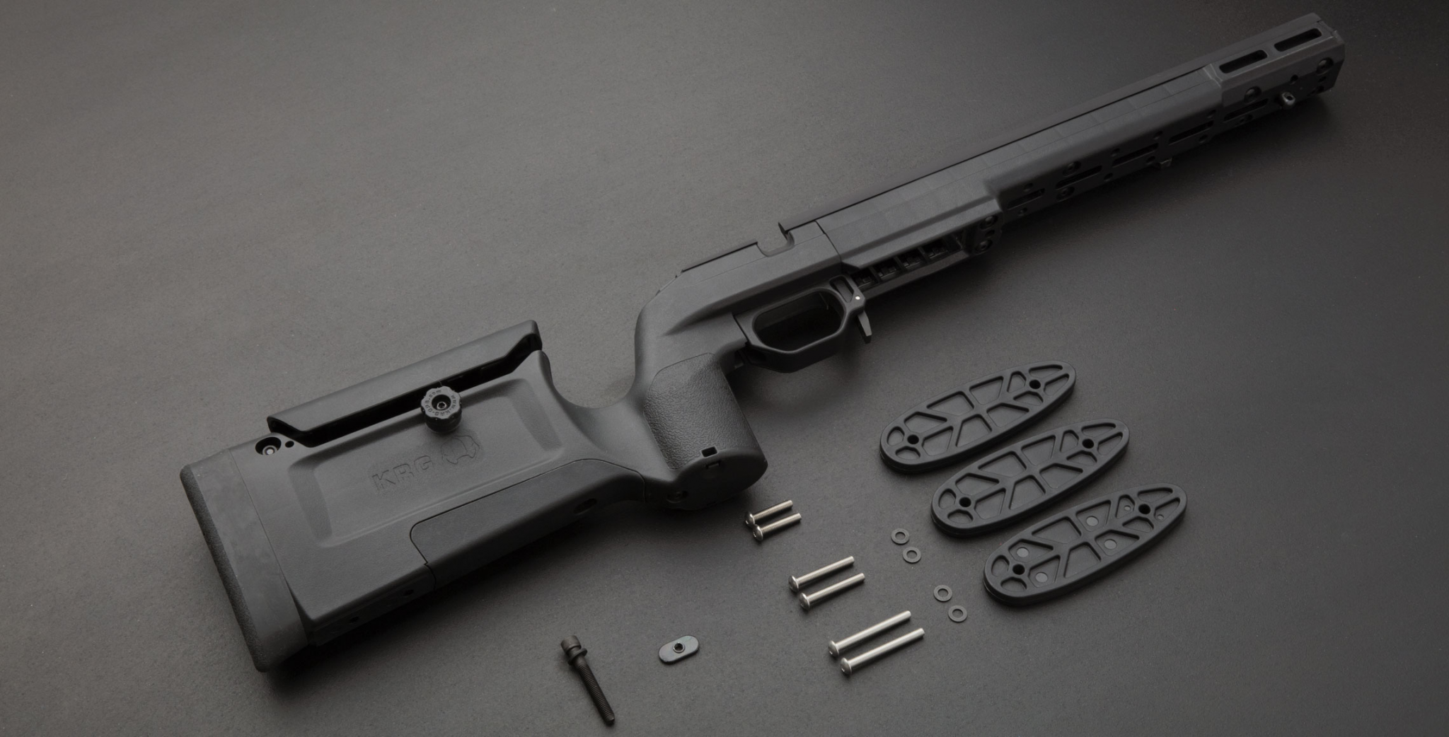

I'm building a Howa 1500/KRG. I ordered the $40 plastic mag well/trigger guard from Brownells. After looking through reviews of the Legacy rifles already built, the trigger guards look metal? Are they the $210 CDI? If they are, so much for saving $200 screwing it together myself :confused:
The KRG bravo has a trigger guard included in the chassis. No need to buy one separately, it wont work on the bravo anyways.
No kidding? Thanks! Looks like I got a return going back to brownells.
Yep, true story. It comes with everything pictured here. All you should need is a barreled action to put into the bravo and an aics pattern mag to feed it.
7110890
That plastic bottom metal is for converting a factory howa stock bdl floor plate into a factory dbm. The bravo removes that need.
You can buy the bravo for 450 bucks (howa is more expensive than the rem700 model) and barreled action from brownells for ~450 for a total around 900 plus a mag. So right about 1k all said and done.
Or you can buy the "Howa Bravo" which comes all together with a mag for ~950-1100
Depending on which particular chambering and barrel length you want it may be cheaper to get them separately or to get them together.
I think you already have the howa in 6.5 creed though? In that case all you would need is the chassis and a mag and your current barreled action should drop right in.
I bought the 6.5CM barreled action and KRG bravo from Brownells. Got the action yesterday. KRG is supposed to be here today, but Fedex messed up and it's not here. I already got the trigger down to 1lb 11oz today as well as mounted a 20moa warne 1 piece base. Nightforce SHV 4x14-50 F1 scope on order along with Burris XTR rings (hope medium works). 2 Magpul AICS mags and a couple boxes of Hornady American Gunner 140gr ammo. I should be ready to hit the range as soon as school starts for the kids!

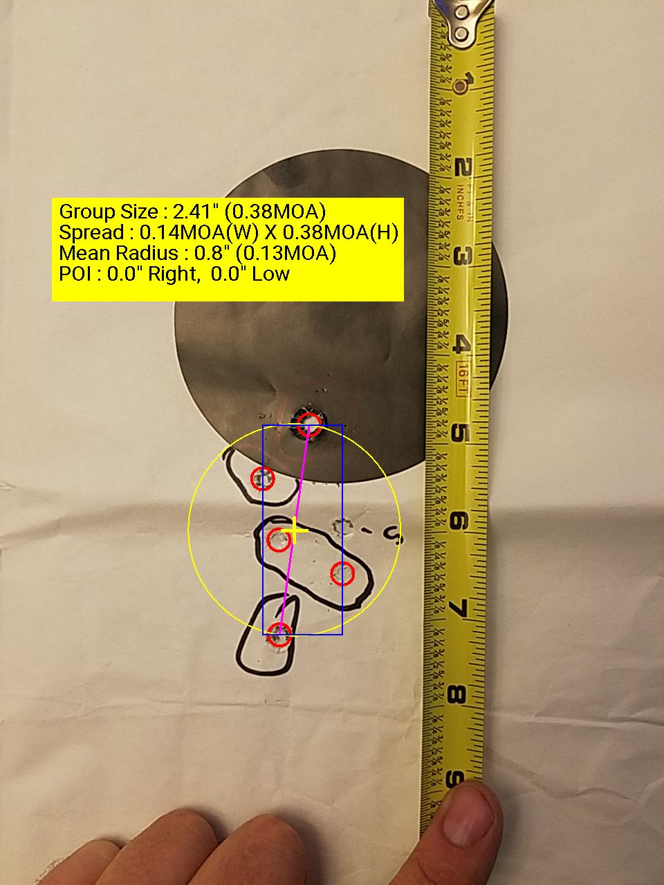

Been working on loads for mine, and believe I found a decent one with the 140 eld-m rounds. Averaging just under half inch at 100 yards so far. I have the American flag chassis and wish I would have found the grs stocked version. Though honestly with the bravo on my 22-250 Remington I enjoy it quite a bit. Have been considering about selling off the chassis system and get something else.
