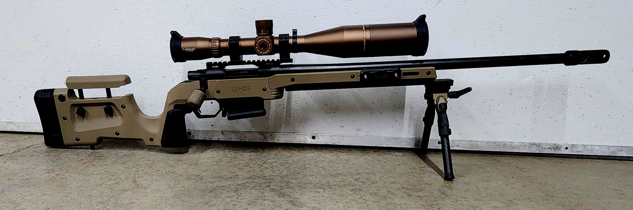

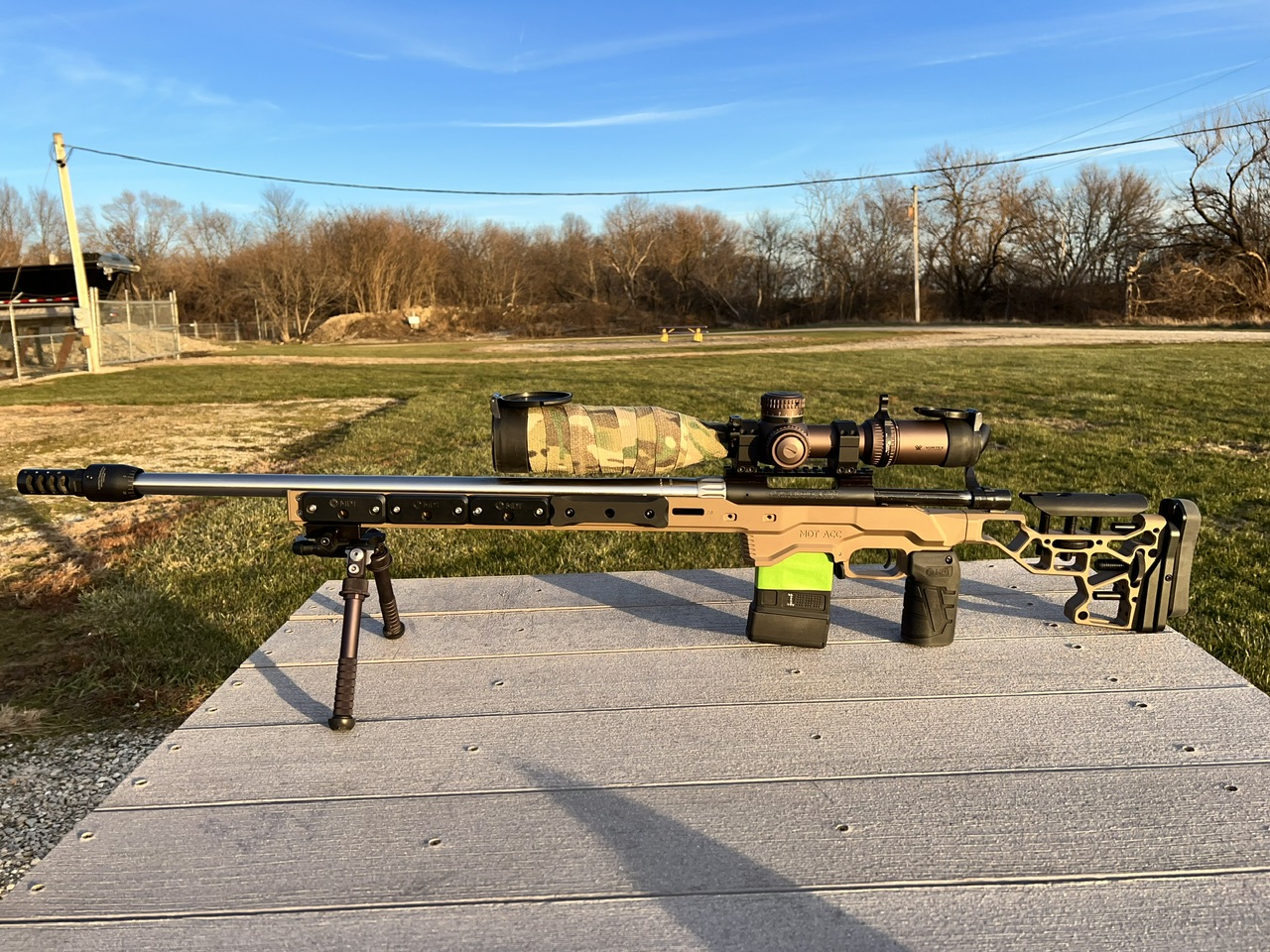

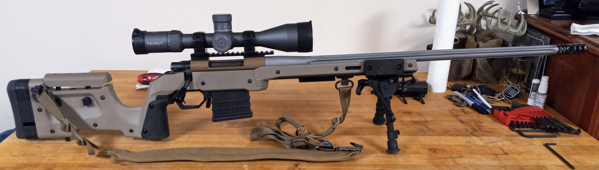

This is mine in an MDT XRS chassis. I opted for this over KRG Bravo because I have an R700 in a Bravo and while it is decent it just felt too plastic for me to use as a bench gun. Great for hunting though! I have an MDT grnd pod with 419 Arca clamp. The rail is from sawtooth rifles and made to fit this stock perfect.
I'm not sure you make appreciable gains doing alot to these guns. If you want to toy with them for fun or because you'll enjoy shooting it more and then shoot more...cool but unnecessary. I'll attach photos of my two, one with all sorts of work done, and the other mostly factory. They both shoot very well but exceedingly similar. Both have taken pigs and deer, both have seen steel to 1200.
Howa 1500 6CM, XRS Chassis, Snyder weights, HS Precision 10x 1:7 fluted barrel, receiver face squared, bolt bushed by Desh Ind, Knob added by LRI, Rifle Basix trigger then back to HACT with new springs.

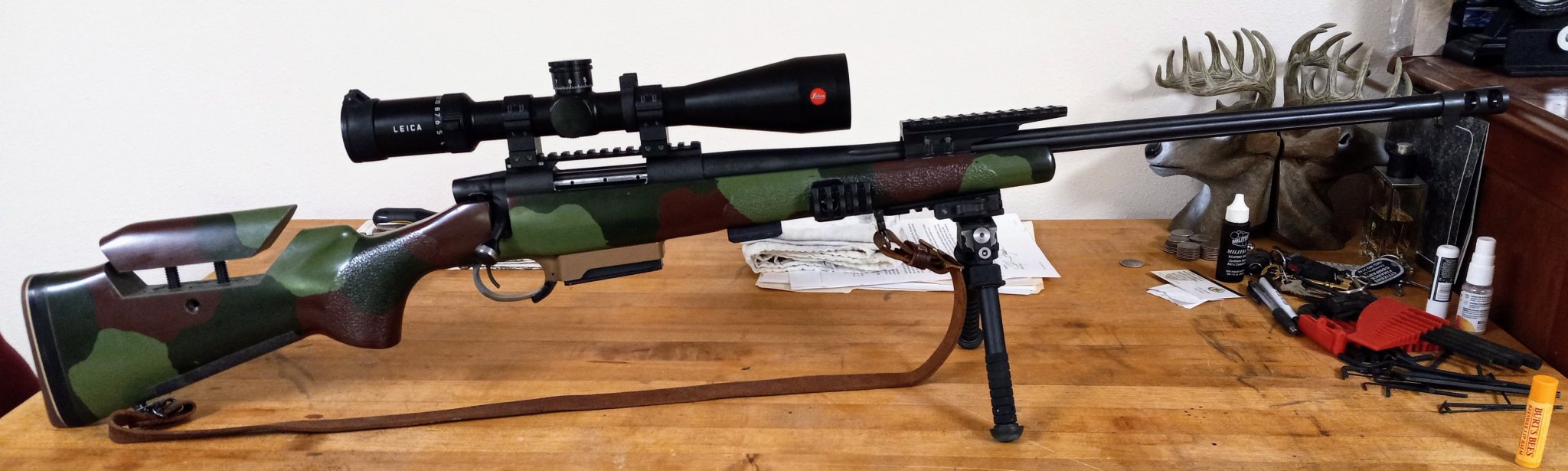

Weatherby Vanguard 6.5CM, Mcmillan stock, PTG bottom metal.

That McMillan is so sexy!! Good stuff

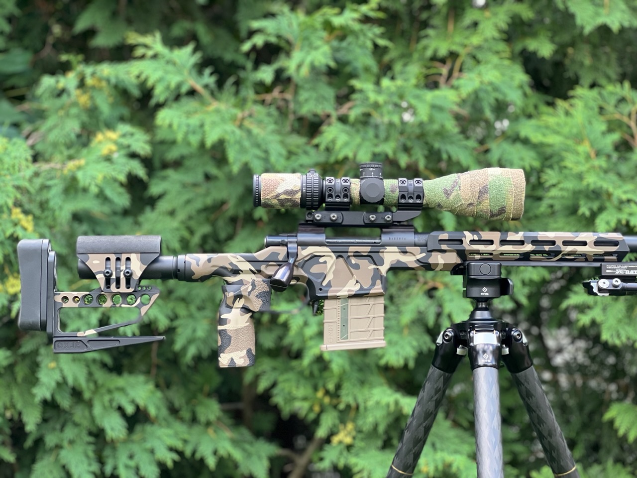

This is one of my 6.5 Creedmoor Howa HCRs. I used it for matches a couple years ago, and then turned it into a hunting rifle. Timney trigger, HRD Arca rail, XLR buttstock. It’s extremely accurate, and I have shot it out to 1100yds.
This is a 6mm Creedmoor Howa (Brownells barreled action) in a MDT ACC chassis. Also extremely accurate, this was shot last year at the Accuracy Indiana match out to a mile. Nothing wrong with a Howa, IMHO, go shoot yours a bunch. When it starts to limit you then upgrade it.

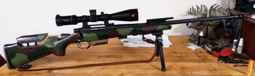

Here's a 1500 in a grs stock. Ptg bottom metal to accept aics mags, Timney trigger, threaded bolt handle by lri, wiebad stock pad, area 419 goodies sprinkled about. Great shooter. The atlas bipod has treated me well. Definitely go arca setup!

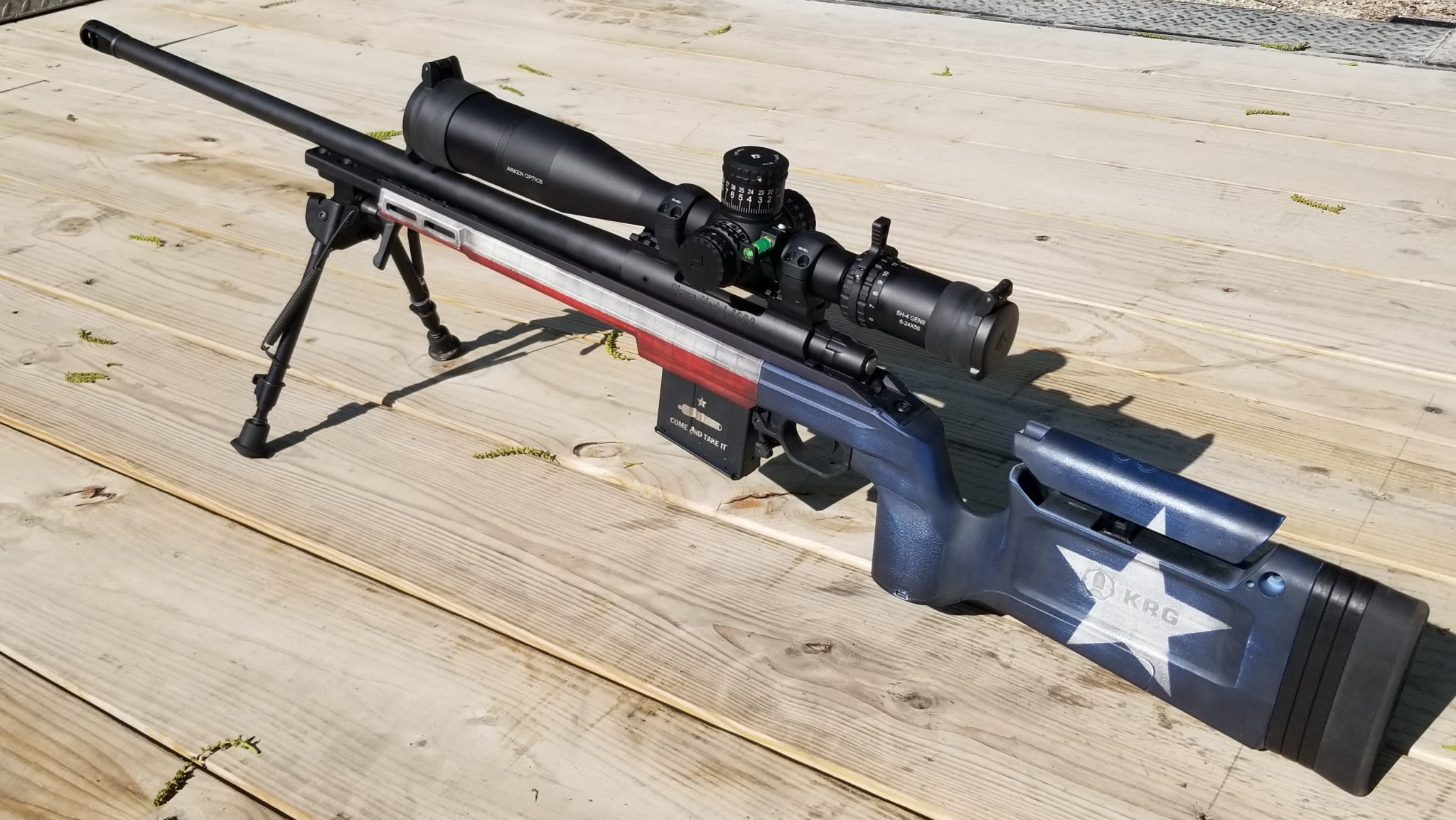

I too am a novice as you say to the world of precision rifles although I've had guns for quite some time my self.
I'm learning from others and their advice to you on your howa along with other howa1500 threads but I want to say I'm another +1 for a krg bravo stock when it comes time to upgrade.

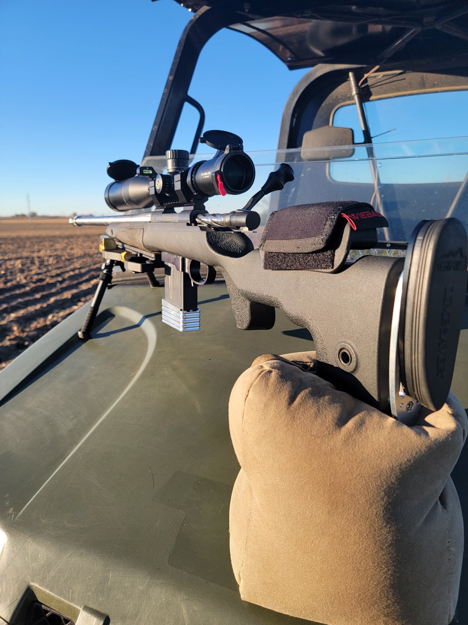

A friend gave me this rifle he nicknamed Tex
Which came with all the krg upgrades from legacy
I've only done the "factory break-in " and about another 100rds down the barrel that I've hand loaded . I'm still in the 1 moa range of accuracy my self. Definitely going to do the trigger spring mods others have suggested to you on my rifle. As to me the trigger seems a bit heavy (3-4 lbs?)

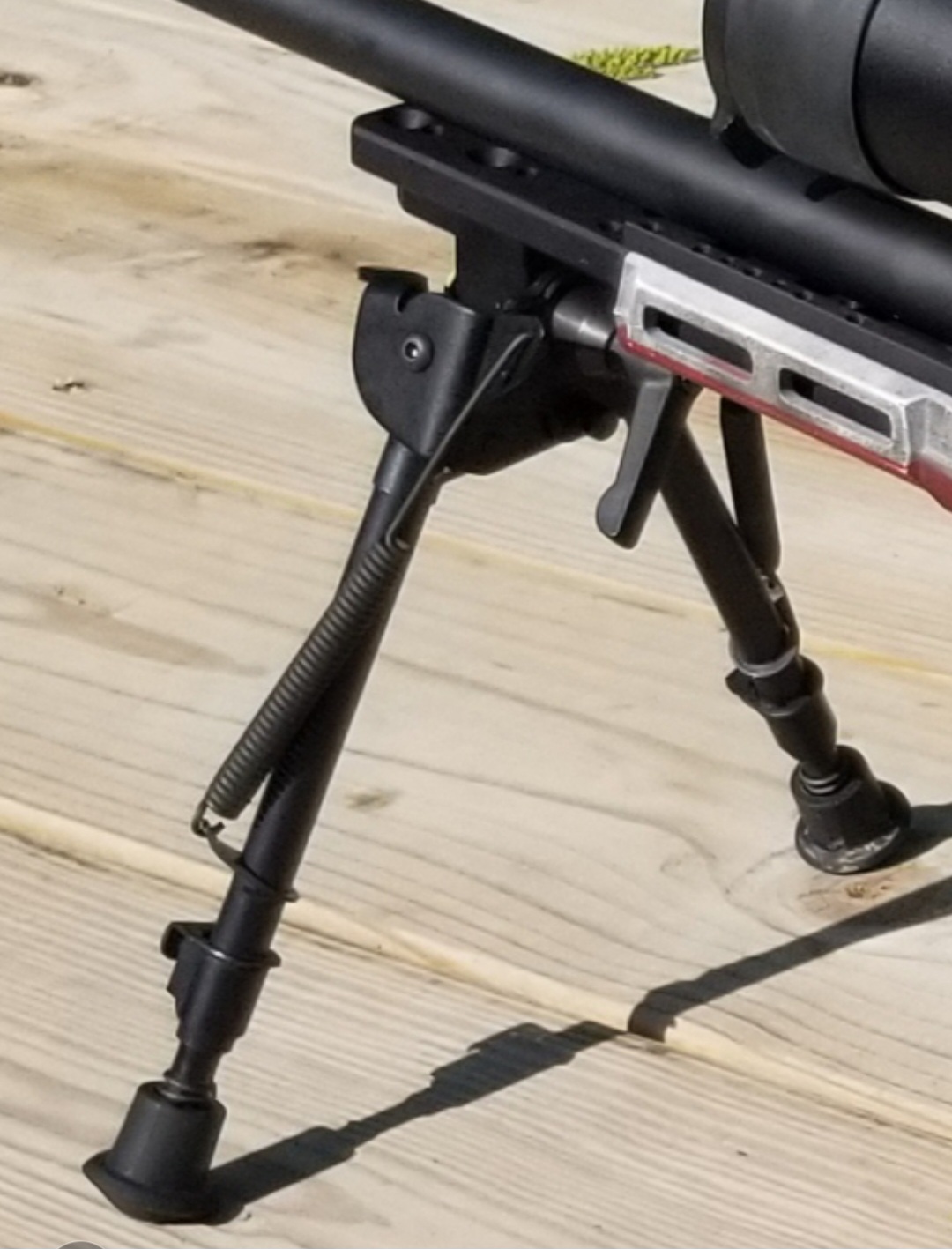

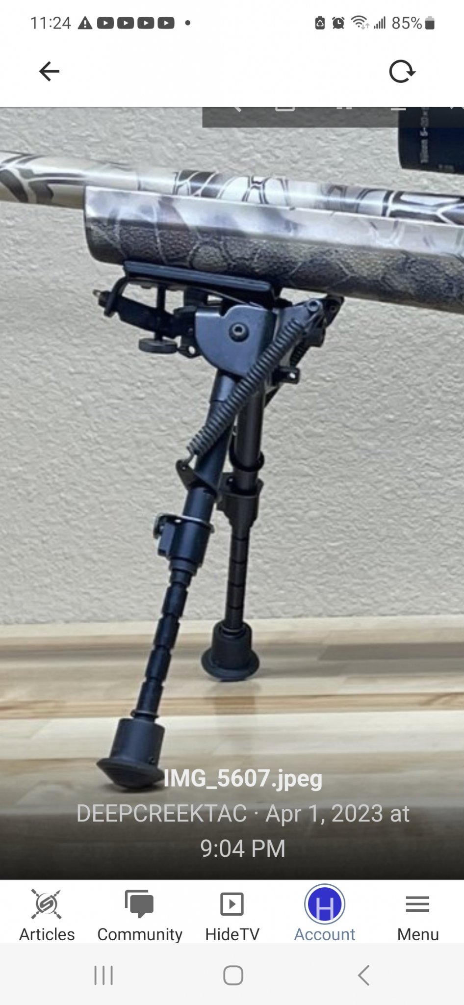

I noted you said you were going to replace your bi-pod because you didn't like the cant feature.
It appears we have the same Harris S series of bi-pod.
I upgraded mine years ago with a locking leaver to easily increase or decrease the tension allowing cant might be a option for you as well. Sorry can't recall the brand of the product though.
If mine looks strange it's been also installed on a krg pic mount which mounts the bi-pod farther forward and closer to the barrel
